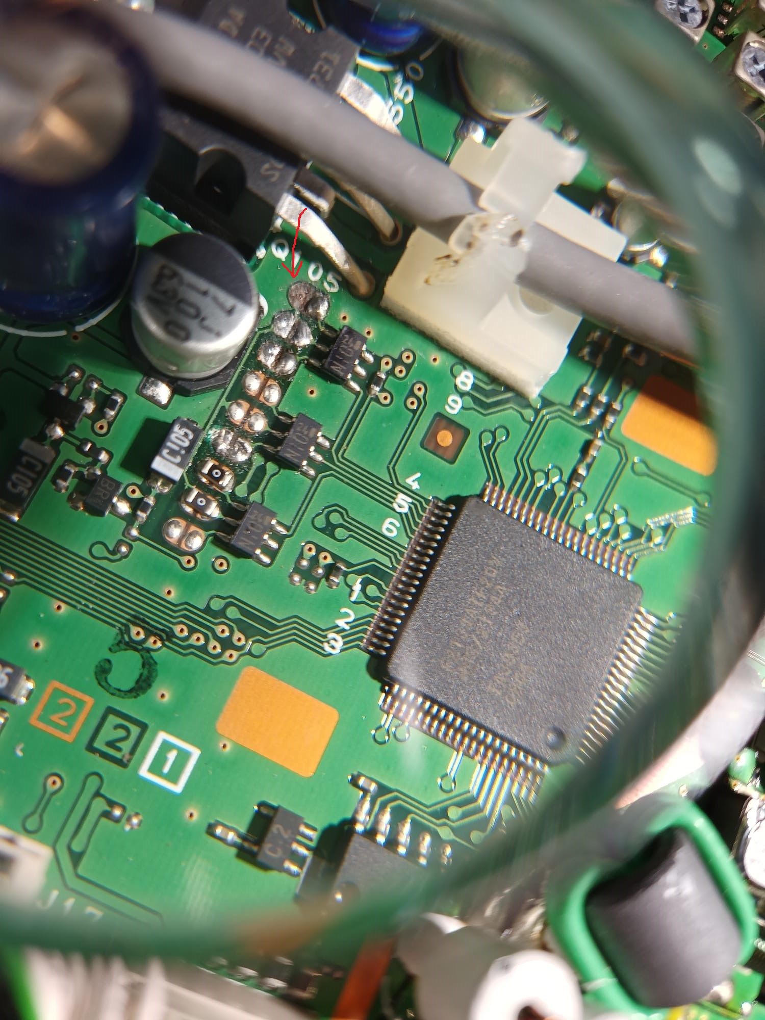

Before and after pictures for the USA 857 897 D frequency conversion.
MODIFY AT YOUR OWN RISK!
Solder jumper 7 8 9 and 6, then reset the radio by holding the F and VM keys down while turning the radio back on

The previous owner of my 897D had MARS mod on and decided to remove it before selling it to me. I believe he damaged the JP1007 irreversibly .
I'd like to show you the attached picture.
The soldering pod of the left side of the jumper looks completely missing, and I am not sure if soldering on top of that will work to restore the mod.
I wanted to know what your take on this is....
any help is much appreciated!!

Thanks, I took the before picture and Moleculo took the after.
