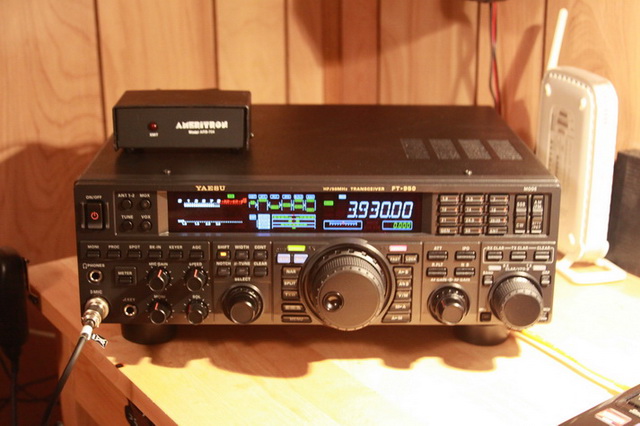

The first 24 hrs on the new rig.
The first thing I did was to dig out all the cables I have to see what was going to work and what I would need to pick up.
1. Amp hook up. I use a ARB-704 Buffer Relay to key up the Amp, I was lucky enough that the cable for my FT-857D works with the FT-950 no problem. You must connect it to the Tune plug on the back of the radio. I dont have a CW Key so I tune it up using the RTTY and it works just fine.
