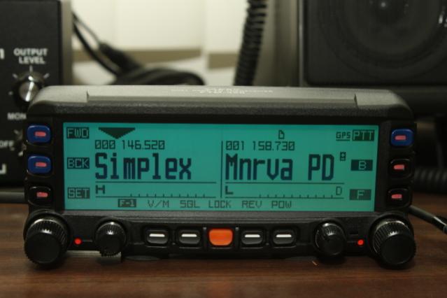

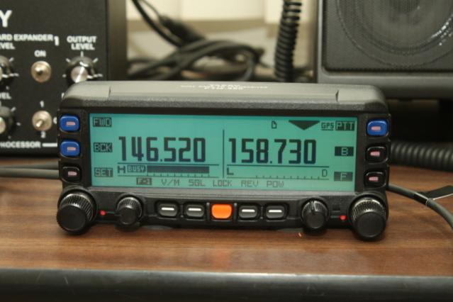

Here is a picture of the basic, standard dual VFO screen:
In this screen you can see that I'm monitoring a simplex 2 meter frequency while also monitoring my local police department. The right side VFO could just as easily be VHF, UHF, 800Mhz, or Air band. The left side also covers AM broadcast, FM broadcast, and Line-In port.
The big arrow over the top of the right band in this picture designates the "Main Band". The side without the arrow is the "Sub Band". You can change which side you want to be "Main" by just pushing in the big dial on either side of the control head.
the FWD and BCK buttons on the top left cycle through the various other screens, the timer, GPS, Barometer, and other screens. The F button changes the function buttons at the bottom; if you hold it down for a few seconds, it gives you all of the CTCSS, DCS, Pager, and other similar functions.

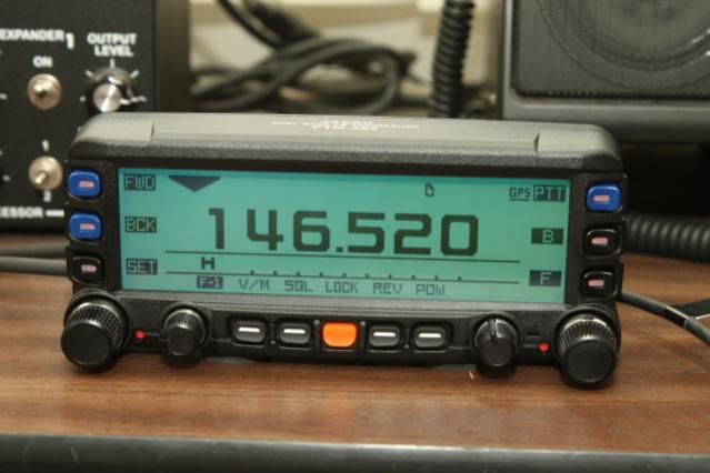

If you hold down the FWD button on the top left, it changes the Main band into Single RX mode like this:
In this example, I switched the left side VFO to main band first and then held the FWD button to make the simplex frequency the only one in play.

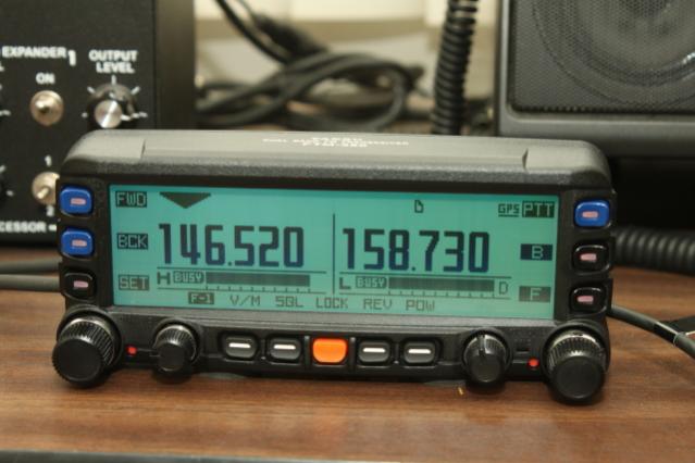

Notice both S-Meters cracked full scale on this pic:

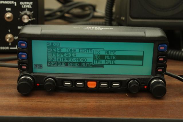

The radio can receive and produce audio output for both VFO's at the same time. You can also change this behavior via the set screen. Here is the Set screen with some of the options so you can see how this works:
Remember, the SUB BAND is whichever one the giant arrow is not over. You can make the SUB BAND mute when you TX on the main band, or when the main band receives a signal, or both. If you turn the Sub BAND MUTE to OFF, it always puts out audio from both receivers.
The left side can listen to AM and FM broadcast by just hitting the B button while the left is selected as the MAIN VFO. However, there are times you when you might just want to listen to broadcast radio or the line-in, but have the rig mute this audio when a signal is detected on a ham or other frequency. To accomplish this, press the F button on the lower right until menu F-2 is shown. On the right side, select the AD-F button, which activates the Dual Audio function. You can now listen to broadcast AM/FM or Line-In while monitoring another frequency. Here is a pic of this in action:
Note that the words "AF DUAL" appear at the top. If a signal is received or you wish to TX on the right side receiver, it automatically mutes the left side. This is different than if you just kept hitting the B button to change the left side to the broadcast FM.

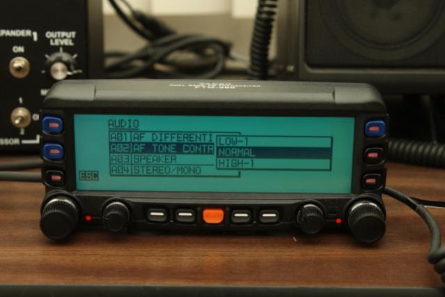

Here are a couple more Audio Setup Options. First is the AF Tone Control settings:

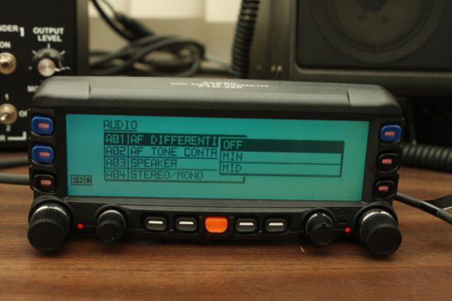

Next is the AF Differential:
This kind of like an auto volume control. Each incremental setting above "Off" sets the base volume a little higher. I haven't had a chance to test this real thoroughly, but it seems to take into consideration the RX signal strength. More on this function will follow after some additional tests.

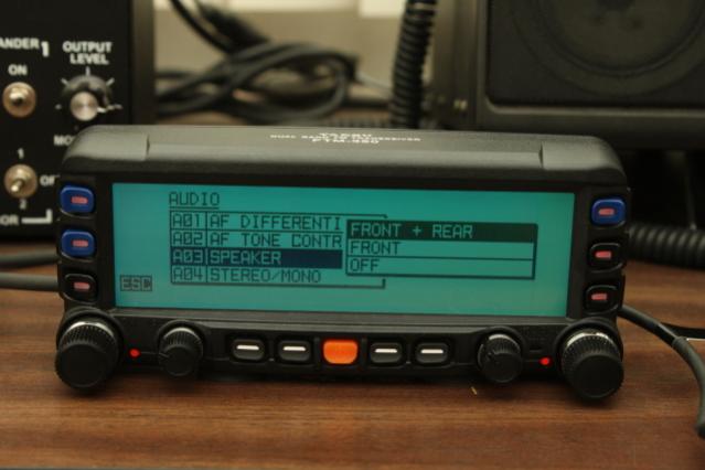

Lastly, here is how you control where the audio is output:
You can output the AF to the main radio chassis speaker, the two stereo speakers on the control head, both the control head and chassis, or OFF which kills the audio completely. Incidentally, the chassis or BACK setting also controls the speaker out port on the back of the radio.
