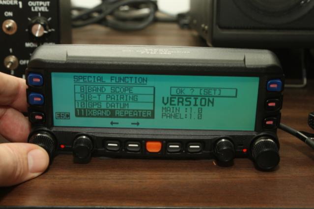

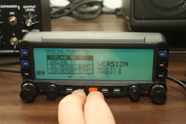

After you select your frequencies and tones, turn the radio off, then turn it on by holding down both the power button and the button just to the left at the same time. When you do, it will come up with this "Special Function" menu:
Use the left main knob to scroll down to menu 11 - XBAND REPEATER. When you do, it will flash a confirmation up in the right corner, shown here:

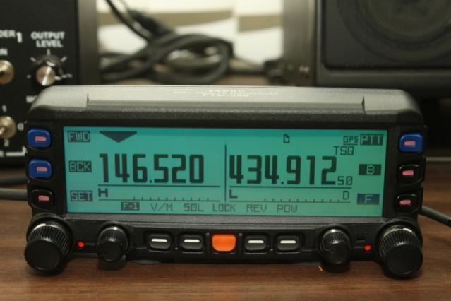

If you confirm by pushing in the left main knob, the radio will recycle the power and turn back on in crossband repeat mode. Here's the resulting screen shown receiving a signal on the right side and repeating it on the left side:
