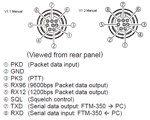

FTM350 Pinout correction
If you are making you own cable, make sure you have the APRS manual v1.2 as the version 1.1 of this manual has some of the pins mislabeled.
Those of you who are experienced with mini-dins probably noticed and ignored the bad info. The rest of us will struggle and not understand why our data cable doesn't work.
The APRS manual version 1.2 issed last week is corrected. The attached file shows the correction.
But really, the radio has enough memories and functions that you should get the ADMS/RT systems programming software and USB data cable -- so easy, so nice knowing that I have a backup of all the programming. This cable will work for applying the the firmware update.
