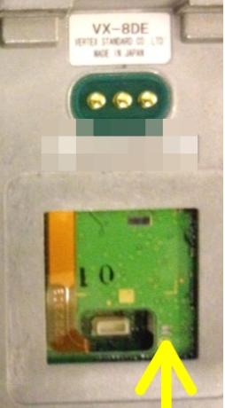

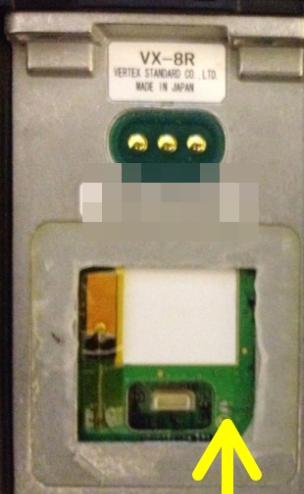

VX-8R & VX-8DE Mod
hello everyone,
i know this is an old topic but thought id share my experience
so i own a VX-8R (from U.S) and a VX-8DE (purchased from the U.K) last night i decided to go ahead and do the Mars-Cap mod when i read on the forum here that there was a software mod too.
1) i can Confirm that the hardware mod works just fine with VX-8R. However, software mod does NOT work with the VX-8R both before and after hardware mod.
2) The VX-8DE hardware mod works fine, you can only do the the software mod for the VX-8DE after you do the hardware mode, otherwise you will just get a screen with "C2" and you wont be able to select " *** " .
here's a couple of pics i took
Cheers and good luck

hello everyone,
I had a VX-8DE delivered today and done exactly the same mod and can confirm what you have said exactly on the E units.
Out of interest, since doing the mod I cannot turn RPT ARS on which means I will have to manually programme repeater shifts. I guess this is something to do with the unit becoming non-locale specific (following hardware/software mod).
Can you confirm if you have the same thing going on?
