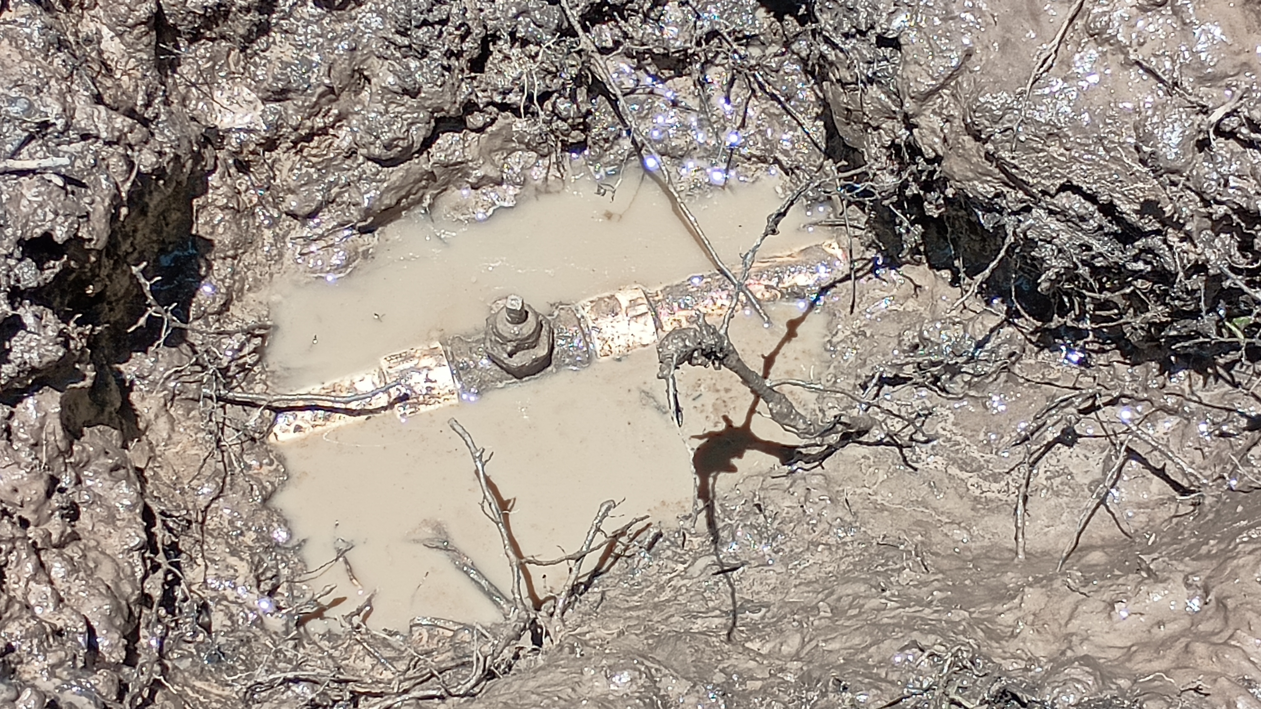

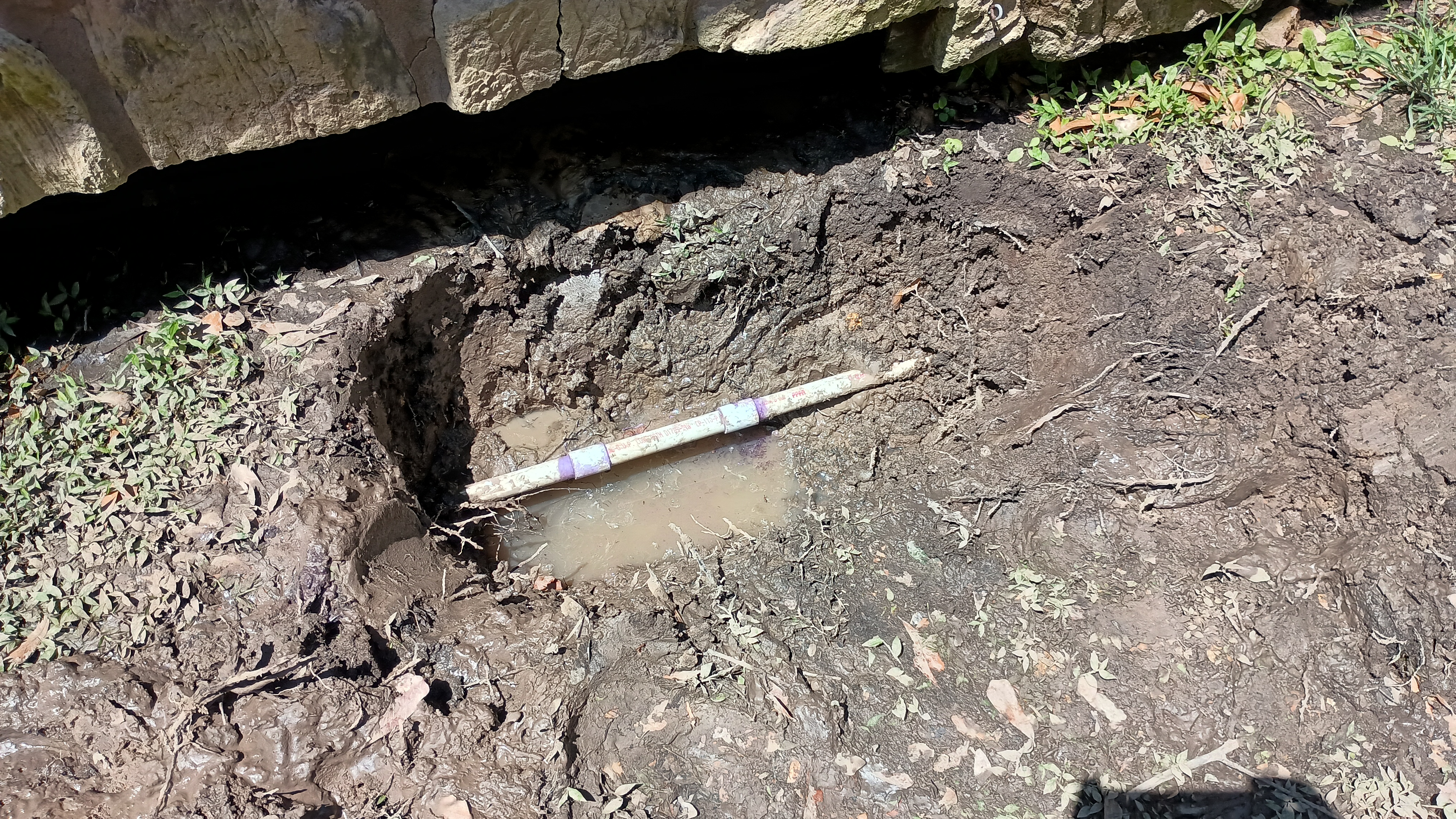

Had water in the yard starting about three weeks ago
We had had some heavy rain so I kinda blew it off
Finally decided to take a look
What the heck
The female adapter on the left side was split/cracked
Smdh
Not sure where you are at, but did you check the freeze line depth for your area? I know here in Tennessee it's like >16", I'm guessing you're farther south because that looks like less than a foot. Just curious.
Yes sir thanks I am by Beaumont Texas east of Houston headed towards Lake Charles
We do have our share of freezes occasionally
Yes sir idk why that was down there it was covered with grass and no indication on the surface. Perhaps it was marked at one time I bought the house in 2002
I didn't realize it got that cold in TN...By the way, having lived in the Mojave desert for 58 years, what;s a freeze line... lol :cool:
  • Haha
Reactions: Cable Guy

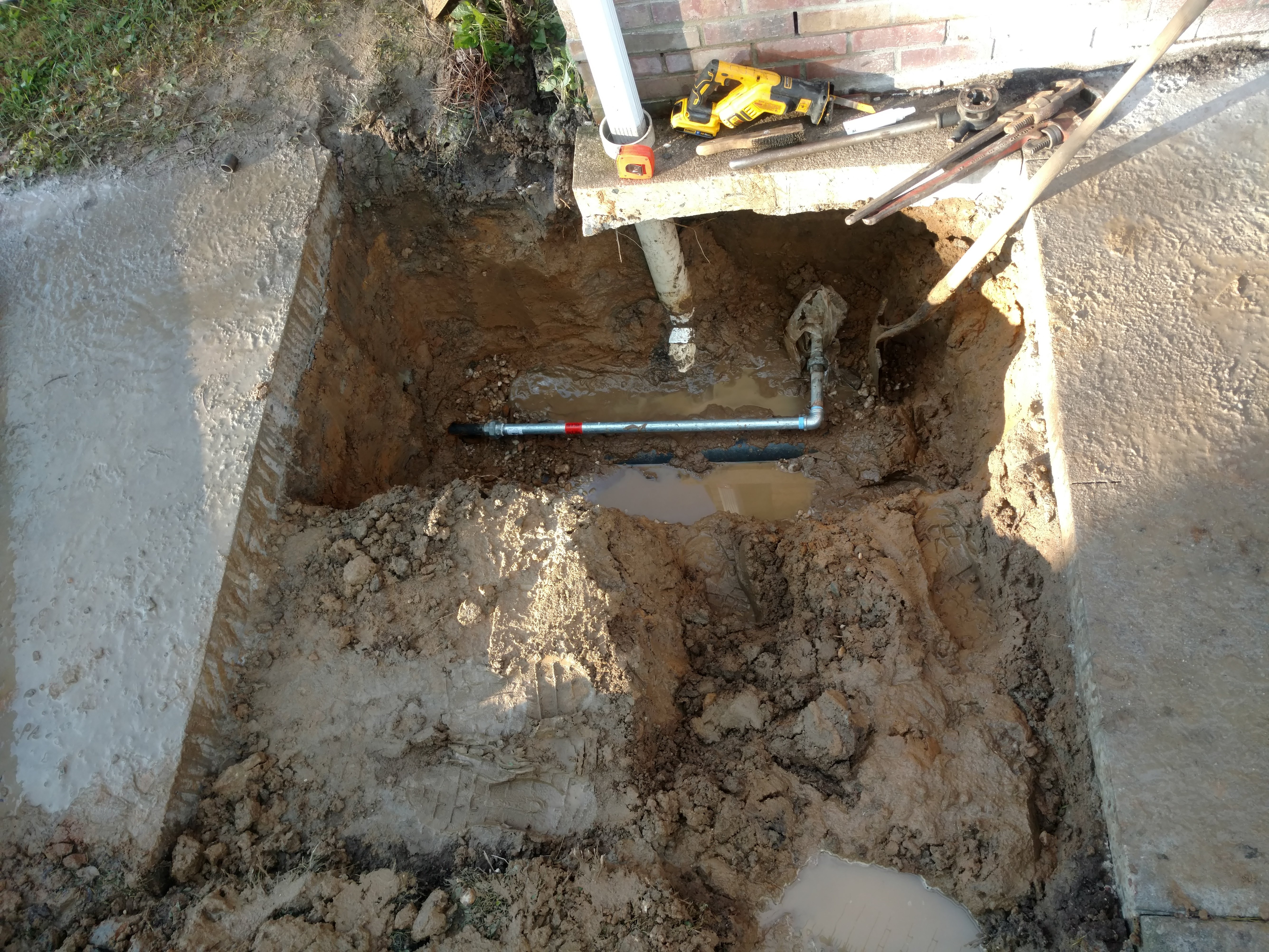

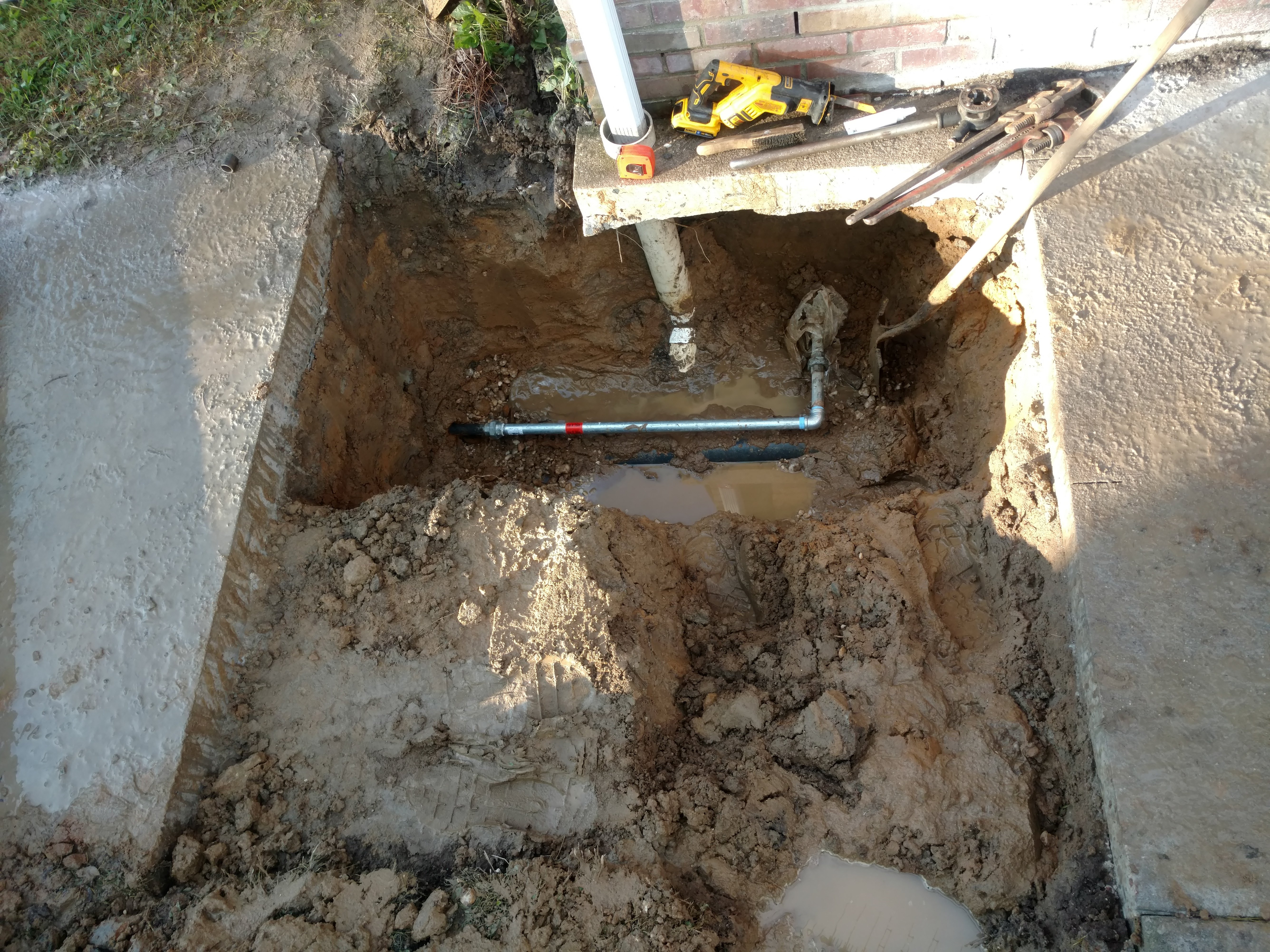

Surprises like this always happen at the wrong time, it seems. This reminds me of some fun we had a while back.

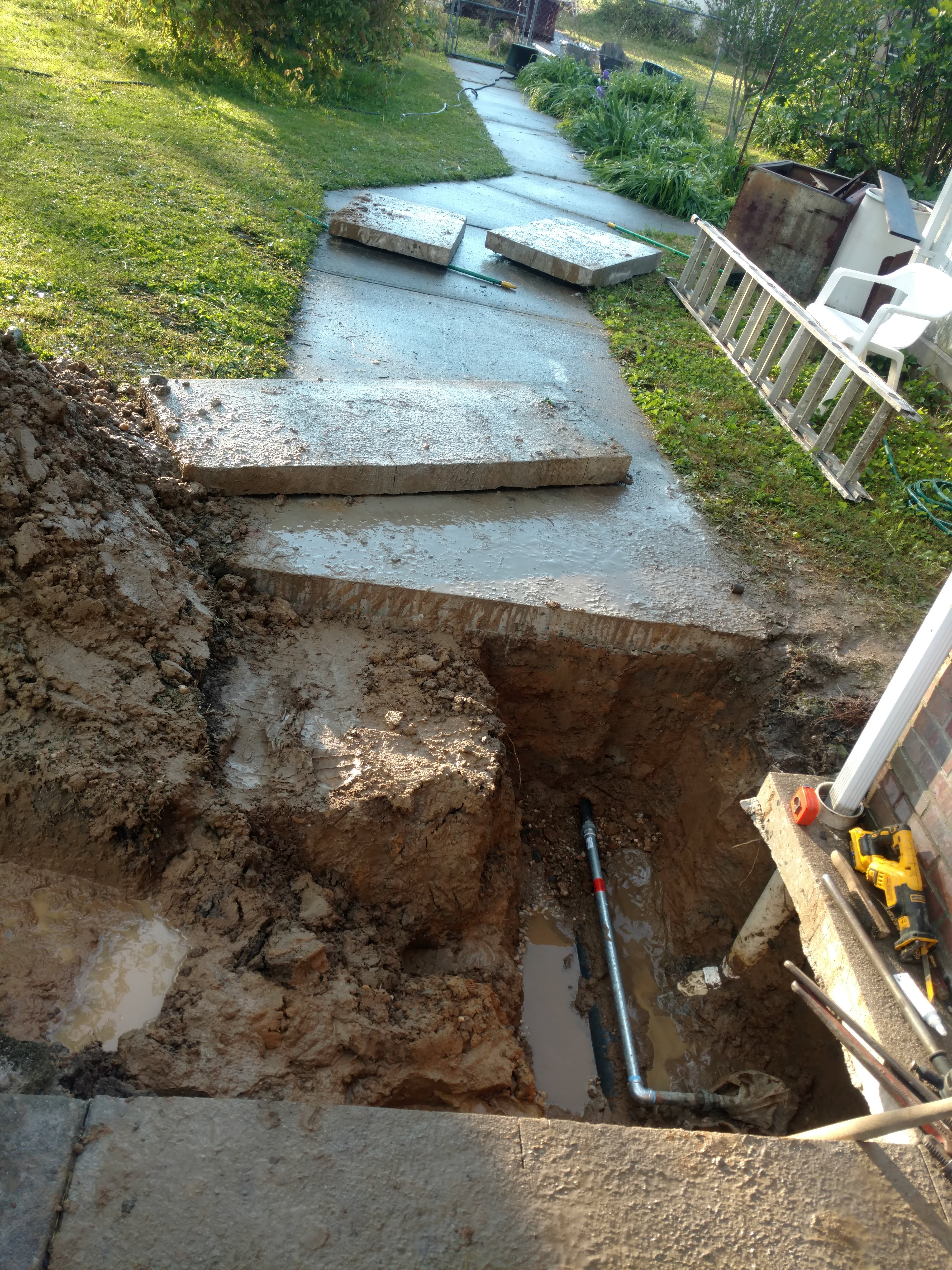

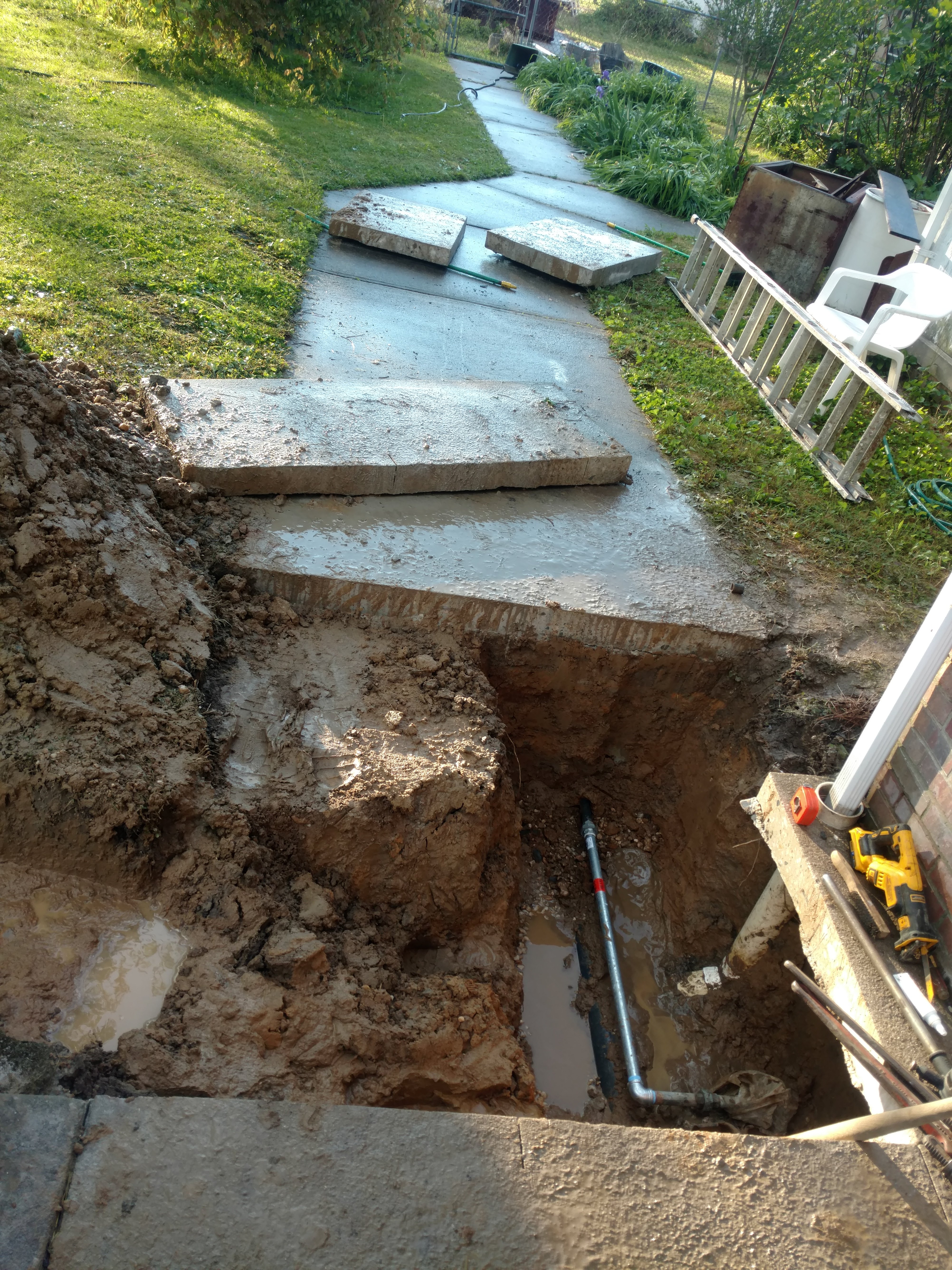

We had this situation a couple of years ago at my mother in laws house here in Delaware. We could hear running water, and could see water coming through the wall in the crawl space. The water comes from a pump house from her property around the corner and across the street, so it just happened to be under the sidewalk in the back of the house.
We dug down four feet deep to find a short section of pipe that was not galvanized. Note to self, black iron will only last 50 years...
Reactions: doffo and gcook
View attachment 77349View attachment 77350
And that little section not being galvanized caused you to have to rip up the sidewalk to make it a little more fun.
  • Haha
Reactions: Shadetree Mechanic
Ugh..... Thanks for the tip. It wont be long before ours decides to give up. Noticed some black iron piping underneath this place...
Man I had a cakewalk compared to that job WOW
Those are some nice clean cuts on that concrete (y)
We had to rent a gas powered concrete saw and was able to cut and move the slabs in half a day. Once the cuts were made, we were able to lever the slabs up enough to get a chain under them. Then drug them out of the way with the golf cart.
