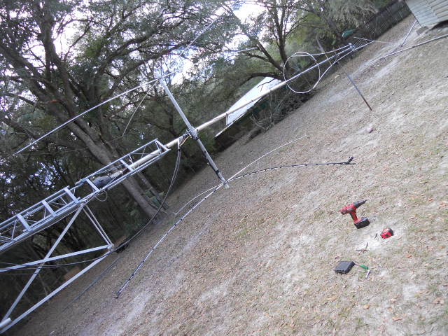

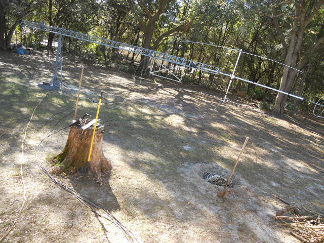

the dual polarity is running and working great to be honest :) listening to locals 50-400 miles away this am and talkied to england/uk and everyone booming in right now..talked on flat side half hr last night and while talkin on "46lsb where i hang out with bluesky members" the swr while talking never got over 1.7 or so on flat side..
well,im on the radio noiw,,blue sky 106 south of ocala fl 34432 zip..im aimed 30 degrees nort east right now :) and switching back and forth on the astroplane..i can hear the world as usuall lol..

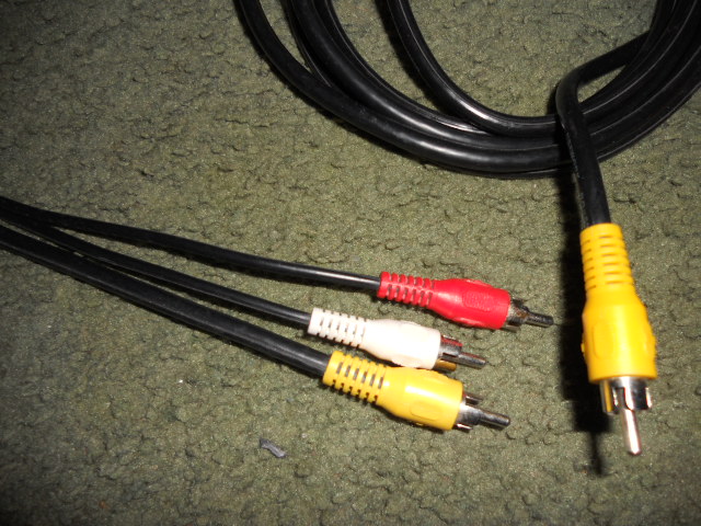

when i look up this "a/v" cable it is just a regular audio video cable it seems,,,with rca plug ends..is this correct? i think its all rg59 with red blueyellow red ends..i have a bunch of this,prob even the right length...i have to check.
is this sounding right? and a 6ft piece with 6 wraps around 4 inch pvc,tape to pvc to keep its shape,then put it hooked to the very end of my 75 ohm matching stub and other end to the driven element wire? bs106,john
ok,i found tons of a/v coax .yellow,red,and white colored,,goes from dvd player to tv for example...the yelolow says on it rg59u dish network :-)
the red and white are very small and thin cables..
if this is correct do i need 2 of the yellow rg59u cables,,1 on each transformer,,,or 2 of the smaller ones"red and white"colored ones??there like 1/8 inch thick aprox??

ok,heres a few pics of the cable and other stuff

Here's an idea. Look at the type of cable printed on the outer sheath and Google it. That will get you the Vf.
Also WTF is with the A/V cables for this? That yellow cable is a really crappy cheap piece of 75 ohm cable and the red and white cables are simply shielded audio wires and not coaxial cable. Don't use them for anything and get some REAL decent RG-11 or even RG-59 cable or some decent quality RG-6 even. That yellow video cable is RG-6 but of about the lowest quality there is.

that yellow cable i thought was crappy also till i cut into it and its real soild copper not coated like tv crap with the threaded end that has the f type connector to my knowledge..it is dish network crap tho..but im just learning this stuff reading..

GOING TO TILT THE TOWER OVER NOW,,,WILL CHECK BACK HERE IN COUPLE HRS BEFORE STANDING IT BACK UP....
