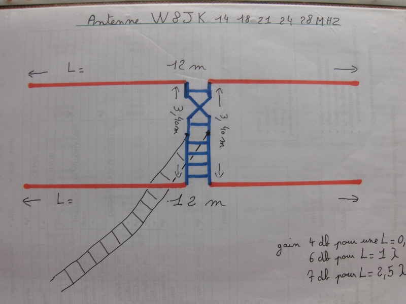

The Doublet Antenna:
I have 2 "Phased" Doublets I am using presently. These antennas are 62.5 ft. long on both sides of the center. These are fed with 300-ohm KW+ twin lead.
My version works well at this length for 80/40/20/17 meters @ about 45 ft to center insulators.
I have fed them with 450 line, and they worked fine. I have found this 300 ohm line from DXE to be less susceptible to moisture than the 450. The 450 line will be fine if you already have it.
I used two of these kits to make my antenna.
https://www.dxengineering.com/parts/dxe-wa-135
However a single works very well, for an ALL band choice.
http://www.hamuniverse.com/hfdoublet.html

I assume when you say “phased” you have one running north south, and the other running east west?
