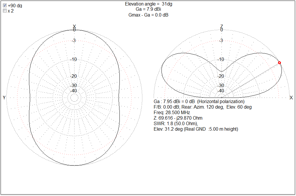

Anyone have a list of plots for 10m at various heights? Was wanting to see the different graphs from the low to high heights. Thanks
Any particular heights?
I mean yeah sorta. I was wanting to see the various charts at say 5,10,15,20,25. Just wanting to see the pattern changes as it rises above the ground. What I’m long for is how the horz dipole preforms as an Omni at low heights and the gain directions.

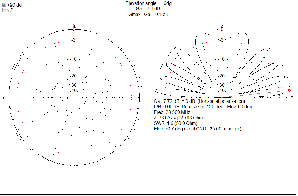

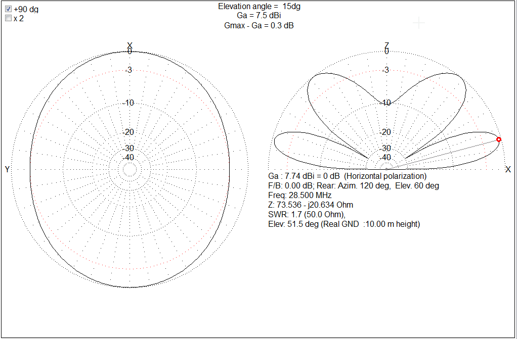

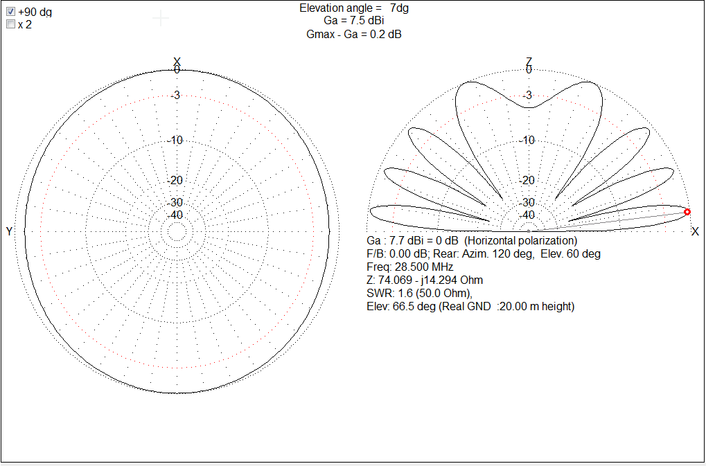

Done.
Thanks man. I’d been wondering the take off on a low dipole and polarization field. So if you ran a low horz dipole It’d be Omni and almost looks vertical on the chart? Am I seeing that right?
My bad. I did it over perfect ground. I will redo them later over real ground.

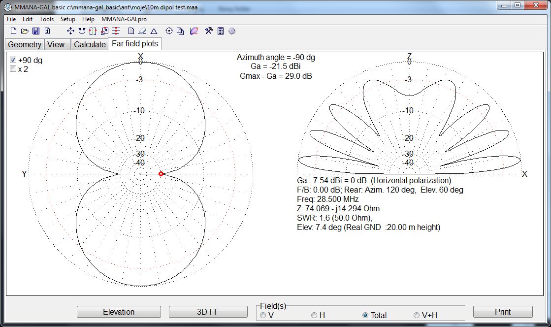

20m height over real ground is like that. Dipole is on Y axis
