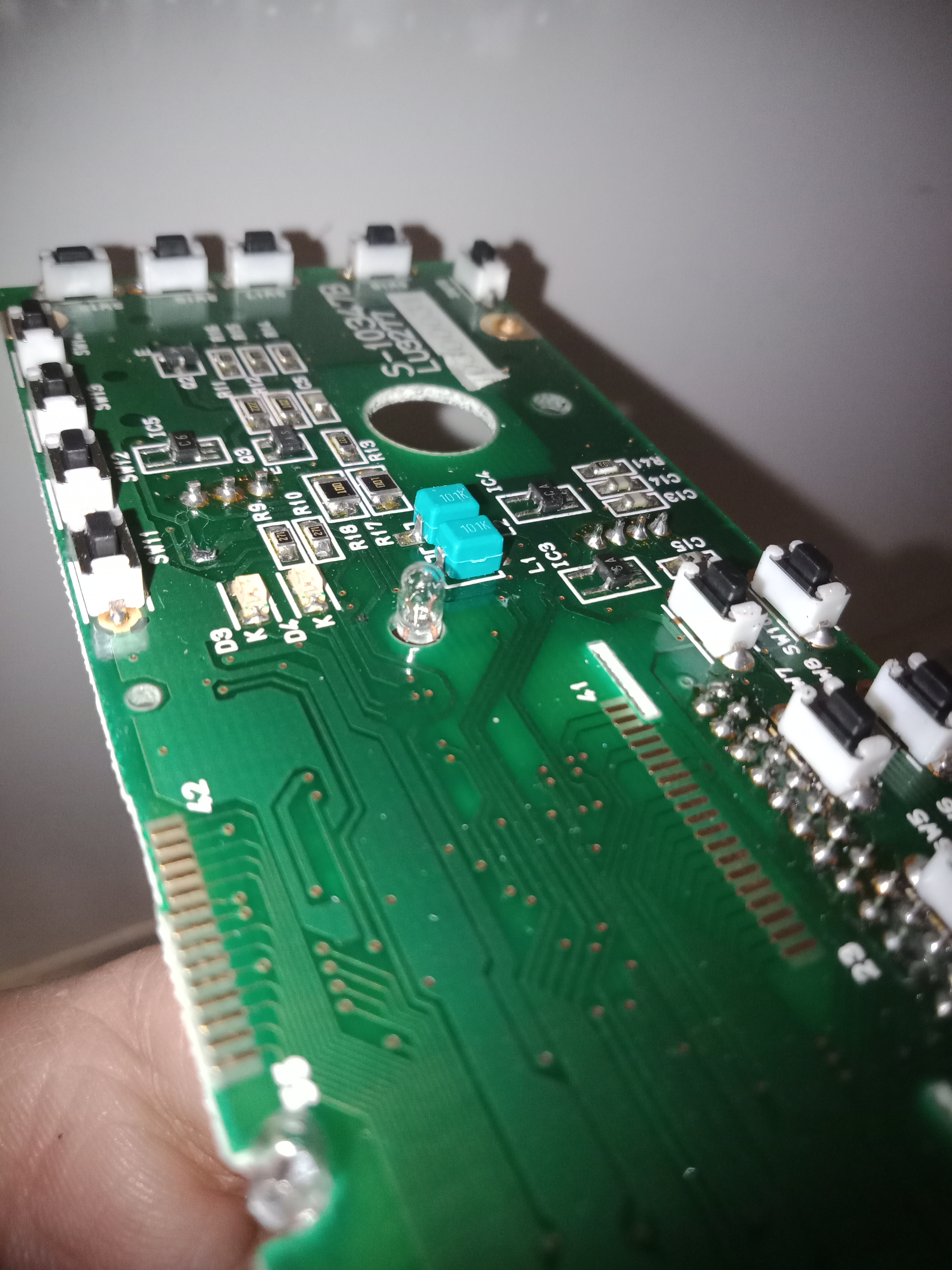

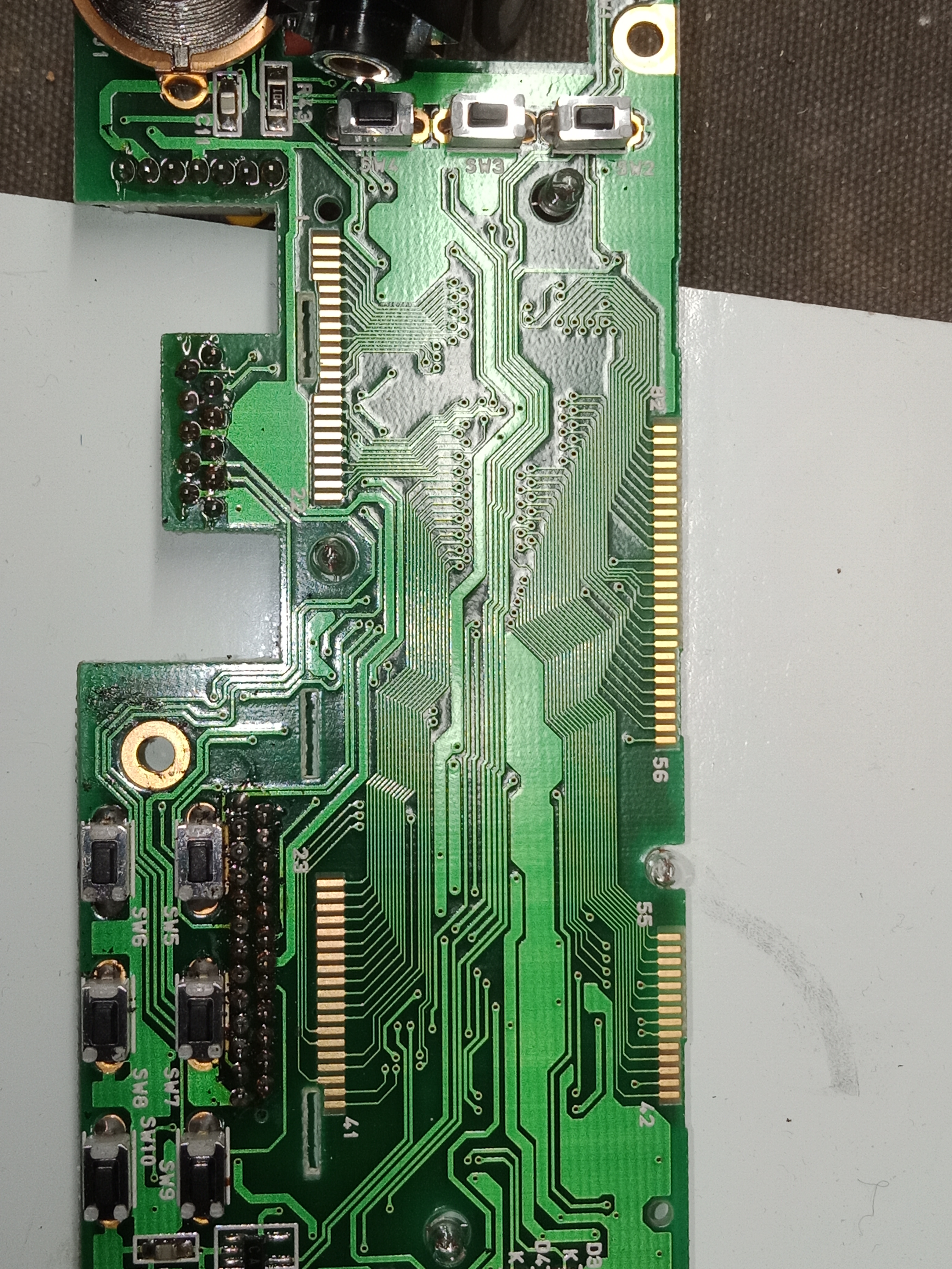

I opened up the TS 50 to examine the no display problem I have and discovered none of the errors you pointed out thankfully however after carefully removing the LCD display I looked closely at PL1,PL2,PL3,PL4 light bulbs and saw that PL1,PL2 & PL3 filaments were all broken and needed replacement. See images below Its unlikely I would get those same replacement bulbs so what would you recommend as an alternative option?
I was advised by one amateur tech to fit white or yellow LED's but I will need to bypass the dimmer circuit for the LED's to work:
This is what he said:
[remove the globes and the two resistors and wire in the led's with a 1k resistor on each going to a 12v rail the ground connected to the ground side of the globes old position]
Unfortunately he could not recall where on the circuit board he connected for a "12v rail" source and advised I work it out myself. So my question to you sir is if you have any idea where on the board I may use for this 12V source. I dont have a separate 12v supply on my work bench to do a trial and error and only have the main 13.8v rigs supply on the radio desk 2m away. This is something I will have to rectify soon. Await your response. Mike
