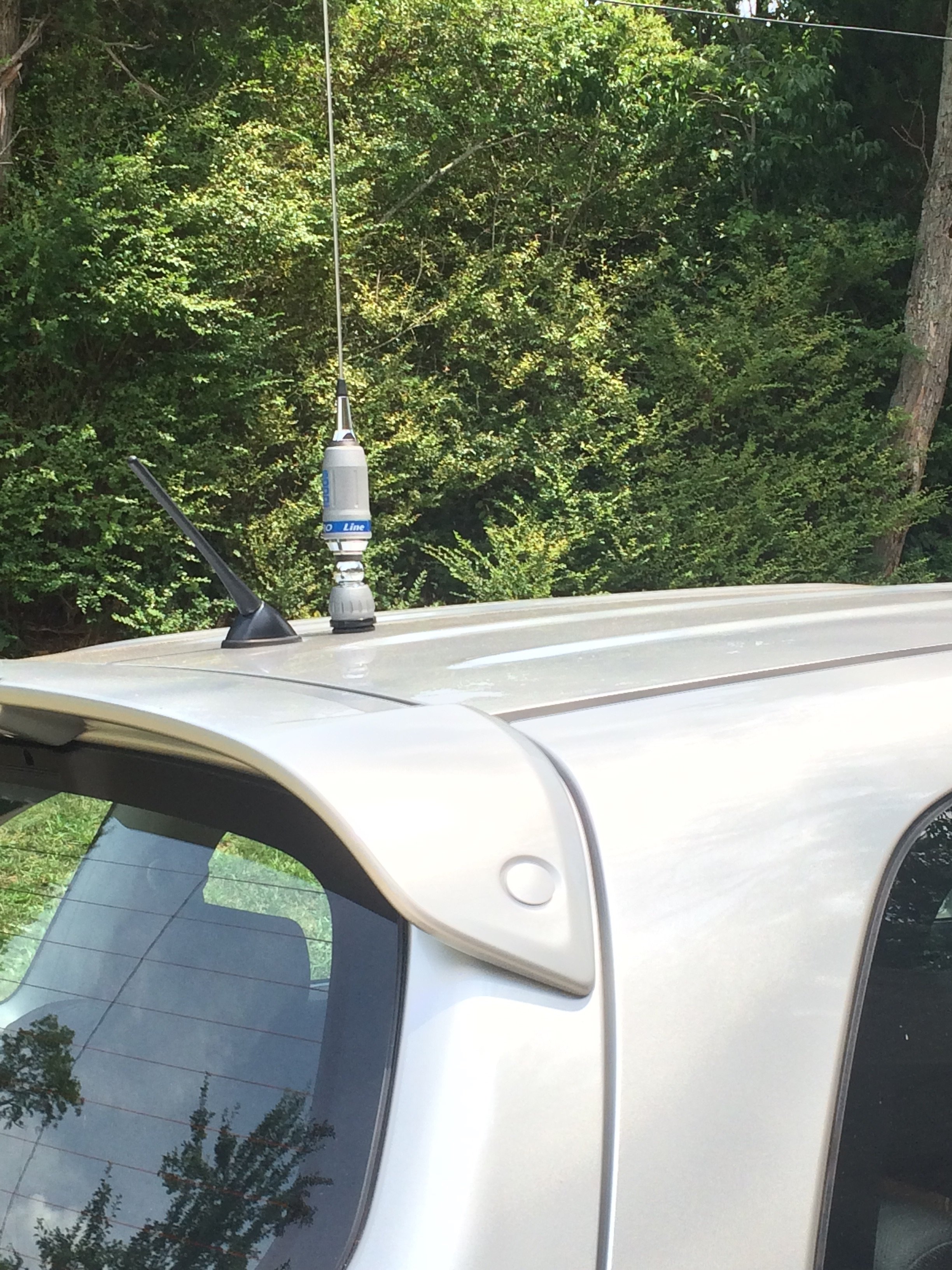

My sirio is centered toward the rear and I was wanting to center the 2 meter but I could put the 2 meter on the left or right side of the vehicle which would put more distance between the two. Would that work? It would create a lot more distance. How efficient would it be on one side of the vehicle as to the center?

OK,
May I suggest that you look at a mount that would bolt to the fender and raise up between the hood and fender, like those for full size pick ups.
I'll look into that mount. I've seen a few mounted that way next to trunks and hoods. I don't want to do anything in rush judgement but if possible I really like hard mounting but I'll do the fender type mount if the roof option won't work. My car is hatchback so I'm limited on mounting ideas and I don't like mag mounts. Fender option not a bad idea though.
I never did like the glass mount idea for anything except cell phones. that's just my own personal opinion. I hate those things with a passion for two way radio.
6 inch is way to close and will cause problems .Go for a guard mount as bin rat suggested . They come in all different shapes and bends so you should be able to find one that fits . If you really want to drill a hole in your roof . Try middle of the front of the cab.You can access through the interior dome light and should be able to route the cable without removing the head lining .A little s/s 1/4 wave would work well there , or a 5/8th if your really keen:D. On the guard I would use a 1/2 wave to get the extra height above the roof .I found the CD 28 41 70 series from RFI work well ( dont know if you have them in the states)PS make sure you seal with sicaflex or neutral cure silastic ( do not use acetic cure silastic )
