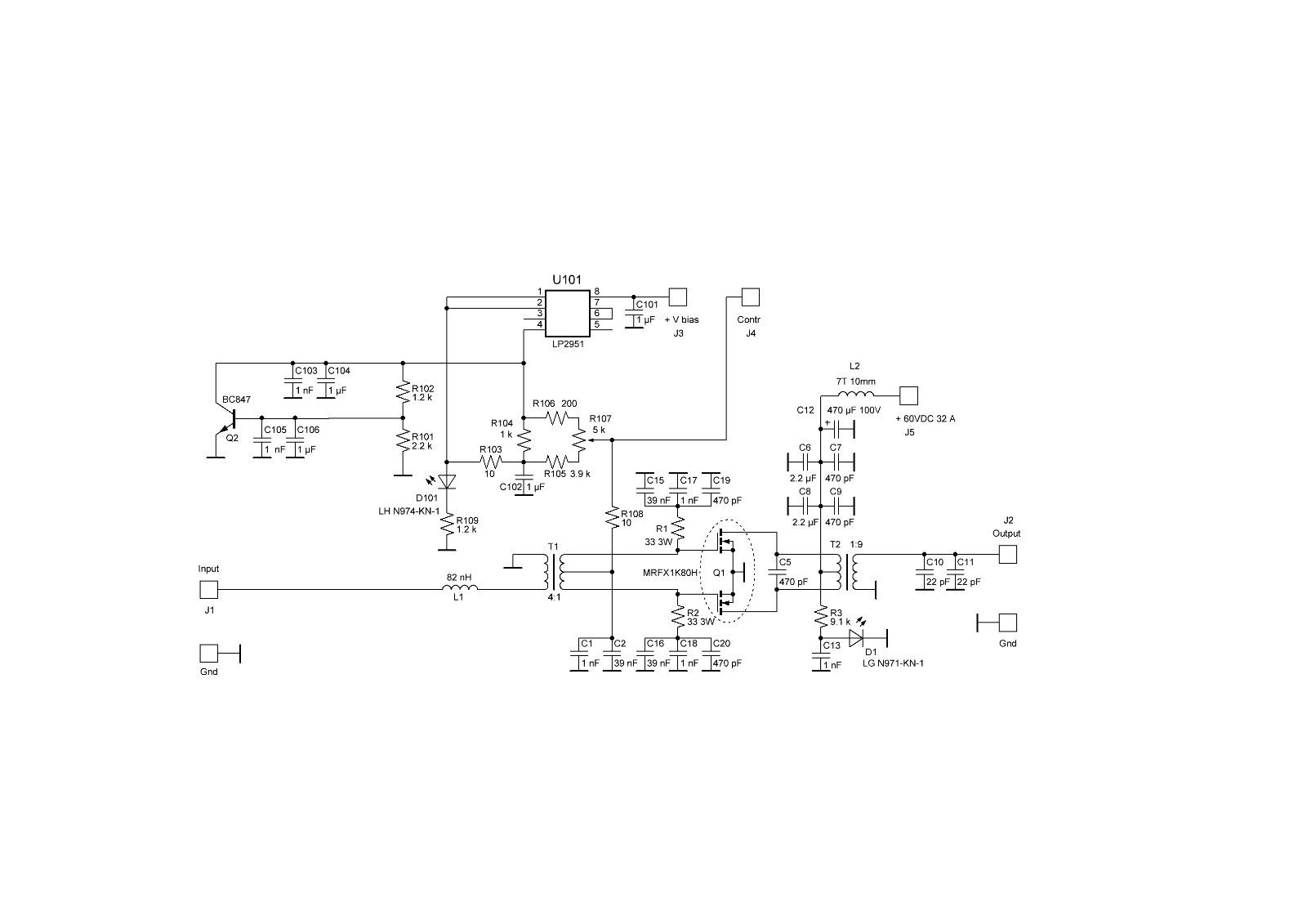

MRFX1K80H
https://www.ebay.com/itm/174819992492
https://www.ebay.com/itm/313493736321
