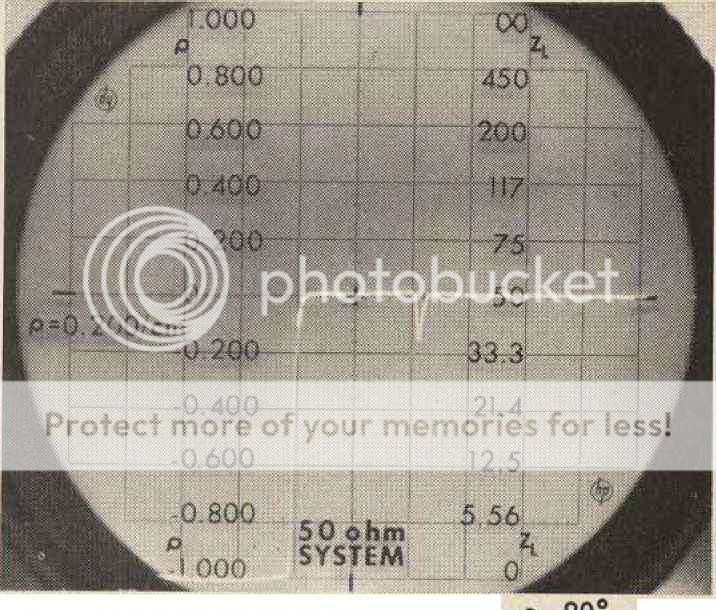

36.2 ohm PL259
So instead of going out and purchasing a 50 ohm dummy load I suppose we could build our own 45 ohm dummy load for our test bench and accomplish the same results tuning a radio?
This makes it obvious that you have no idea what the difference is between an impedance bump and a terminating impedance.
That impedance bump looks kind of nasty on a time domain reflectometer..

Conclusions
The strengths of a quality made UHF connector are the large center pin which can handle significant power and the relative inexpensive cost. The down side of an incorrect impedance are either not worth worrying about or are easy to compensate for at frequencies less than 500MHz.

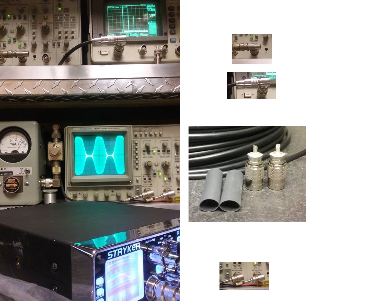

Copied directly from the link you posted RabbiPorckChop, if it's not worth worrying about then why start this thread? Are you implying that my antenna setup is seriously flawed and should be reconfigured without the use of UHF connectors?
I also use a non-finetuned coaxial jumper cable for my standing wave ratio meter, I better get rid of all these UHF connectors & fast!!
Trust me when I say there is no conspiracy to make every radio tune-up bench incorrect other than your techs... Oh wait a minute maybe he is the only one who ever thought of such things?? :sleep:
