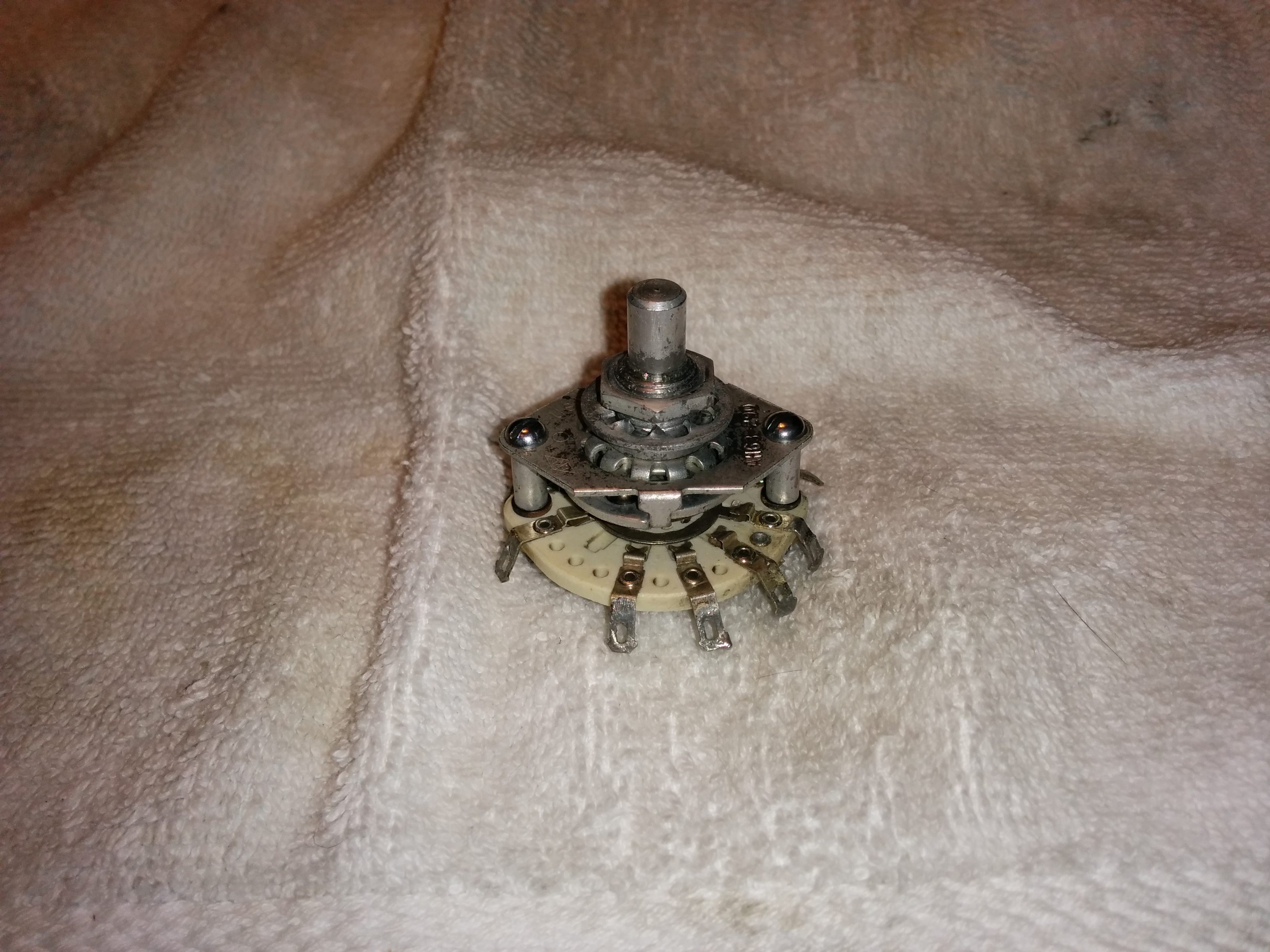

In this video we look at several types of wafer switches. We then look at a method I use to clean these switches and bring them back to life. These switches are in many types of equipment. Lets look at what we can do to repair these.

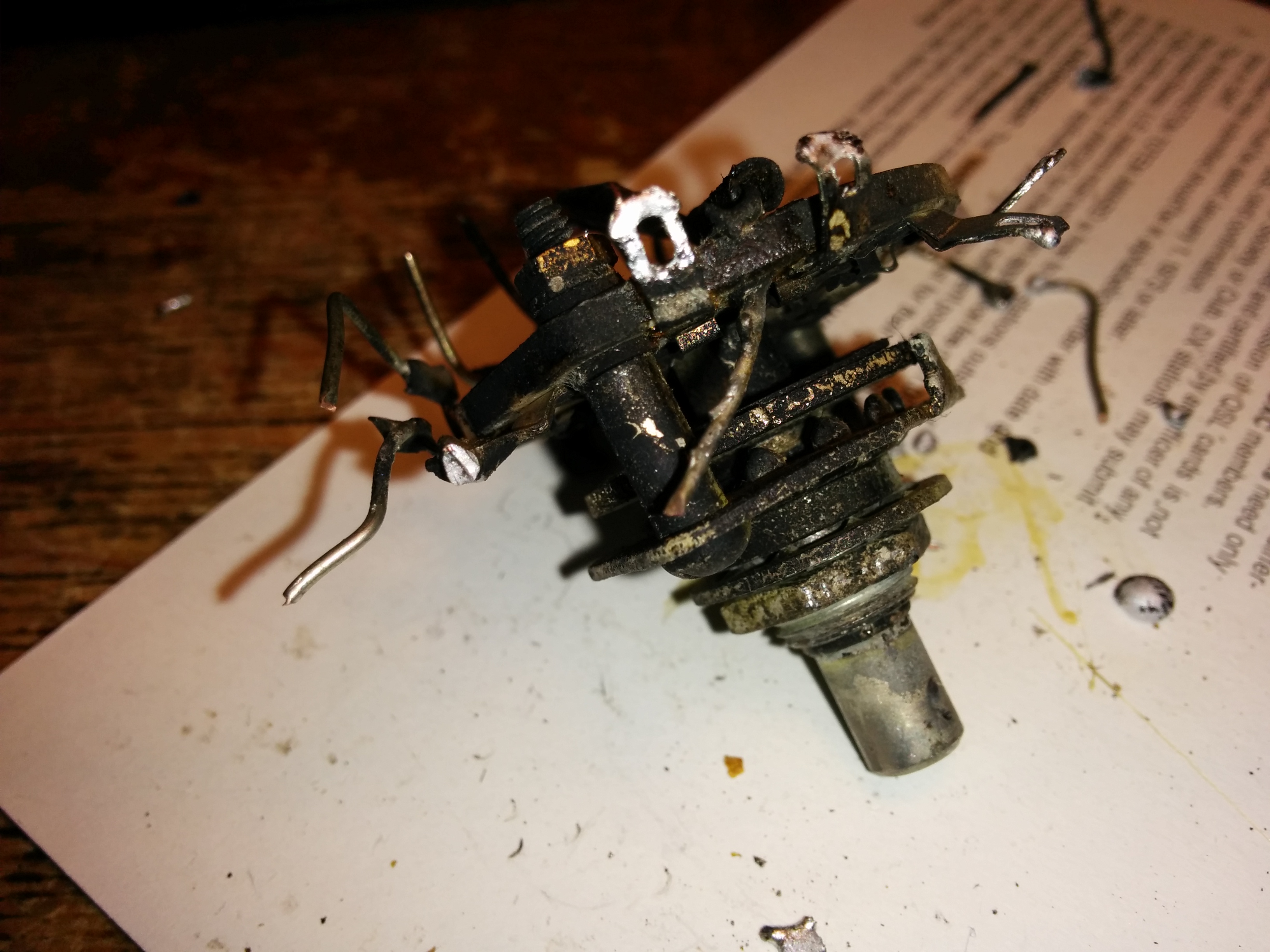

Recently I picked up a pretty wasted looking crystal switch for a DX60B. The rig it came from was in a fire from what I could tell. I took it apart, soaked it in vinegar and used a soft toothbrush on it. I was surprised it came out as well as it did. Things are often not as bad as they seem!

Thanks and good deal. Now add a little salt to that vinegar and that will give it a chemical reaction. Does the scrubbing for you.
