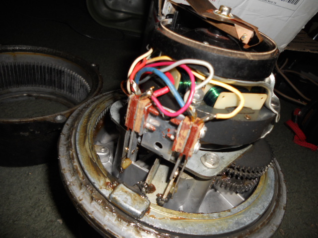

thanks for them links:thumbup: even tho its old,but was put away many yrs ago like new in a shed,should i take it apart and check it out?
its so smooth,like a babys butt lol..
if i do take apart i will use grease i have..i have,old dinasour on the can grease from the 50,s like half gallon i never use,,its thick like wheel bearing grease used to be.
then i have some synthetic stuff similar to the old kedall blue grease.
i really hate to take it apart since its so quite and smooth but if i should i will.
I would tear into it and look for potential problems and grease it before I bust my butt putting everything up, then having a problem. Take it apart inside a big trash bag.
Follow N8FGB's advice on the grease. Do it right the first time.
I use a light lithium grease on my rotator so it will run better in the winter. You will not have that issue down there but don't use a grease that is too sticky or one that will run when it gets hot.

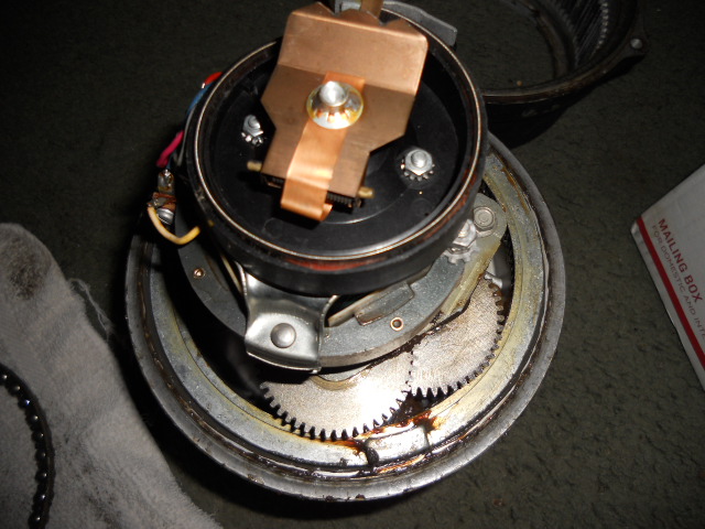

opened it up and all looks great thankfully..the bearings didnt fall apart ,got lucky. the bottom bearings,the first i seen when tearing down have grease but will add a lil more.
since everything is so clean im not touching it..looks real good inside and none of the grease is hard anywhere..theres a bunch in the deeper bearings so gonna leave it be.just add to the others.

n8fgb thanks for those links..i wouldnt have known it was a m rotor otherwise,it has no nothing on it that i can see.
onto the other rotor..i cant find it per the id link at all..it has stamped on it
D00 5037-00 has a diamond shape with an letter A in it.
has a casting circle with "76" in it so prob 1976?
other than that it has a nuber 2 by itself in the same are as the other numbers.

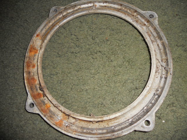

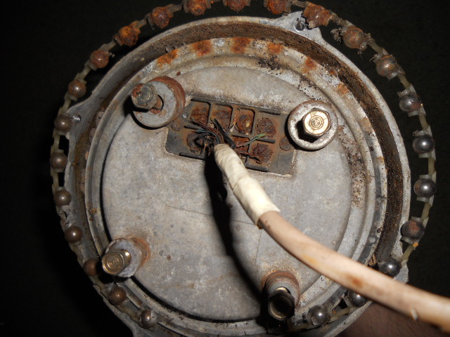

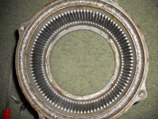

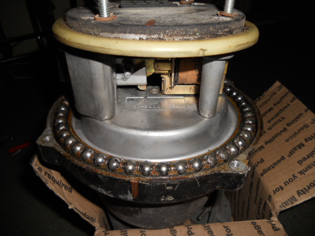

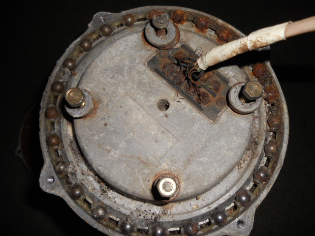

so felt confident since now i no there pretty simple and took the spare apart..glad i did this"thanks fellas" cause if i would have tested it i would have grinded all the crap up and ruined the alum race/frame area..
it was very clean and looks good other than the rusty bearings needing replaced..checked the race area and all is very good,no marks or scuffs at all..prob just rusted from sitting so long..
also missing 3 bearings but no scraps in the rotor anywhere.
maybe someone dropped tham and couldnt find them :wink:
someday i will order new bearings and then test it out,and have a spare..or for maybe a vertical quad so my flat side dont get lonely.:wink:
i have lots of confidence it will work fine when cleaned up since dad said it did work fine..
he also told me the cde/cdr control box didnt come with the brake switch on the side,that it has been added for that ham m rotor.so im kinda hoping since the older rotor dont have a brake the control box will work for it also..he said it did,but according to the id this rotor isnt a cd44 like i thought i guess.

well lookin at the pics the second rotor may only be missing 1 bearing..they are spaced out a lot,maybe someone robbed the other bearings for another rotor or it must come that way lol.
