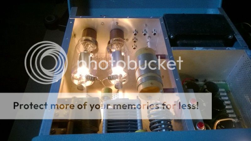

The tubes arrived in perfect condition. I was going to install them last weekend but the SB-200 took a dump. I pushed the power switch on Saturday and saw the meter lamp light for a split second and go out. Power never actually came up on the amp. There is power to the on/off switch and it tests ok so I think something opened in the soft-start module which is next in-line.
Going to try to pry it off the chassis (it's glued on) this weekend and check the resistors.
So I poked around the soft start board last night and found one of the 10 ohm 10 watt resistors to be open. Radio Shack still stocks these resistors and my local store has them. I hope the fix is that easy :)
I replaced the two load resistors in the soft start module and the amp is working fine with the new tubes. I removed the Cetrons that were in the amp to tset the amp for the smoke test of course..
The new Taylor tubes from RF Parts look like copies of the Cetrons I'm keeping as a back up set. With 65 watts drive the amp runs about 650 watts 80-15m and about 500 on 10m. That's assuming the meter on my tuner is colse and I think it is.
