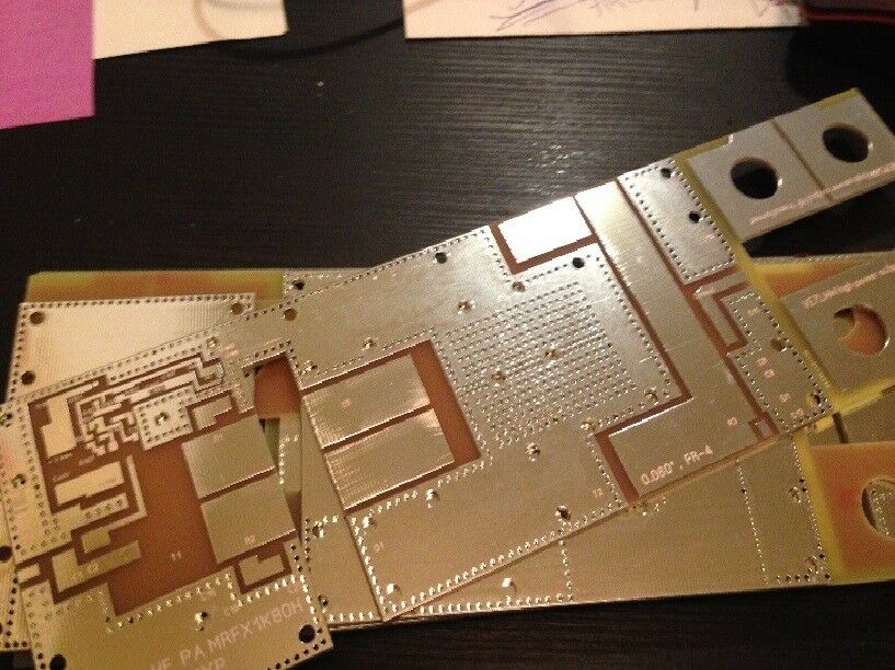

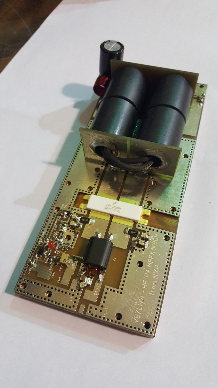

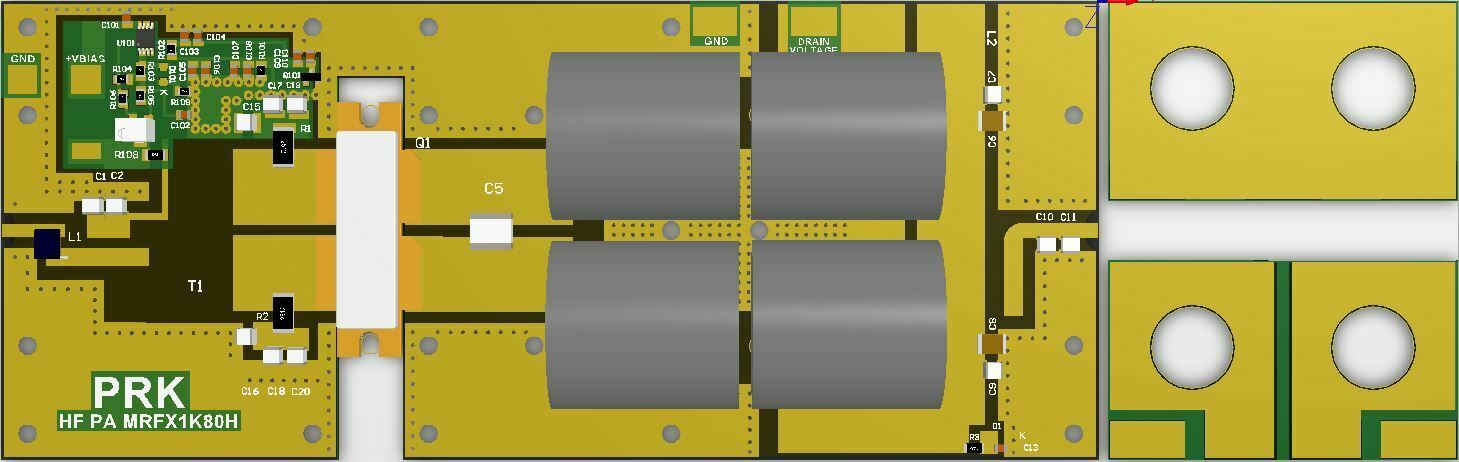

4 x MRFX1K80H @ 65V :-)
Bare boards available. Passives are less than $50 including the transformer cores per board.
I'm sure you can source a 4 into one combiner.

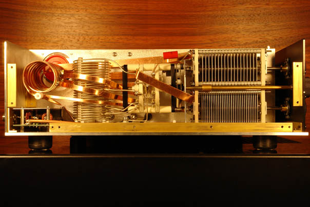

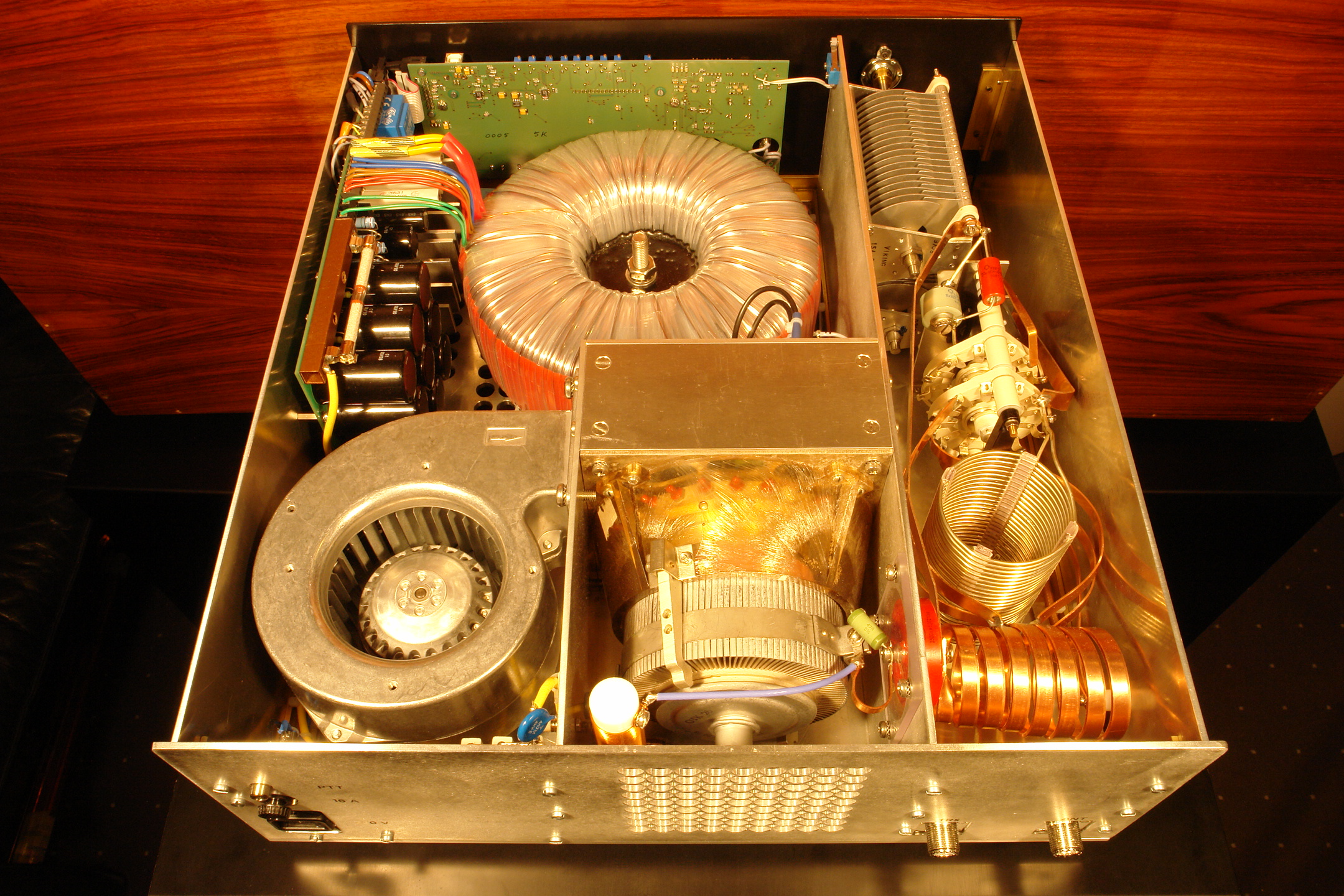

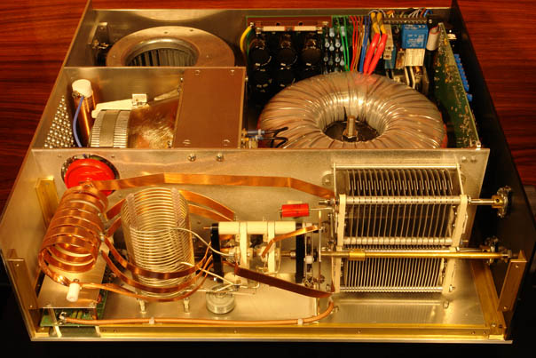

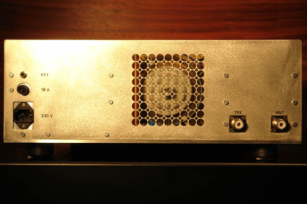

OK on those 65V LDMOS. You say there are 4 device bare boards available - with a schematic or and parts list? I have only seen single and dual 65V LDMOS builds out there from RF Man: https://www.youtube.com/channel/UC7r5QeuynhXudskQDl7J45w/videos and https://www.youtube.com/channel/UCJ943xhv66Sy29PMrrAjCLA but no 4 x 65V LDMOS unless you guys know otherwise? Yes, several sellers with LDMOS protection boards. I have found a rather nice AC unit and would love to think the internal PSU would make room for a DC to AC equivalent. Remember this is primarily for sideband so figures in/out are pep: 90W in for 5.4kW using a single Svetland GU78b.All bands, soft-start , well regulated grid and screen supplies, plus current limiting to protect the tube, two-speed blower etc.
You can double-click on the images for super hi-res.

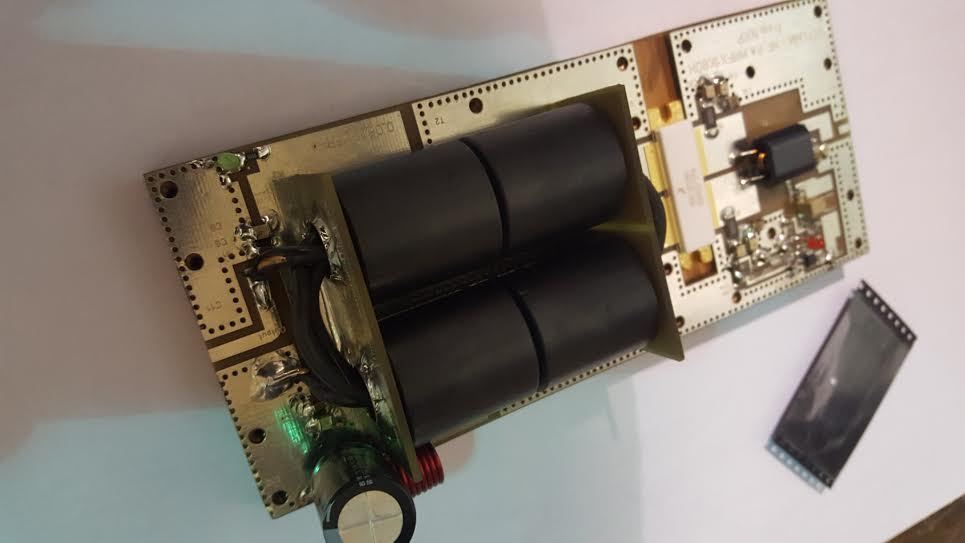

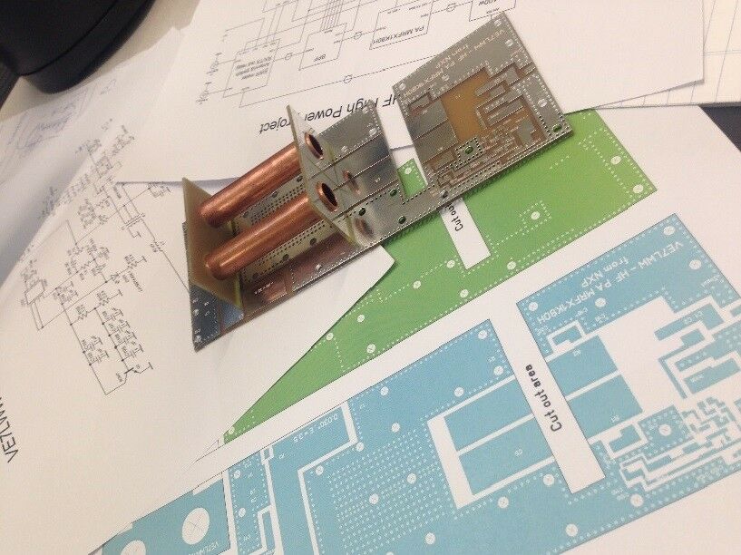

That's a conservative 1500w @ 65v
The combiner is child's play.
A 6KW low pass filter? Not so much...
