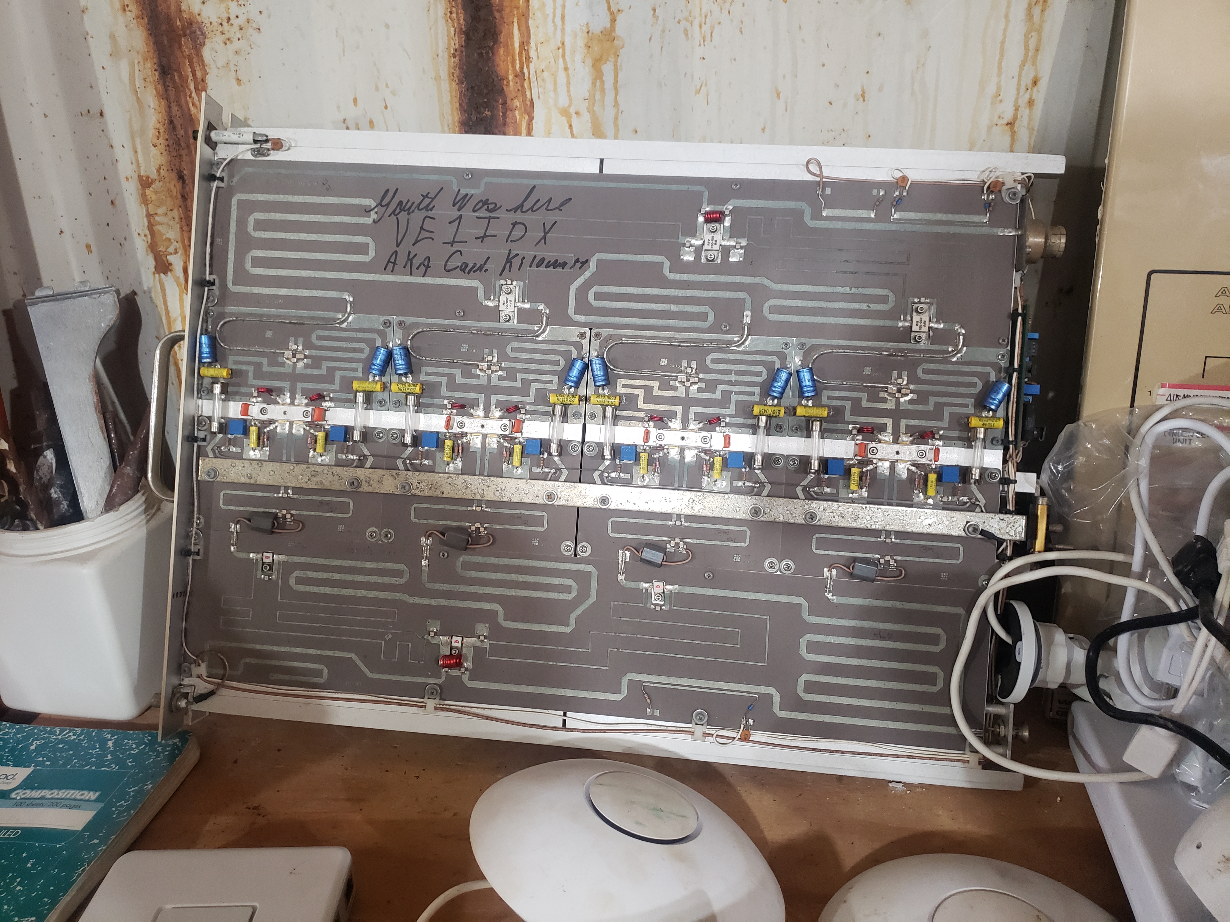

Good to hear from you. My Larcan is still waiting to be put on the air. Remember however that it has already had mods done to make it work better on 6m. That is what Warren was doing. They have already been modded for 6m. Nothing further required it work on 6m except for a ptt and T/R relay and power supply The tuning has already been done.
OK, i wasnt sure if those very first ones were like that... once im on the air i will get a relay and put it to use then. Mine still has your signature.

View attachment 37536 View attachment 37536
Ok. Thanks for the great info. I have rack mount audio gear I used to use with the 847. It would need adapting for the 7000 but for now I will research what you noted I did find the mic mod online. Likely I will look into running rack gear into it at some point but I'm not sure if that is even necessary anymore alot has changed the past few years.
I remember that!! LOL Yeah I can see the SMD capacitors that Warren added to the input and output sections of each MOSFET on that board. It is already retuned for 6m.

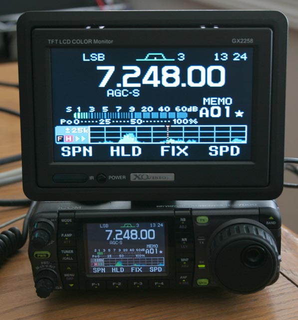

... edit...I sold my 7000 about a year ago, ran it mobile but might remember a few tricks...So feel free to ask..
Well, lets start with the S-Video jack, get an S video plug and then connect to an external monitor, or even the video display in your car or those cheap DVR players that run on 12 vdc .
I bought mine @ Wally World, 2 displays 12 vdc power cord and s-video connector/wiring for abour $30.
As fasr as I know, the IC7K is the only "recent" rig with an S Video jack.
