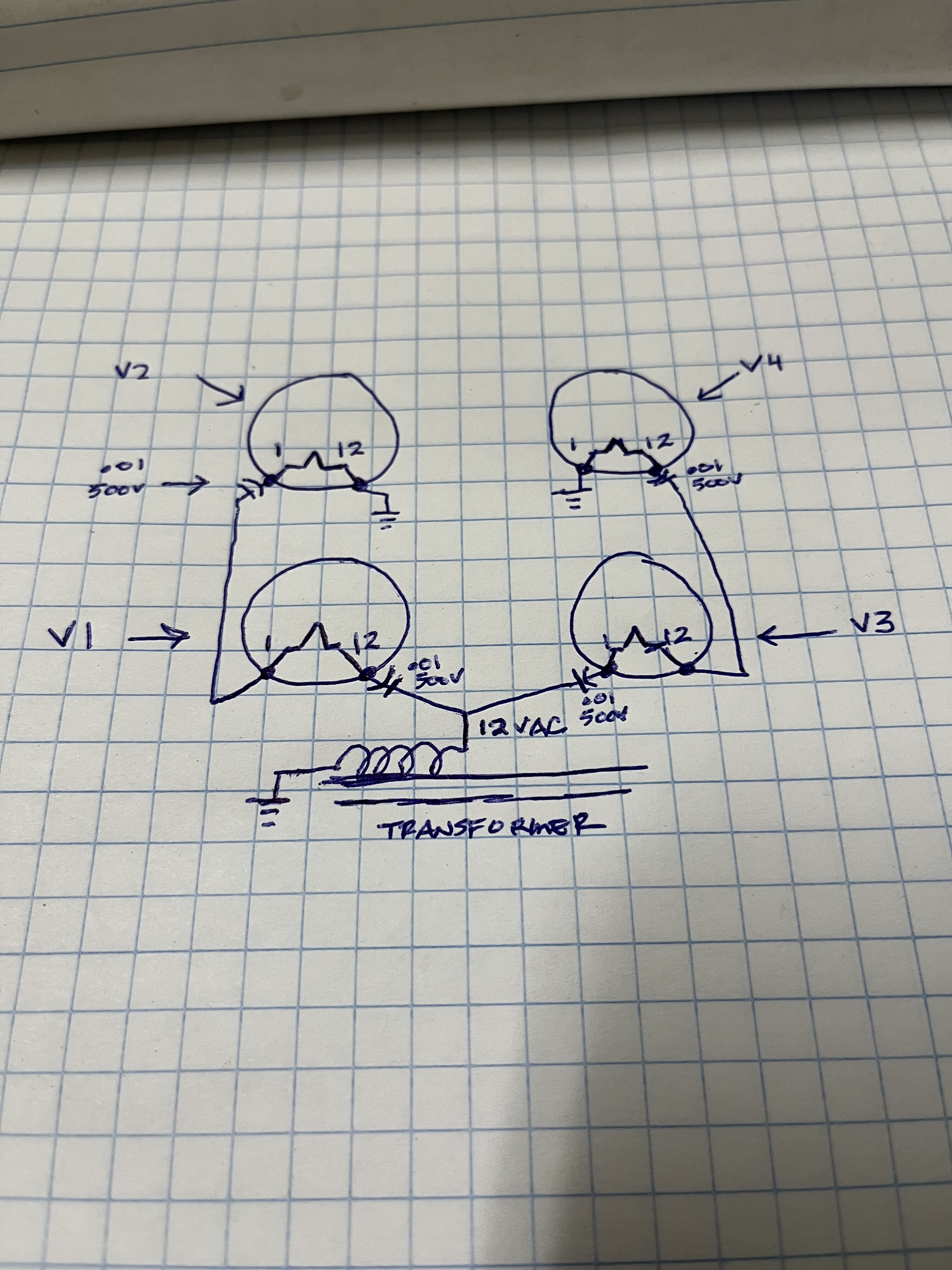

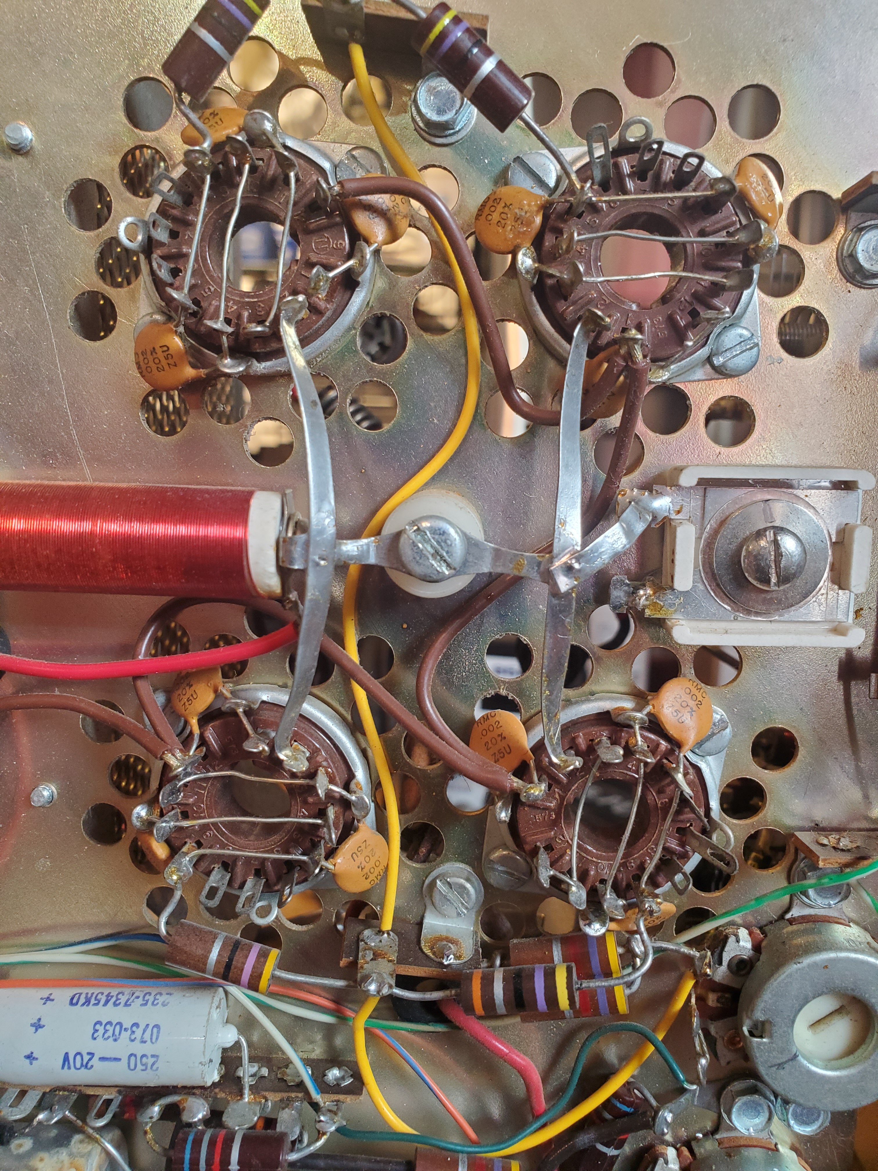

Hi, I am also wanting to do this conversion and have a Siltronix LA-550 and I am just slightly confused and or concerned on wiring the 6lb6's in a series, could you possibly help? The brown wire in the photo is the 12v and it is going to the first tube on pin #12, then it goes to tube 2 on pin#1, then to the 3rd tube on pin #1 again then on the 4th tube to pin#12 ....... so to do the modification wouldn't I just have to work on the top 2 tube sockets and move the brown wire from #1 pin and place it on #12 pin on the top right socket in the photo, then move the wire on the other top left socket to pin#1????? Also as you see in the photo there are the ceramic caps that tie pins 1 and 12 together and go through a ground, wont these need to be removed and turned around and soldered back in ??? Thank you and I hope you or somebody can clear this up for me
Not an easy way to type this out but I will try.
For 12v filaments, all 4 tubes will have a single 12v wire to pin1 (or 12-doesn't matter). The pin without the 12v feed will be grounded.
In your picture above, it appears the 12v feed starts at the lower left tube in the picture. The other 3 tubes are just "daisy chained" in the circuit.
For 6v filaments (from a 12v feed) tie Pin 1 (after removing the ground tie-via the capacitor soldered to the rim of the tube socket) of the lower left hand tube (in your picture above) to Pin 1 of the lower right hand tube (in your picture above). Pin 12 of the lower right hand tube is grounded (as pin 1 was) with a capacitor tied to ground at the tube socket.
Repeat the process on the 2 upper tubes (in your picture above) and you are done. You can feed your 12 v from Pin 12 (of the lower left hand tube in your picture above) You will need to add a wire at Pin 12 to feed the 2 upper tubes.
Two 6v tubes in series = 12v.
Tube 1---12v feeding Pin 12-filament-Pin 1 will measure 6 volts.
Tube 2---6v (from Pin 1 of tube 1) to Pin 12-filament-Pin 1 to ground. You will measure 0 volts on Pin 1 of tube 2.
:Edited to add the magnificent artwork!! :LOL:
I hope this is not too confusing.
David

Hey man, I really appreciate that ! Thanks a ton ! One last question, am I supposed to remove all those caps that are ground tied if they are in pin 1 or 12 on all 4 sockets ?

I guess what I am asking is if those caps connections on pins 1 0r 12 that are grounded are supposed to be removed completely or just off the pin because they run across other pins in the tube also

One decoupling cap at the "hot" end where 12 Volts feeds the two series-connected heaters, plus one at the jumper point between them should be fine.
Copied from nomadradio's post #23 of this thread.
The decoupling capacitor should be in parallel to the 12v feed of your first tube and in parallel to the (now) 6v feed of the second tube in the series pair.
My drawing above does not show the correct configuration of the decoupling capacitor. It is drawn in series with the voltage feed.
The pin 1 or pin 12 lug you feed the 12v to will have two connections on the lug. One end of the decoupling capacitor, and one 12v wire feed(or 6v if it is the 2nd tube in the series). The other end of the decoupling capacitor will go to ground.
David
Reactions: Danzik
David
Ok, I do not know much about these decoupling capacitors to be honest I just know that they act as a filter to keep the DC noise out of the AC current when keying the mic, so with that being said what are the values of the decoupling capacitors that I will be needing? I see in the schematic it says 001 500v ? So is that like uf or farad or what I am kinda lost there, also will these have a polarity I will have to go by and install the correct direction like a regular capacitor? Sorry as I am learning here
The value is not critical. There is no polarity on a ceramic capacitor and you can probably use the ones already in the amp.
For example your lower left tube in the picture you posted above has a .002 uF (microfarad) capacitor tied to pin 12, pin 1 and ground. Lift the soldered connection at pin 1 and leave the solder connection to ground. Then tie a wire from pin 1 to the 2nd tube in your first series pair. Repeat the process on the upper 2 tubes in your picture.
David
Reactions: Danzik
David
