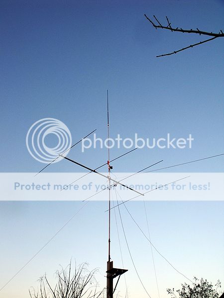

I have all 3 up in the air.. A R7 vertical, 5 element tri band and a end feed wire.. The wire has a quiter recieve (not as much static as the vertical) but the vertical works better for DX than the wire.. Most times the beam is better for DX and other times where the vertical was better is some instances, It depends on the conditions and locations at the time..
Before I got the beam I would use the wire(dipole) for recieve and the R7 for transmit A vertical will pick up 10x the noise compaired to my wire...

I needed to get one of my antennas on the ground for a little modification, so I put together another EFHW and mounted it above the 4 element Yagi I had put back together. In a small window of fair weather I put them in the air Tuesday afternoon.
Today the conditions were worse if anything, however, in the moments they opened up I was able to make 5 Hawaiian contacts, and 3 West Coast contacts.
Neither the Merlin, nor the EFHW could even hear 4 of the contacts I made, and the other four were so far into the noise floor I could not pull them out.
When I considered putting something up while I reworked a part of the 5/8 GP, and a few other chores I had no problem deciding for the Yagi. I had gotten weary of being unable to work DX and was on the verge of DX DTs.
I know different places and different conditions can require different approaches, but my experience is like Robb's - The Yagi has been the most consistent performer with respect to DX.
