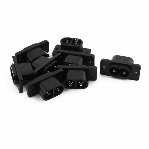

Not sure what the pin to pin distance on that is, but I think that is either a C7 or C8 male plug. Check ebay:

For decades we bought the cord to fit that jack from MCM Electronics. They got bought, and no longer sell it.
Unless you are in love with restoring the radio to historic accuracy, I would get a hardware-store replacement and route the new AC cord directly into the radio through a grommet, and add a toggle switch to the rear panel to select AC or DC power. The switch contacts built into the old socket are already wired to do that.

Yes I could use a different type plug but the OEM one has the built in switch so if you take the radio mobile or use it on an external power supply via the 13.8v plug on the radio, the internal switch disconnects the 13.8v one while the 120v source in applied.
Don't see just why a small toggle switch won't accomplish the same thing. The radio won't know the difference.
You'll just have to remember which way to flip it to match the source of power being used.
