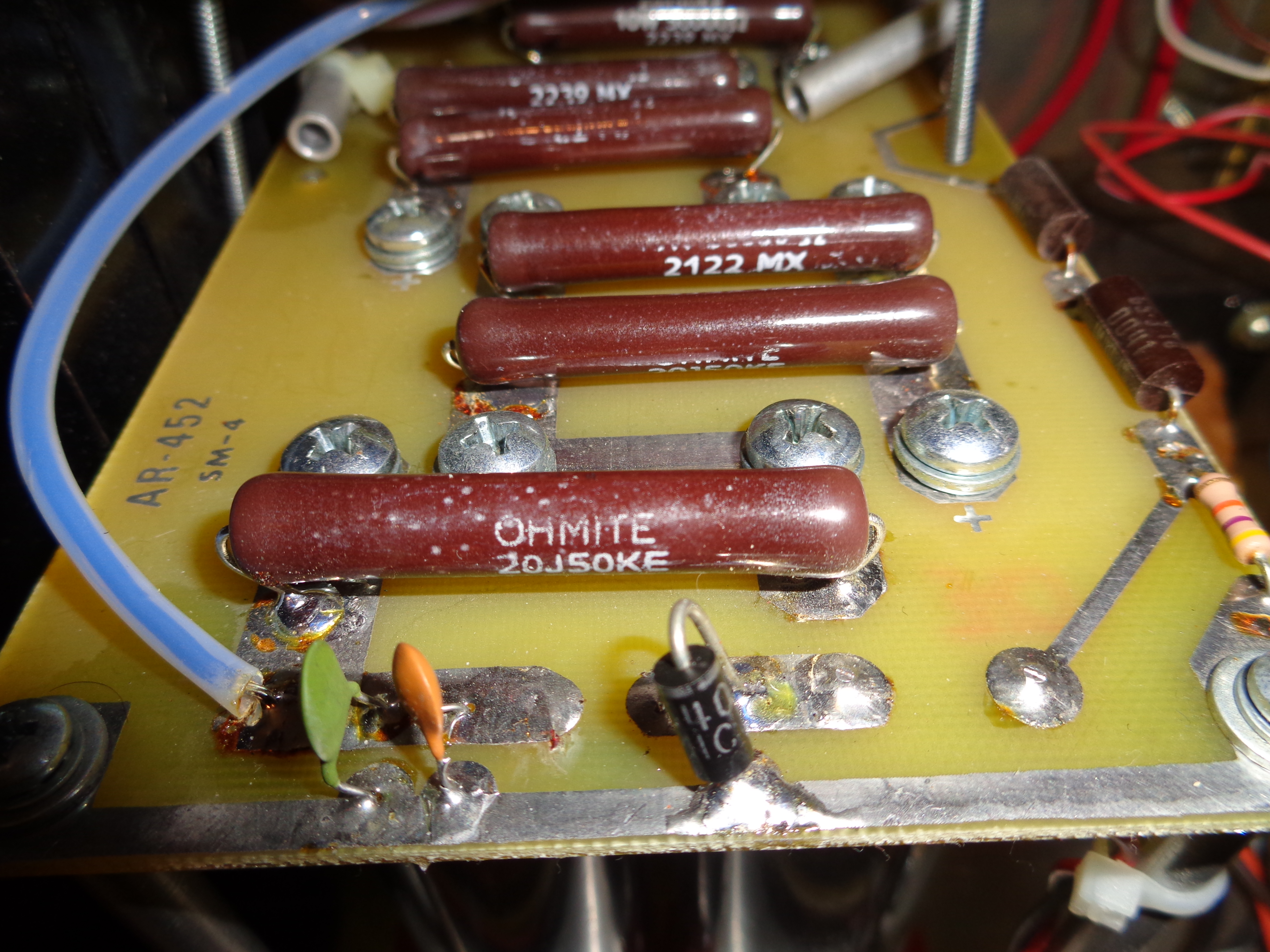

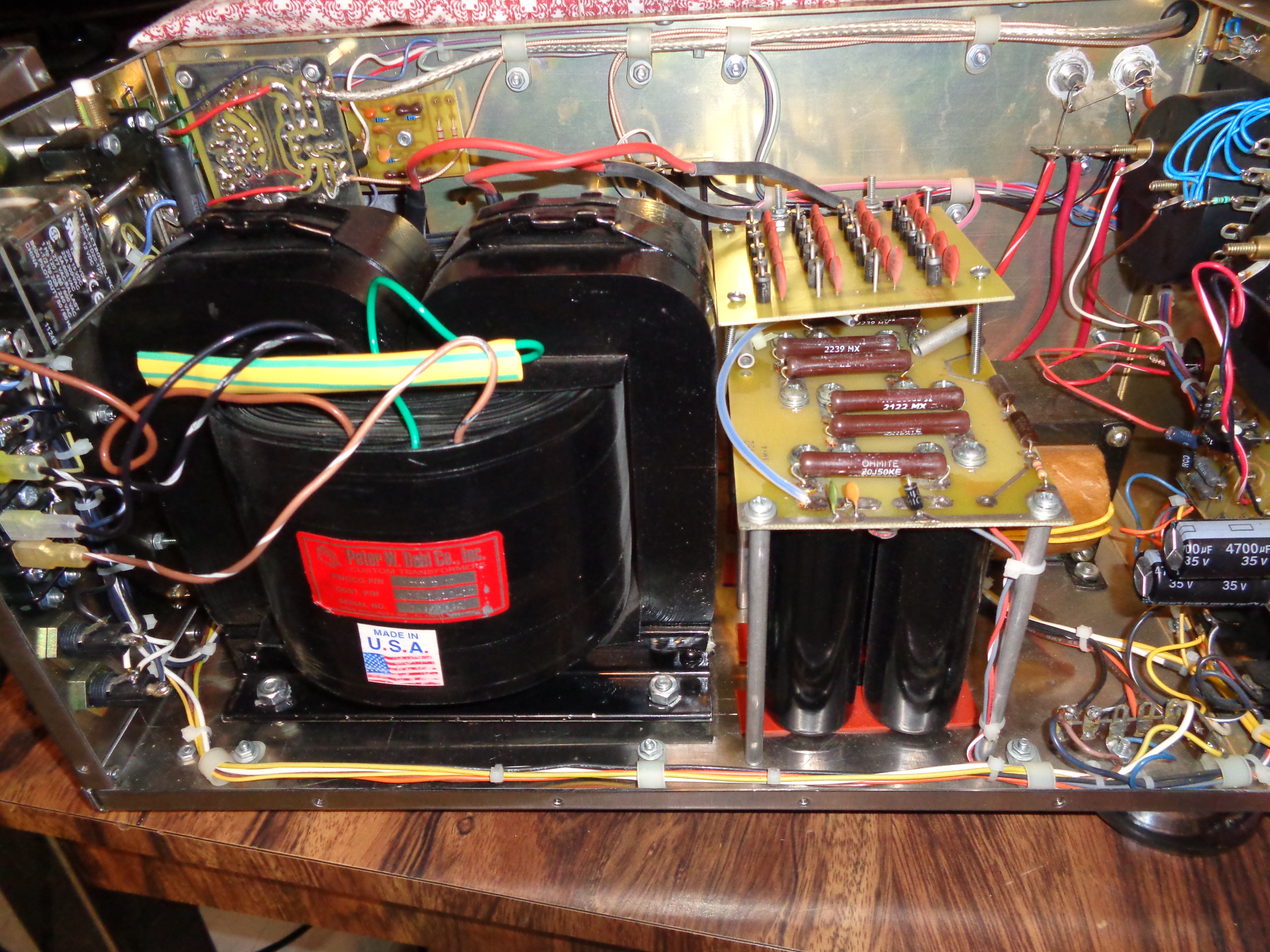

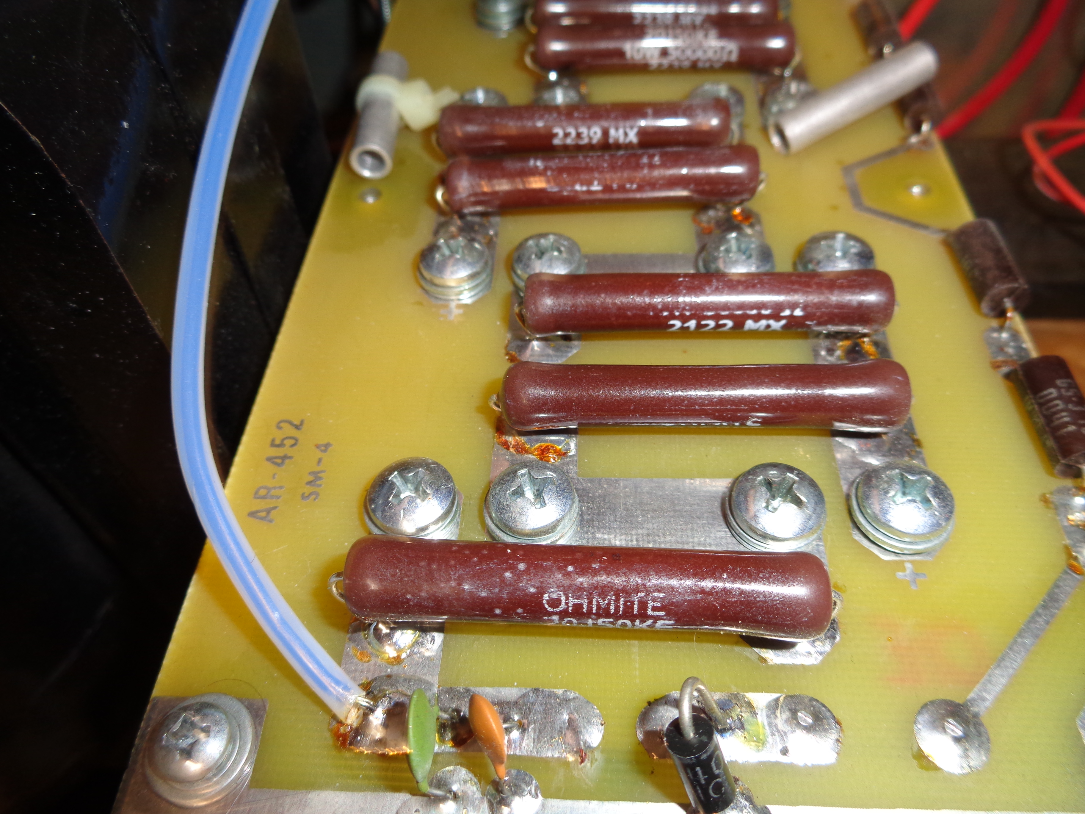

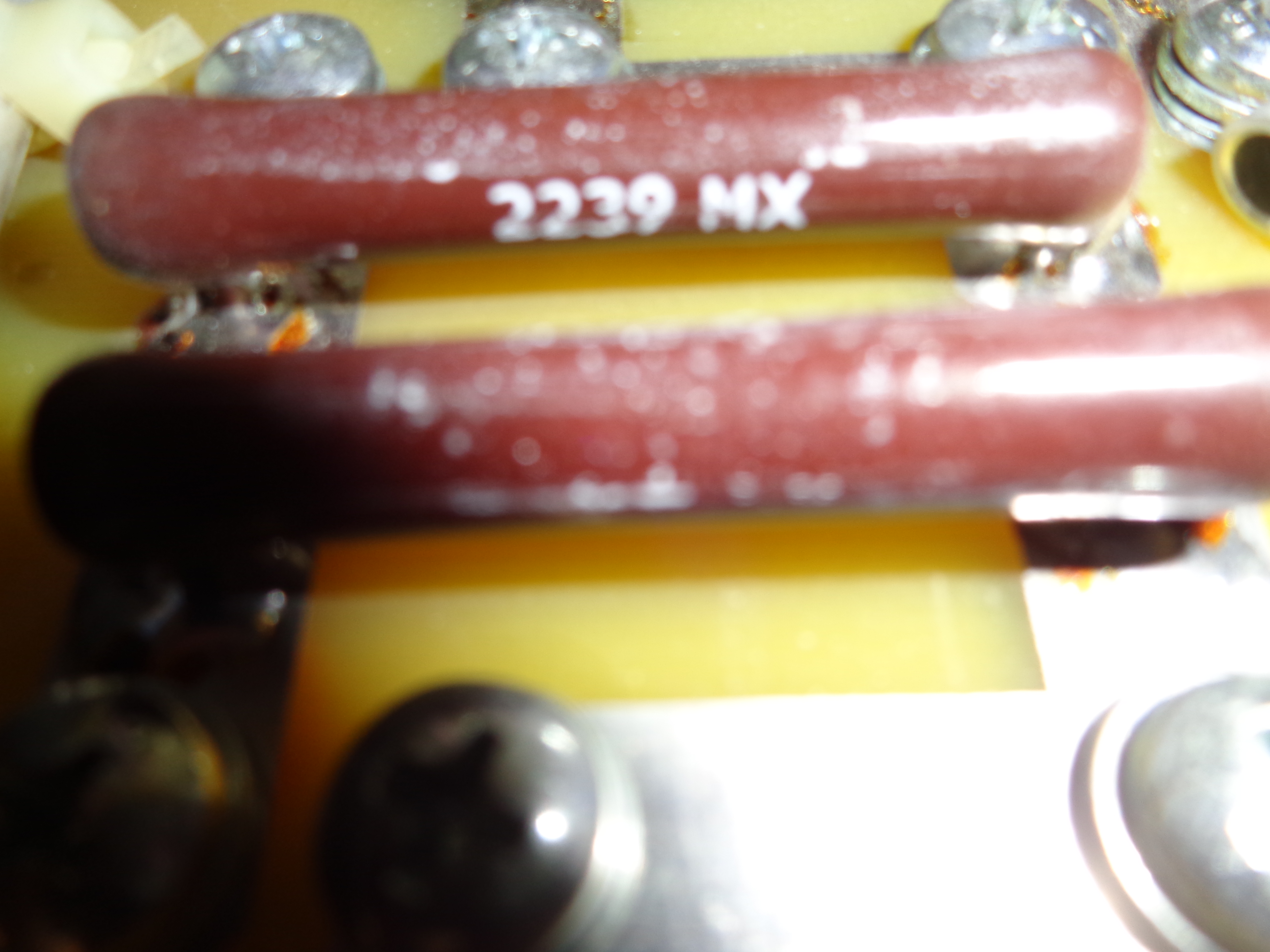

I'm doing some spring cleaning and inspection on the al1200 and the ohmites white lettering is wiping off on the most of the inner resistors....the others are ok mostly.
Does that mean anything like they are getting too hot?

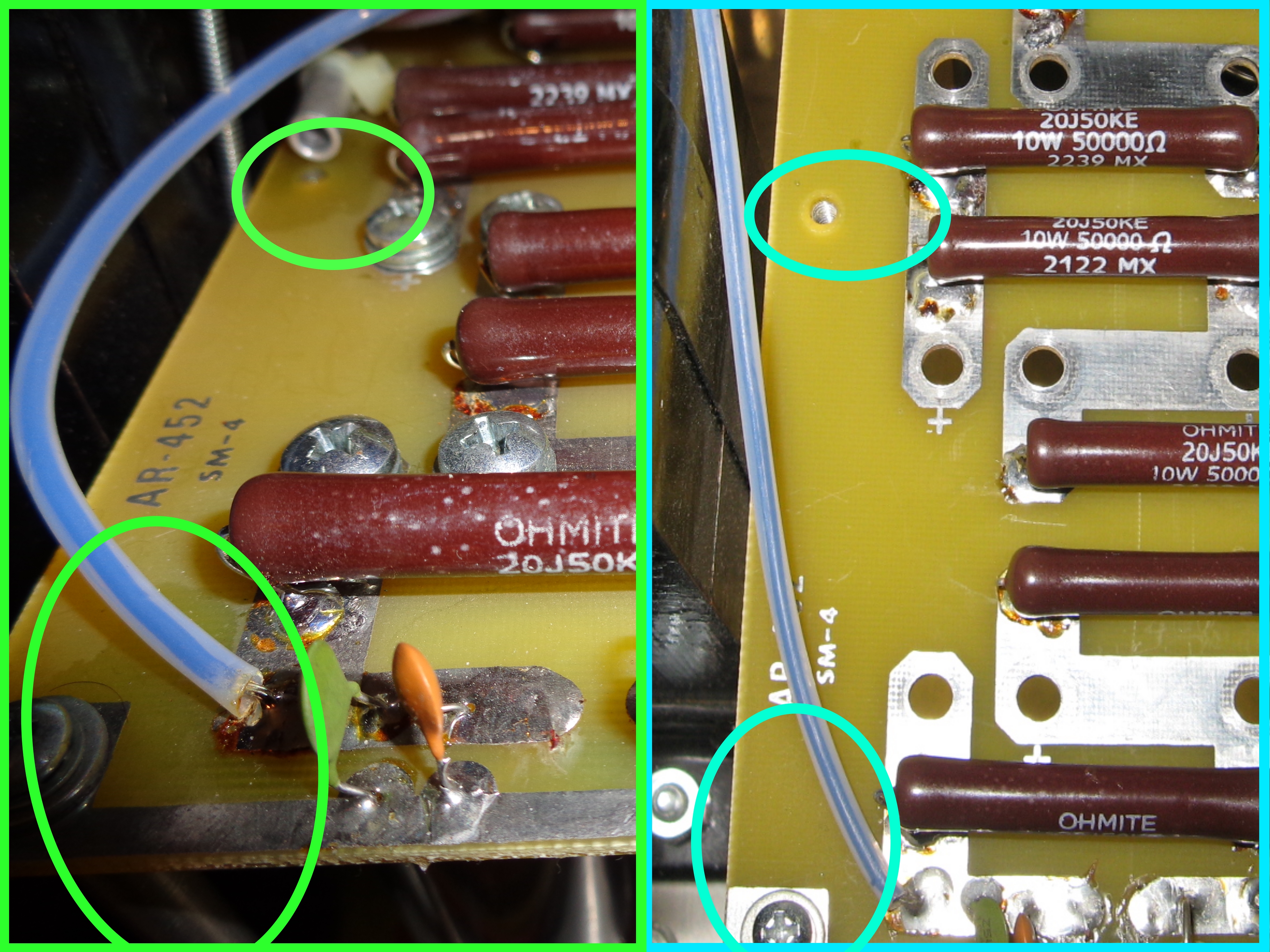

Also the board seems a bit saturated with something? It wasnt there in Nov 2022 when I put the new caps in.
I think its just rosin from the solder
  • Haha
Reactions: techradioman
They are designed to get hot. That's the point of using a ceramic body. Power resistor design is a tradeoff between how hot its materials can be allowed to run, balanced against the physical size. The more surface area, the less temperature rise. The printed ID stuff will flake off eventually. A fanatic would change the bleeders to a higher resistance value and reduce the heat that way.
That kind of resistor almost never fails without first being massively overloaded. The steady heat from this service should not be a problem.
