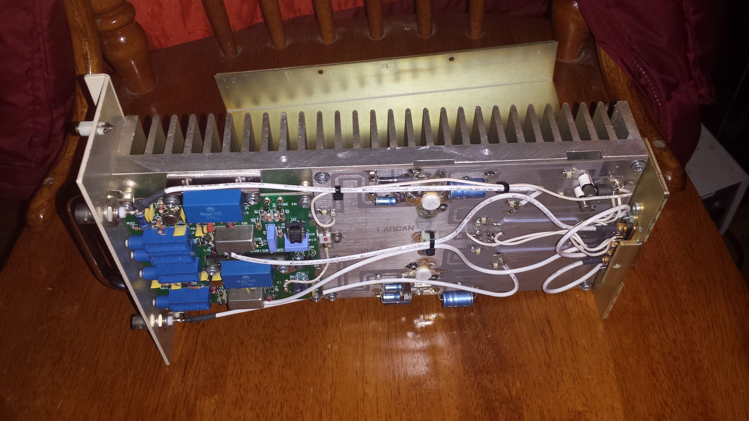

It's the IPA or pre driver stage.
Uses a pair of MRF148 transistors.
50VDC power supply required.
Photo attached is for high band 174-230MHz. The 50MHz version is the same size, but does not use the circuit board with the 2W ICs at the left. It uses an Anaren 3dB coupler at the input and output. This is the closest to the actual module I can photograph at the moment.

Interesting. I have not seen those before. Then again television is/was not my thing except for watching what passes for entertainment these days.
I had a couple of them when you were visiting.
I guess we were too busy replacing pinched rigid coaxial line at the time. :whistle:
I just have the one pictured for 222MHz remaining. It has two independant parallel amplifiers. Would make a sweet set of drivers for a pair of 1.5kW amplifiers. :) About 2 watts drive for 3kW output.
I can hear the wheels turning now. :biggrin:
