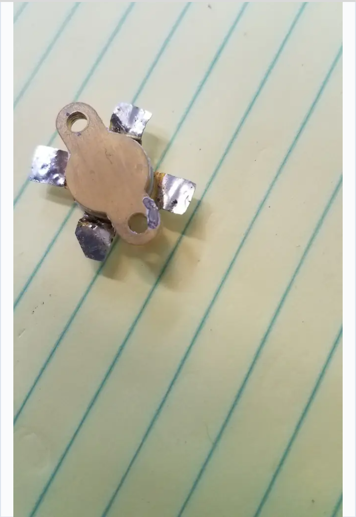

That is funny LOL. What are the power transistors with more gain that they are using? Can't tell from the video, haven't researched it. Never worked on a ALS-500, only the 600 model.
Ok I see here on the Youtube video description he adds this:
The second issue is mainly when PP100 transistors are used in place of 2SC2879 transistors. The amplifier has a large current spike. The PP100's have a lower base bias threshold, typically I measure around .51 volts or so, and high dc current gain at idle. The bias circuit has a very brief (a few milliseconds) spike of around .75 volts before it settles to operating bias levels. The PP100's also have a good bit more VHF gain. This causes the amplifier to momentarily oscillate upon relay closure.
