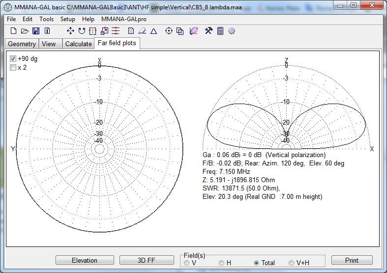

If I have an antenna up for 11 meters and i want to operate it at 40 meters is there a way to quick estimate the antenna characteristics based on the known values of 11 meters? Never have gotten the hang of the program everyone uses

Yeah .... and you've been listening to the stories that you can tune up a bedspring out in your yard to "work" on 80 meters if your tuner is good enough .... but what they don't say is that it will be horrifically inefficient and may you may only talk 1 mile away to a neighbor who has a real antenna.

I used to run a 102 whip on the rear of my SUV many years ago. I had a Yaesu FC-40 remote mount auto-tuner at the feedpoint just inside the rear hatch door. On 20m and up it worked great. On 40m not so much. On 80m I did make a few contacts to Europe with 100 watts and a few more throughout the USA but it was pretty rough going. The efficiency is only a couple percent on 80m and around 10% on 40m if that.

Anyway .... Yes the 102 will work fine on 15 & Up but below that it won't do very well no matter what.
Get Ampro40 and put it instead of that tank whip.
Other wise you need to make LC circuit to get good SWR on tank whip.
