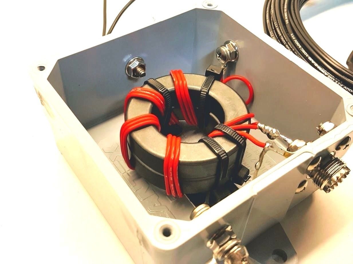

And the wire from this box, is pretty (gosh darn) long - about 117ft.

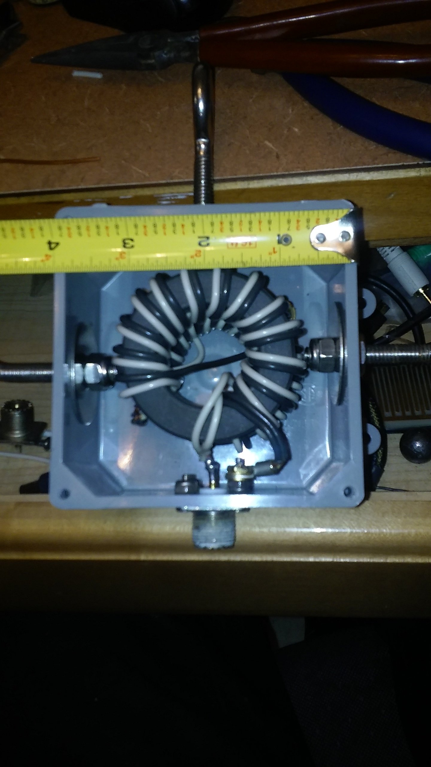

An off the corner - view...
Hope this gives you some idea...

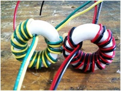

Here's a site to help you understand if not give you some insight as to using it or how it's made and works...
http://m0ukd.com/homebrew/baluns-and-ununs/91-magnetic-longwire-balun-unun/#comment-area
The above is simple balun wound as a unun...
