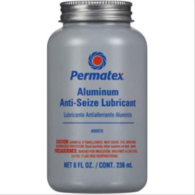

Go to AUTOZONE and get Anti-seize for cars with aluminum Heads. You have to use anti-seize on the sparkplugs or you end up galling the threads and have some expensive repair work ahead of you.

These are the two that I use on ALL joints and connections. I prefer the Jet-Lube. It is Pure Copper. I have unwrapped joints after years of being in the weather, and after cleaning the Jet Lube off, the joints are still as pristine as the day I wrapped them with silicone coax wrap.
https://www.dxengineering.com/parts/jtl-12555
https://www.dxengineering.com/parts/dxe-p8a
