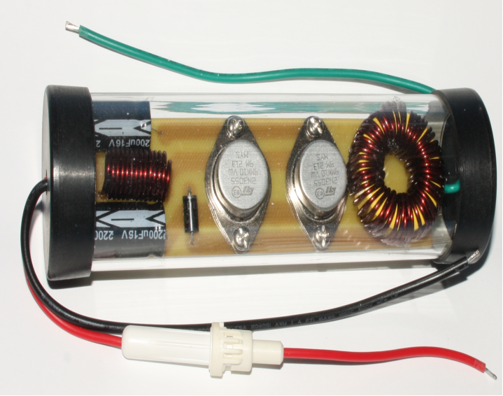

Among other considerations per truck electrical noise reduction, the (David) Navone filter shown has been recommended by another of our contributors. (See website).
It’s large in size and not cheap, so recommended as a final effort where other approaches still fall short.
Beautiful. Thank you very much. Hoping I don't have to do a filter. But good to know one that comes recommended by the community.
