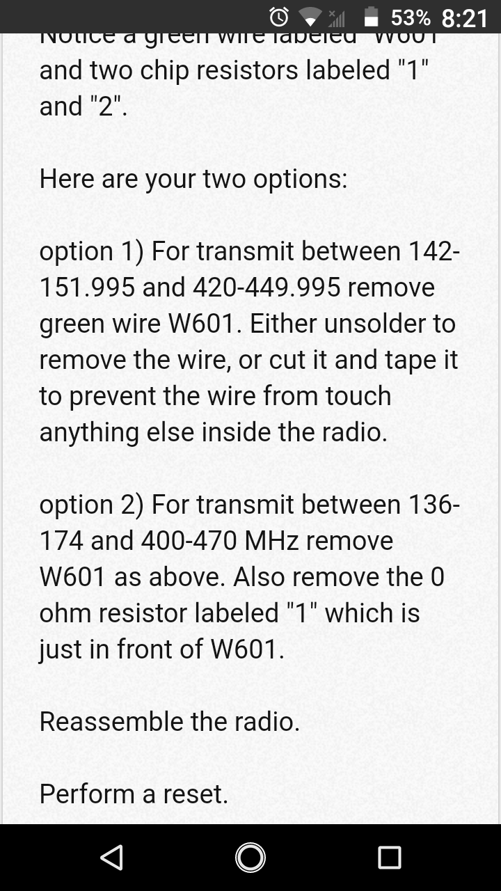

Also for those interested, the unlock mod for this is trivially easy. So I backed up my radio with RT systems software and USB cable. Then I unplugged everything and took the lid off (bunch of screws, looks like #1 or close to it) and look on the left side of the radio you will see a captain obvious "please remove me" green wire jumper. Grab this with tweezers and hit the 2 pads with a decent soldering iron and remove it. I then used a wick to take the solder off the pads (but this isn't strictly necessary, lol) Then you will see two diodes below it. Remove the one closest to where you removed the green jumper from. I think this is "J1" or something. This is a little trickier but didn't take long, whole thing took 5 minutes. After you've removed the grain of sand, put the lid back on and all the screws. When you power the radio up it will reset itself and it's now unlocked. I then dumped my config back into the radio and back in business, then did a quick test on a MURS freq to see if it worked... bam, done.

I got one from a dealer that did the mod and it wouldn't cross and repeat after that. They said they never tested it after the mod for that specfically.
They took it and gave a swap for a non-modded one (made sure different SN)..
On that one I only unsoldered the green wire and got 'wide enough' with it and cross band still worked which is what I needed it for..

142-152 approx
420-450 approx

That's good to know, I will have to test crossband to see if it works, not that I use it a whole hell of a lot. I'd much rather have the extra freq range.
I'm guessing its some kind of firmware/revision issue, I just tested cband repeat in and out of the ham bands and its fine....
It's possible too they unlocked the radio some other way which botched the cband... you might want to check or post on mods.dk and see if anyone else has mentioned the issue.
