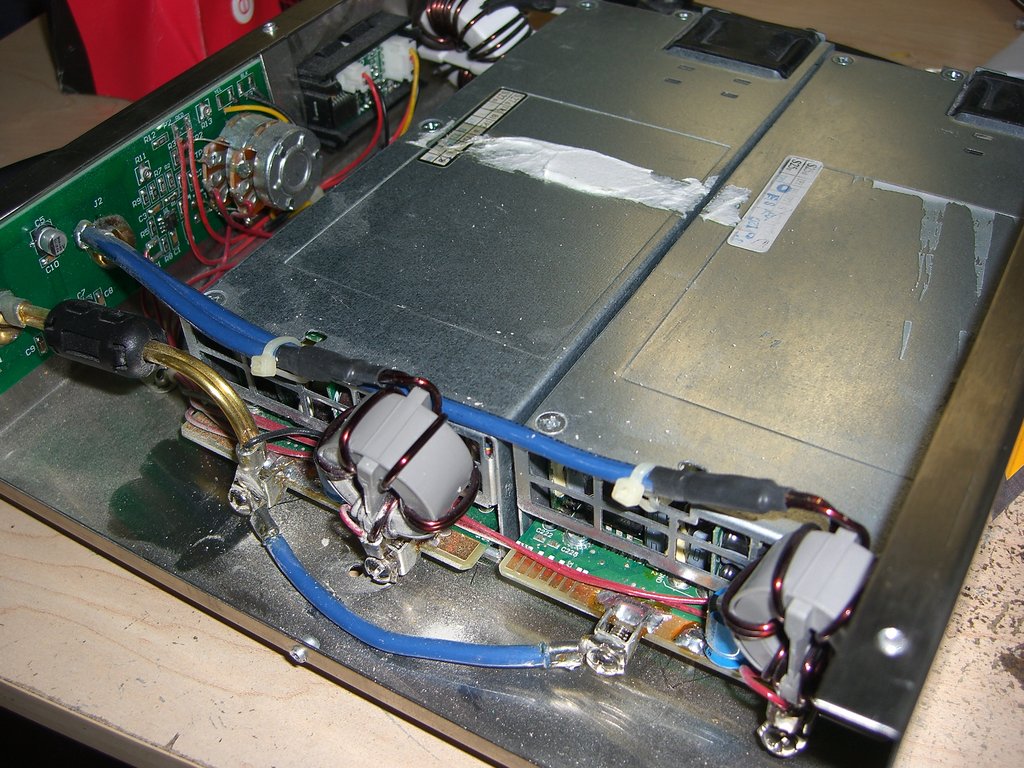

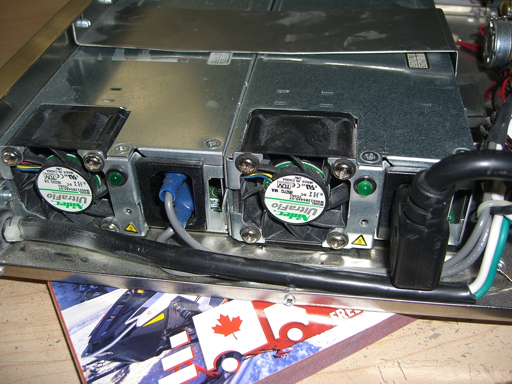

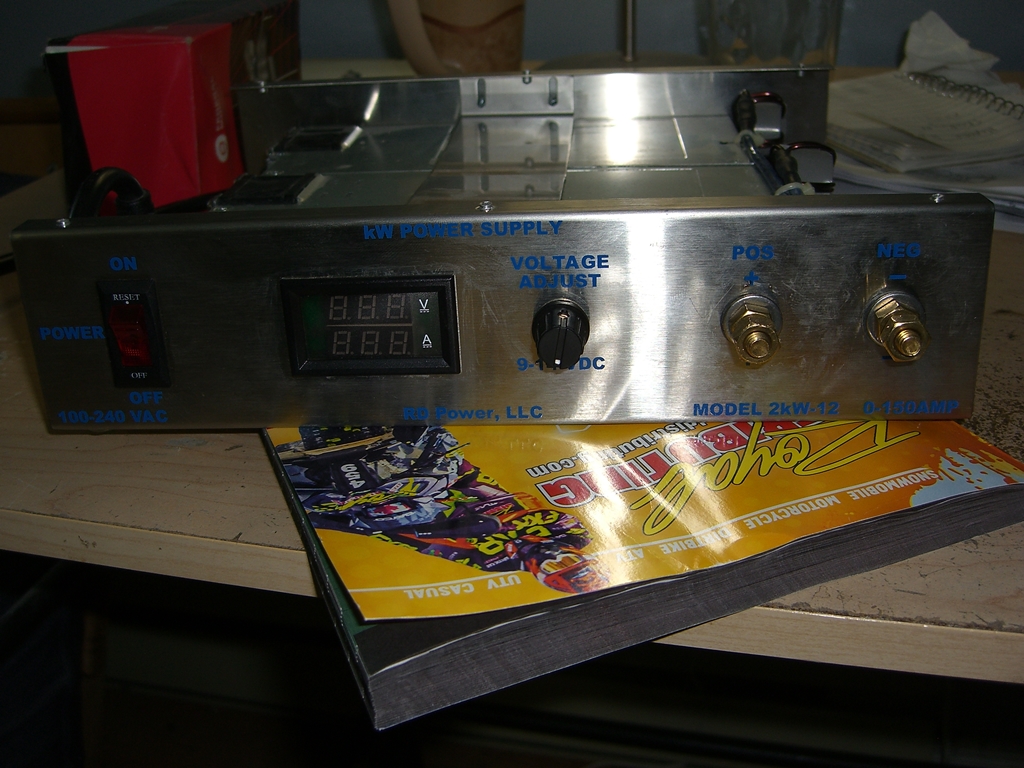

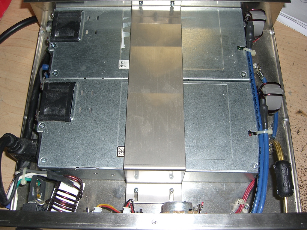

Anyone have a clue what these PS are from? this the inside of a RD power 150amp PS one of them took a crap on me and the labels were peeled off. I I find out the model I will buy and replace it as it was a decent power supply when working.
Reactions: Tokin
Id drop 2 new ones in there. Look like hp possibly. Im sure someone could refit this with 2 new switchers.
