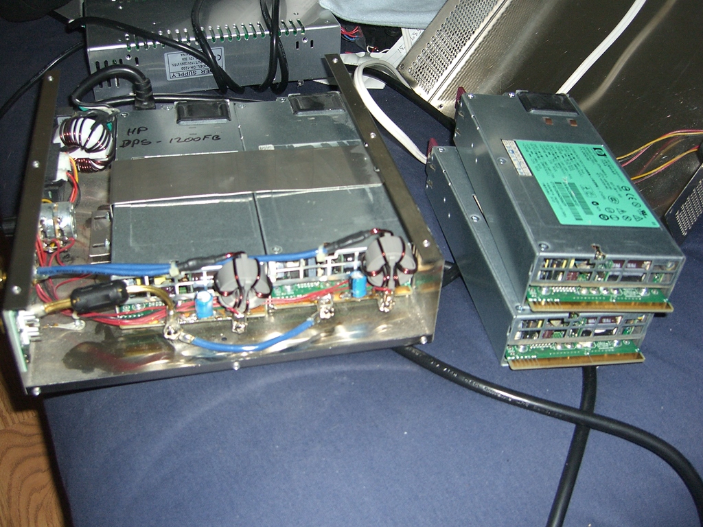

Anybody use switching power supplies?
Id drop 2 new ones in there. Look like hp possibly. Im sure someone could refit this with 2 new switchers.
Funny you say HP as I have seen some very similar looking hp units, will hang on to it till I find a few new ones
Reactions: Tokin
Well replacements were dropped in front of my door when I arrived home from work, so I hope to get them in on the weekend.
