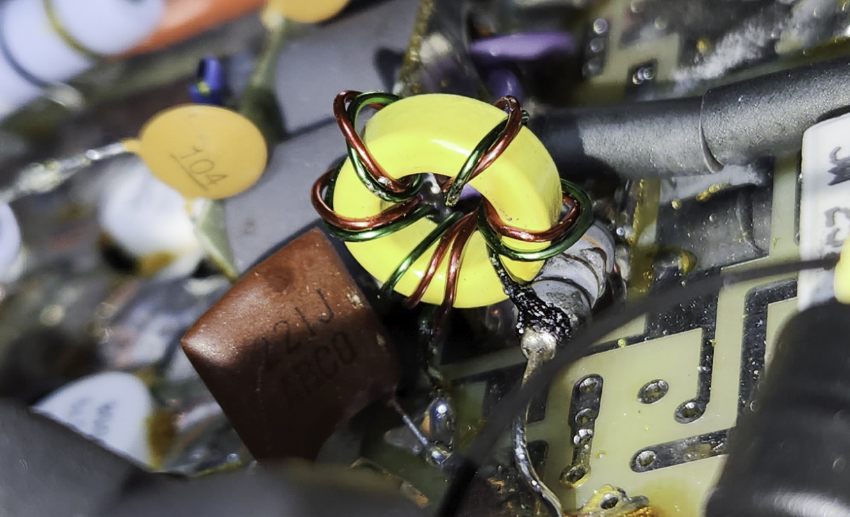

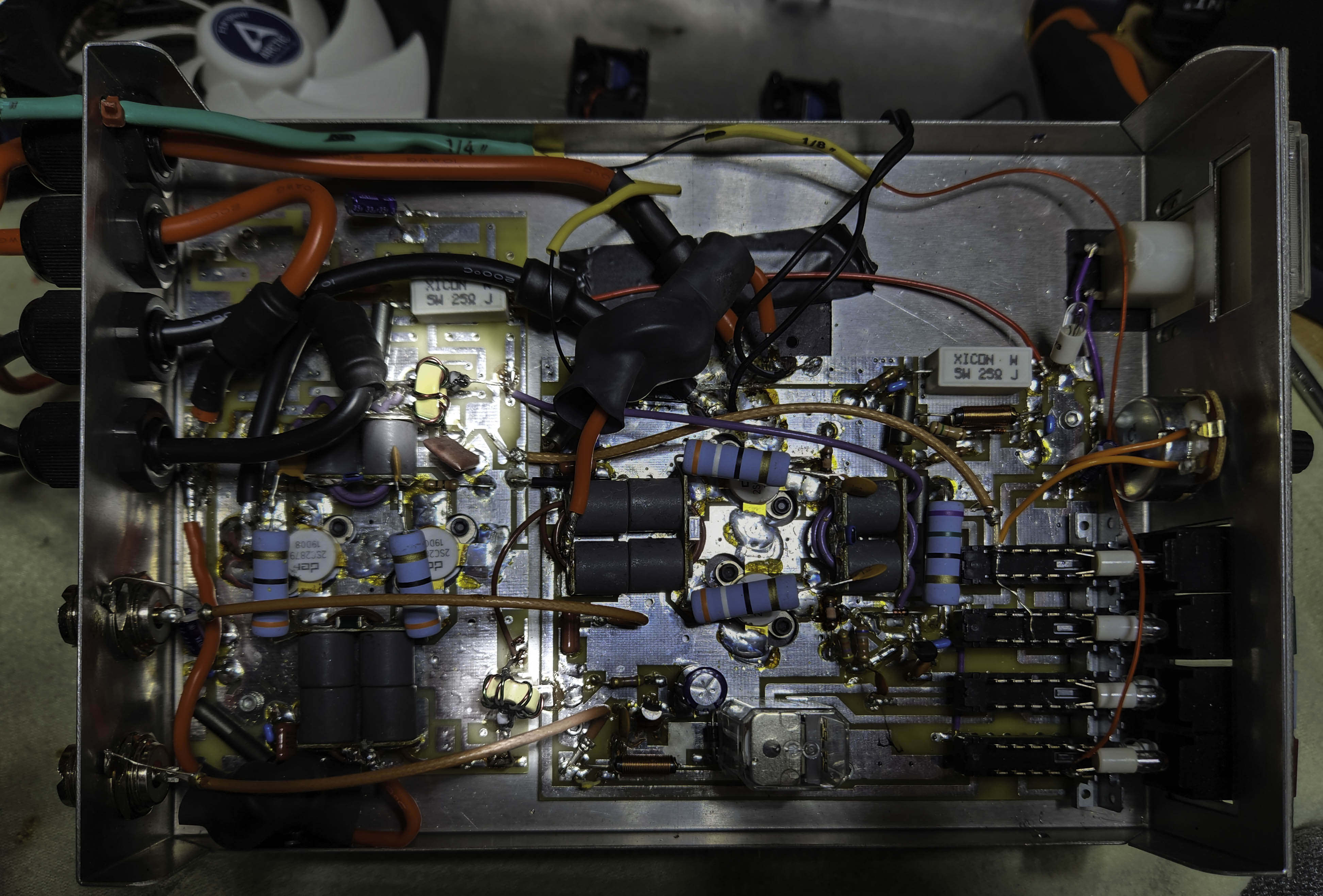

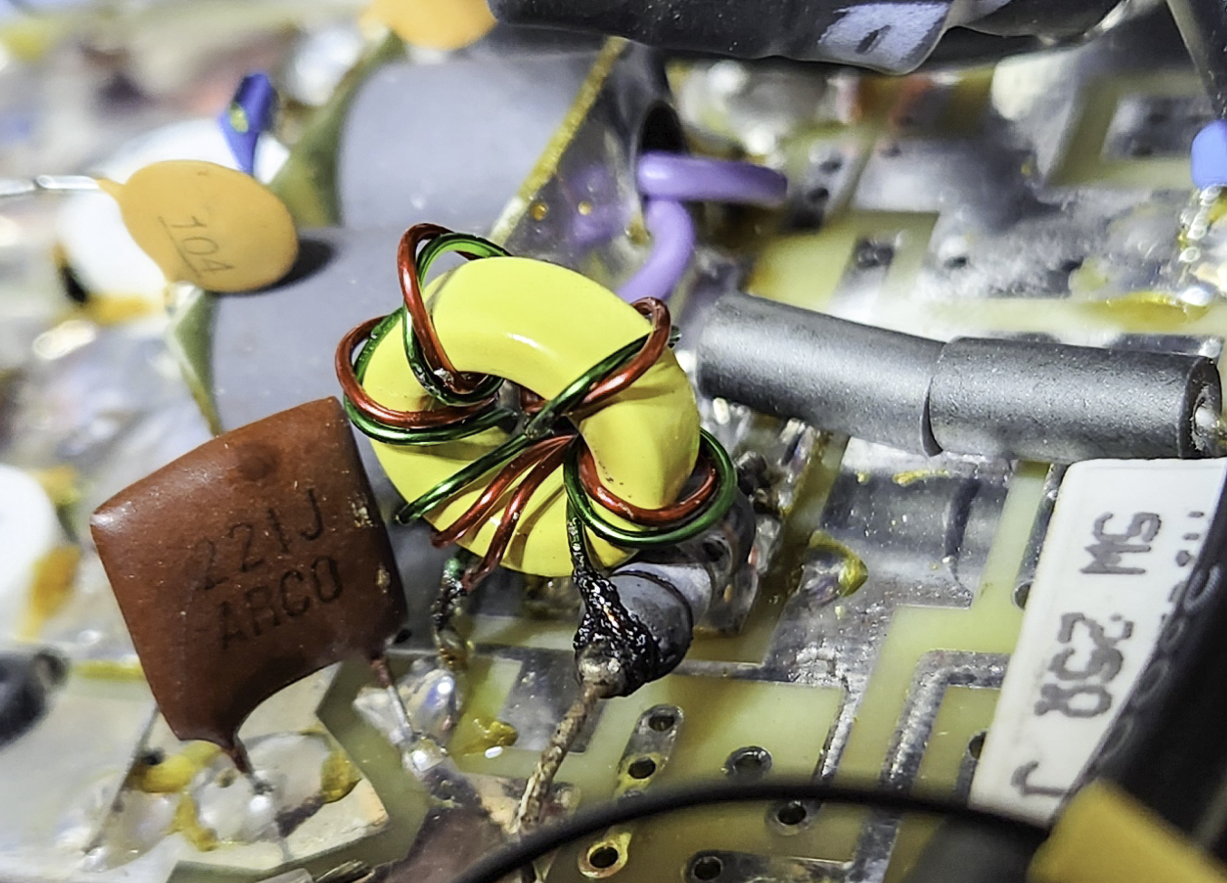

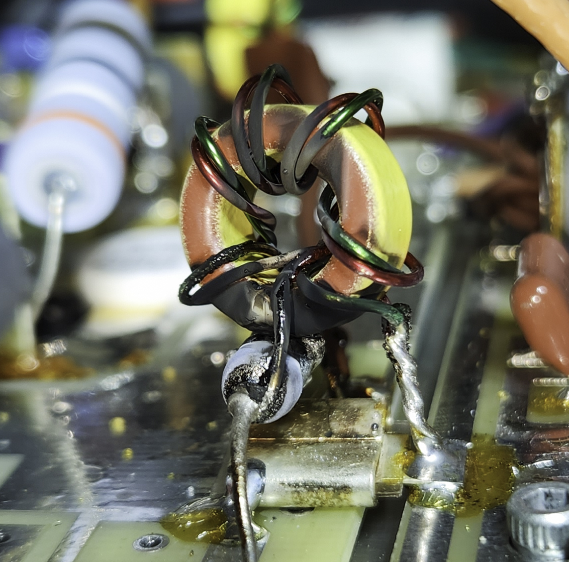

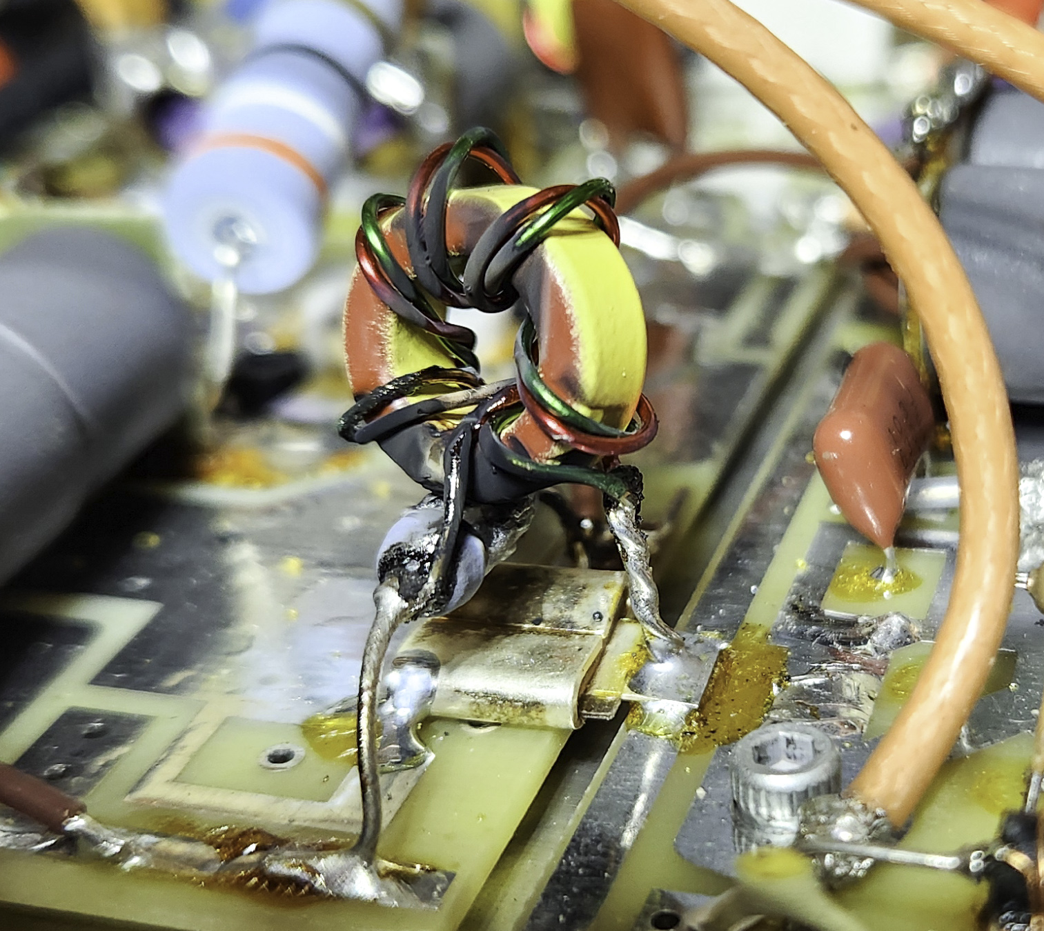

I think I pushed her just a bit too hard. Not sure, but she let out the magic smoke. Took out a couple of resistors and what I think may be chokes. (I'm not a tech) Anyhow, I need this repaired in a timely manner if someone can do it. Pics are below.

This looks to be a later model 500V Texas Star.......
The Texas Star amplifiers are not very complicated to work on...
Splitter and combiner failure definitely indicates a major failure.....
Minimum, its looks it will require a complete set (4) power transistors, new combiner, possibly new splitter.
Also 4 new 10 ohm bias resistors and the 1.8 ohm bias resistors......
A few capacitors will also need to be checked for proper value.......

Just from looking at the pictures the balancing resistor on the output combiner is smoked because the two 2879's on the front board let go, the 10 ohms are toast on those two.
That is what smokes the combiner.
