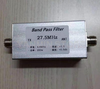

Anyone tried these 27.5m bpf filters on ebay?
Well anyway I ordered one off of aliexpress for less. It should be here this week. My first order from that site as a test. Hopefully this week's it comes in as it's supposed to and also work like it's supposed to as well.

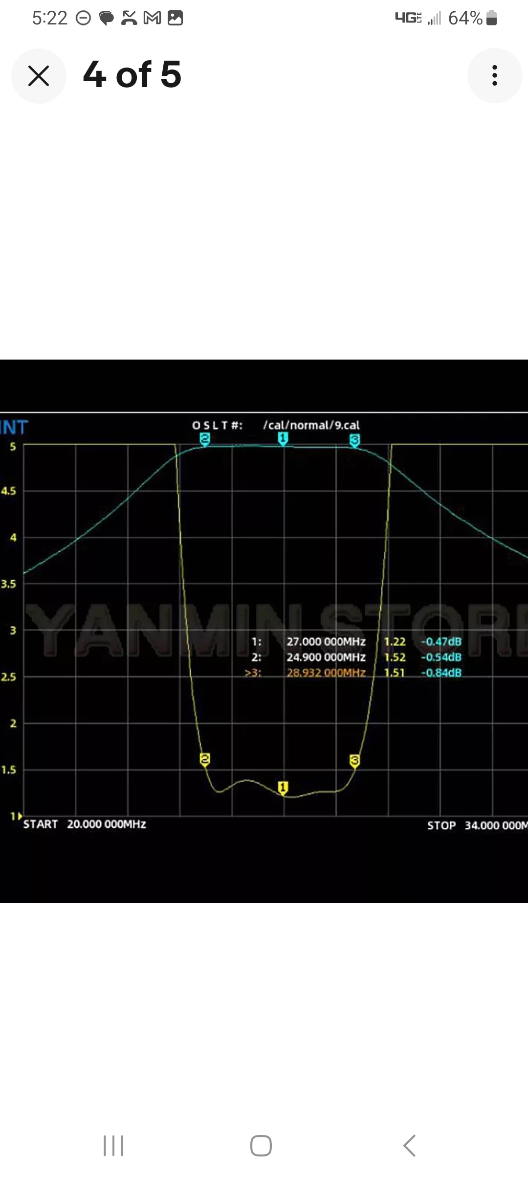

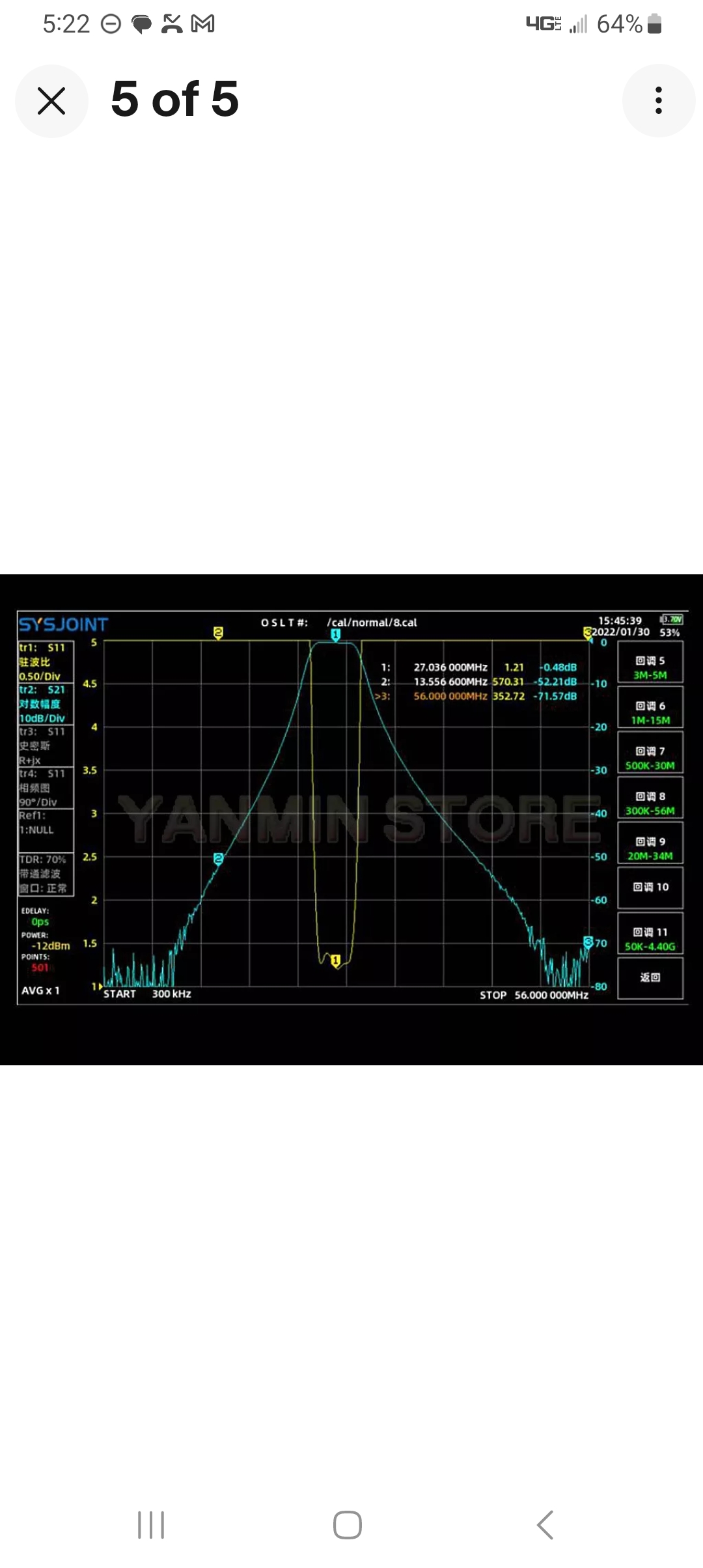

I'm not trying to use it as a noise filter circuit. I'm trying to block out radiated rf interference coming in from the antenna path before it gets to the transceiver.
Here's what they claim
