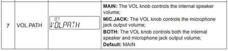

Note that PIN 2 "EXT.AF" is RX audio available on the front mic socket - this is selectable in the "VOL.PATH" menu.
This allows for a single cable connection to the radio for things like a full TX/RX headset, wireless/bluetooth accessory, or a data interface for digital modes (FT8, SSTV, VARA, etc)

The old lincoln II+ also has receive audio on the mic socket, no volume adjustment in the menu but it works with the uniden bearcat wireless mic.
