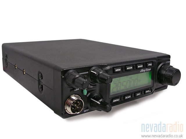

Here's a side profile - the best side to show what I'm going to suggest you try to work with in the vehicle or even when you're using it at home base or mobile under counter or on the dash...
Ok, see that mic connector? Got a radio like the size of a PC122 TRC465 or Eagle Sidewinder - you have an idea of the footprint - hold your radio to the screen until it's about that size - note the location of those knobs. Panel switches. Tuning dial and manual rotary encoder... Let alone the display...
Ok, next clue - try to operate all those functions while driving.
Anything less is just a memory...
Yes very true! The same thing is true of the Stryker Radio's deep menus but even worse the front pannel is covered with switches and buttons. The RCI 2950 is too large to fit in a modern car and not look trashy on the dash. It is too big to fit any place else were it can be seen with out taking your eye's off the road and the controls reached and operated easily with out having to look at the unit. Is the 2950 UGLY to look at? Yes Ugly as can be. Likewise the Origanal President Lincoln HR2510 great size and decent control but really needed to be back lit also UGLY as sin but easy to use and could be mounted in more locations. Fast-forward to today the AT-6666 and the like are fantastic size but the user interface and controls were designed by a moron! The Uniden PC-122 great size and controls are fine but not easily expanded for broad band free banding and single conversion unit and again ugly. What we need is a radio about the size of the old President Lincoln with just a few controls on the outside back light, 10-12m coverage that does away with all the stupid gimicky stuff and deep menu's. Build so that standard parts can be used to replace the switches and pots when they fail just old analog controls. Use rf rated transistors for the finals I do not care if they bipolar, fets, LDMOS just make sure they are rated for RF and can take a sever mis-match at all phase angles and have high beta gain at the voltage we have in a car or have boost transformers to get them where they need to be for gain! They have to improve recieve and get rid of all the noise!!! They have to fix sad pathetic audio bandwidth! They have to give us at least one digital mode for low power DX for both audio and data!
