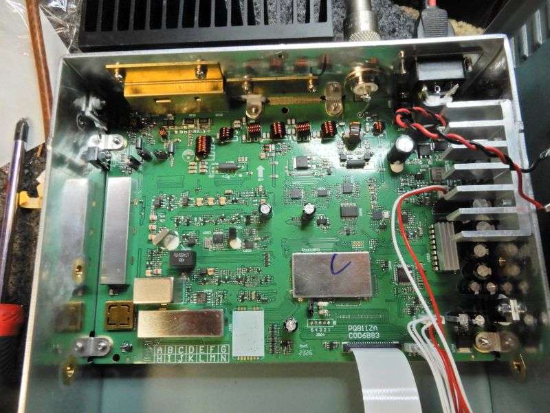

The Anytone 5555 radios (yes, there are more than one if you look at the inside) are built with the latest, greatest technology. Can't complain about performance until it breaks. The grain-of-sand size resistors look intimidating.
This one is comatose. The lights are on but nobody's home.
Meaning that the display and function buttons all appear to work normally, but there is no trace of this on the main pc board. No transmit, no receive.
No schematic, so not much info to base a diagnosis. Touching the "Manual Digital Analog Signal Injector" (finger laid alongside the shaft of a screwdriver) to the AM ceramic IF filter, and to the crystal SSB filter produces noise on the output sides of each. No audio from the receiver beyond that.
Can't find any trace of a local-oscillator signal. Likewise, sniffing for the IF-frequency carrier at 10.695,6925 and 6975 produces no trace of that signal being generated for SSB receive.
The front panel lights are on. And that's all.
No idea where to probe, or just what's under the metal shields. They are all soldered in place.

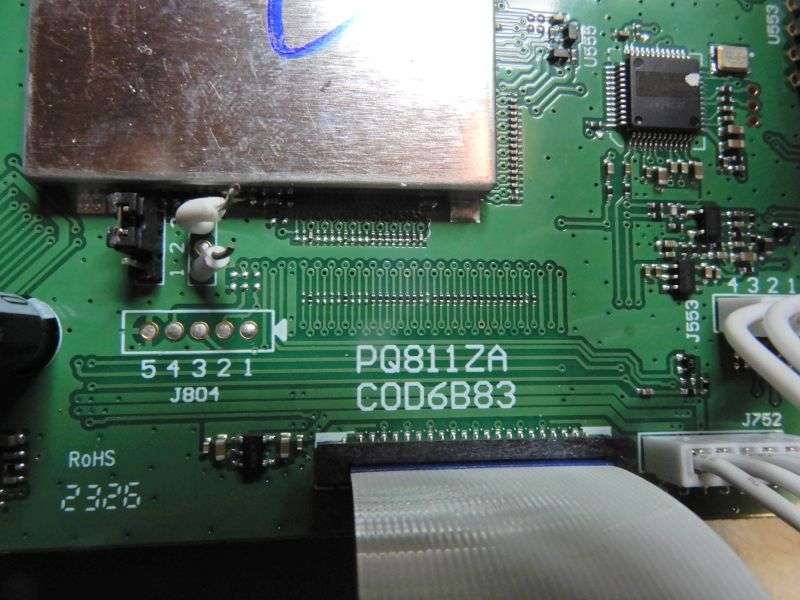

Here's the pc board number for this revision of the radio. If someone breaks into the right file cabinet in China and makes off with the tech data, please share.
Gonna give it back to the customer with my regrets, still broken.

Potentially VCO IC failure, or something around that area. If it was alive, you could easily sniff the oscillators (eg, 10.625, and also VFO Freq + 10.625) with a SA. I have not seen this failure on these before. Any chance it was zapped in a storm?

That pcb in the photos is clearly a 5555N2 pcb or the new pcb. Nomad called it a q5N but if it's the one pictured it's an n2. The first or original q5n is a very different board with vr's on the board.
Reactions: Rwb and Pez
it's an n2.
Yeah, wasn't quite specific enough. When these SMT radios get revised, it's as if the revision came from some totally different vendor. Almost no resemblance to a prior revision of the same model.
Thanks for the schematics, but without a parts-placement diagram the usefulness is limited. Not many callout markings on the board's screen print. Besides, I'm guessing the culprit is underneath one of those soldered-down metal shields.
Not gonna take any of those loose without a pic of what's under them.
Those shield covers are easy to lift off.

And without a road map to what's under them, what's the point? A schematic used to convey more meaning, when the component callout was screen-printed on the pc board, or at least a placement diagram could be had.
Without some sort of parts-placement info the schematic has limited usefulness.

If the VCO is dead, replace it. Take your chances, rather than shitcan a nice radio.
