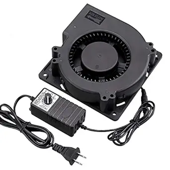

Bought a Wathai 120mmx32mm AC blower fan with variable speed fan controller. It's laying flat behind the radio, and it does not move around even at high speed. Been using the variable speed set to 12:00, and it keeps the radio good and cool.
Fan is $20.99 on Amazon. It's double ball. At full blast it's too loud for me. Blows enough air set at 12:00 to keep my radio cool. Fan link below.
www.amazon.com/dp/B08Q3Q2354?psc=1&ref=ppx_yo2ov_dt_b_product_details
