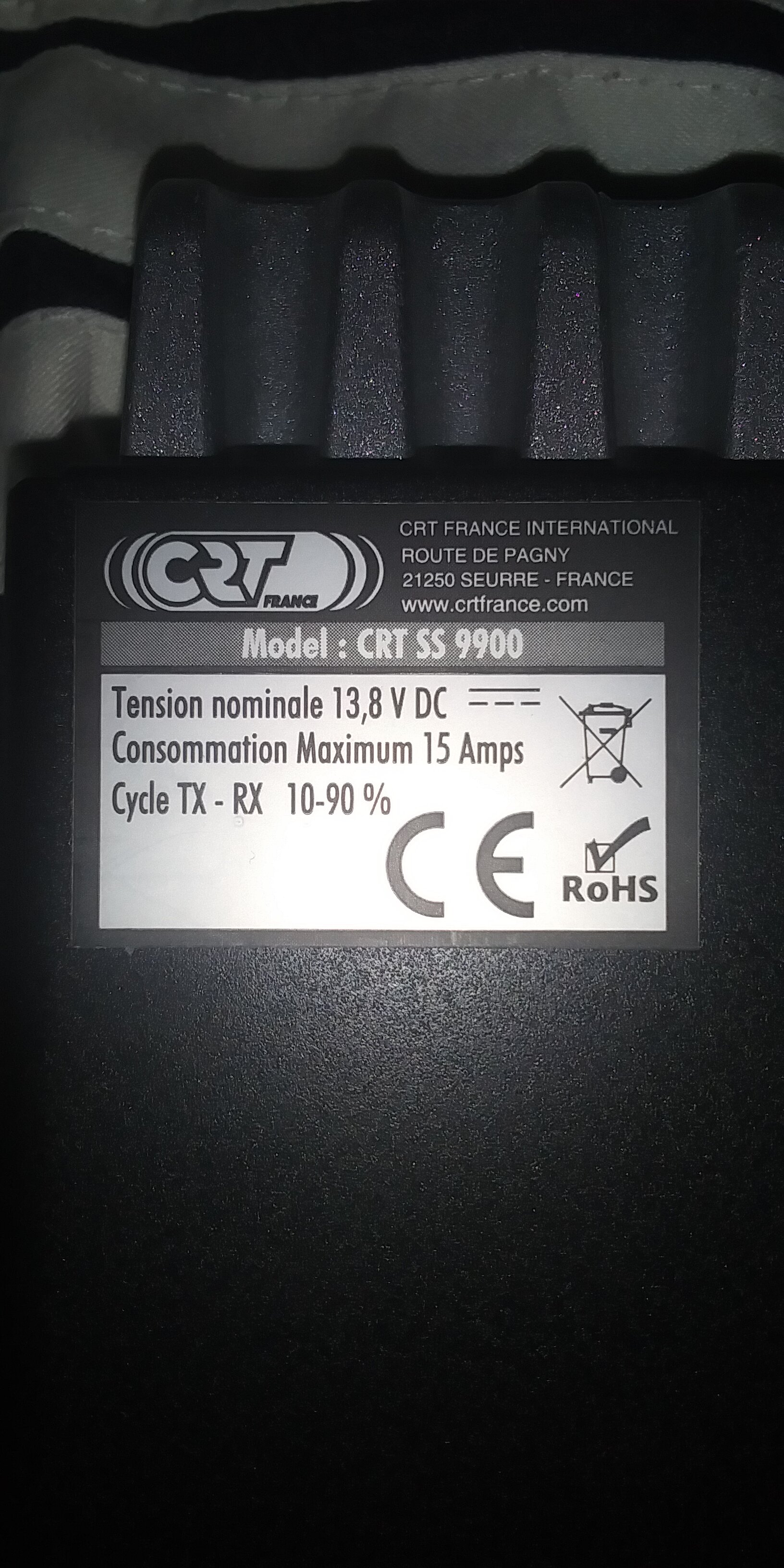

They run warm, the duty cycle is low on these radios, states right on the radio, 10% TX / 90% RX

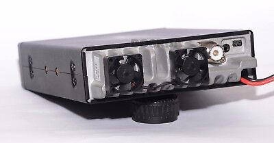

Rather that swap output devices just mount a small fan on the heatsink and call it good.

The builder knows, hence the duty cycle on the label.
If you run them at lower power that gets better.
