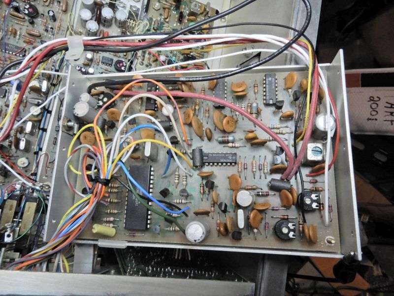

This ARF2001 radio (look it up) has a six-digit frequency display where the factory-stock clock would have been. This was an incredibly popular upgrade 40-plus years ago.
This radio was missing the top segment of all six digits. The industry standard name for that top segment is "a". Lower case "a".
So now that the counter module has been laboriously unbolted and exposed, what's wrong with this picture?

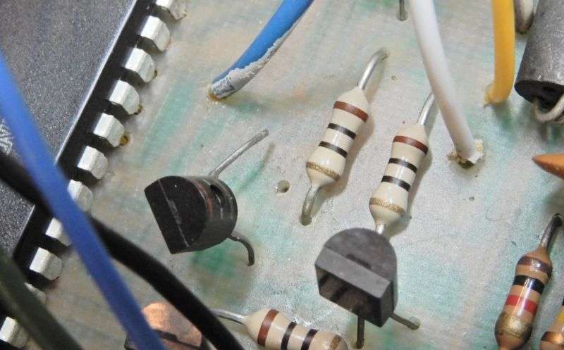

Okay, from this distance it's not so apparent. Here's what a closer look reveals.
Oddly enough, this transistor supplies current to the "a" segment of all six digits.
No trick to identify where it used to be before it got pulled out. Somehow.
Somehow.

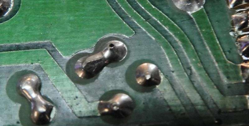

Soldering this lead back where it came from fixed the problem. All seven segments now light up on the counter display.

They may have noticed a "flicker" or change of brightness whiel the dispaly was active.
So in their research they may have been looking for the wire to the segment - not necessarily the cold solder or untinned lead of the driver transistor.
