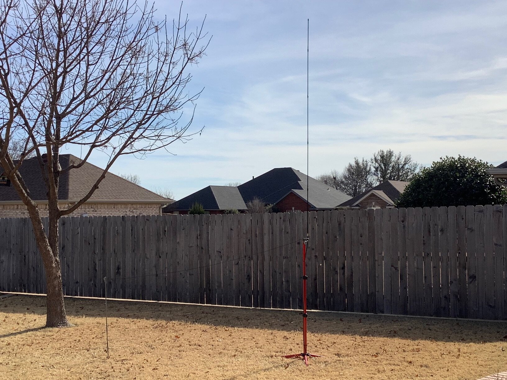

A quick update on the performance of the Buddistick 4.5' AGL with a single wire radial pointed northeast (from Texas). I knew I'd have no problem talking to the east coast and states in between and don't. However, the antenna seems to be much more omni-directional than I'd imagined it would be. Am easily making contacts in all directions. Most recently Canada, California and Bermuda.
Had a strong thunderstorm move through a couple of nights ago with winds to 60 mph. The lightweight shock-cord antenna didn't bend as much as I thought it would and was a real trooper, standing straight at attention the next morning. :)

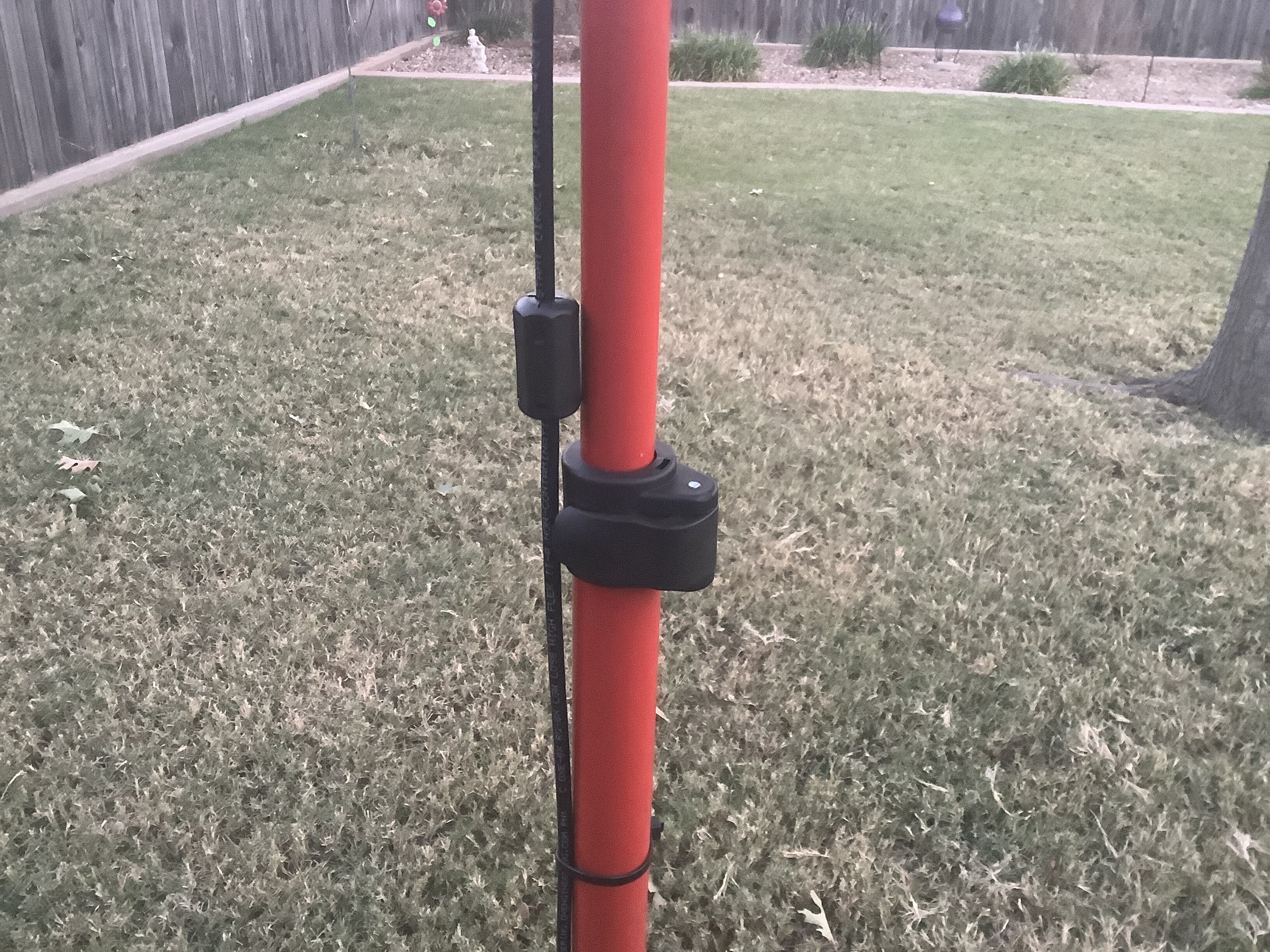

When I installed this antenna, I noticed a little CMC in the shack. Not much, but the SWR jumped around a little bit when using my analyzer. I expected this using the single radial.
Today I decided to add some Palomar snap-on ferrite beads (#31) to remedy this. Added five and the SWR became rock solid but went up to:
1.67 @ 14.150
1.48 @ 14.250
1.62 @ 14.350
Removed one bead and saw improvement. Long story short, I am now using a single bead (photo attached). SWR is now:
1.14 @ 14.150
1.06 @ 14.250
1.14 @ 14.350

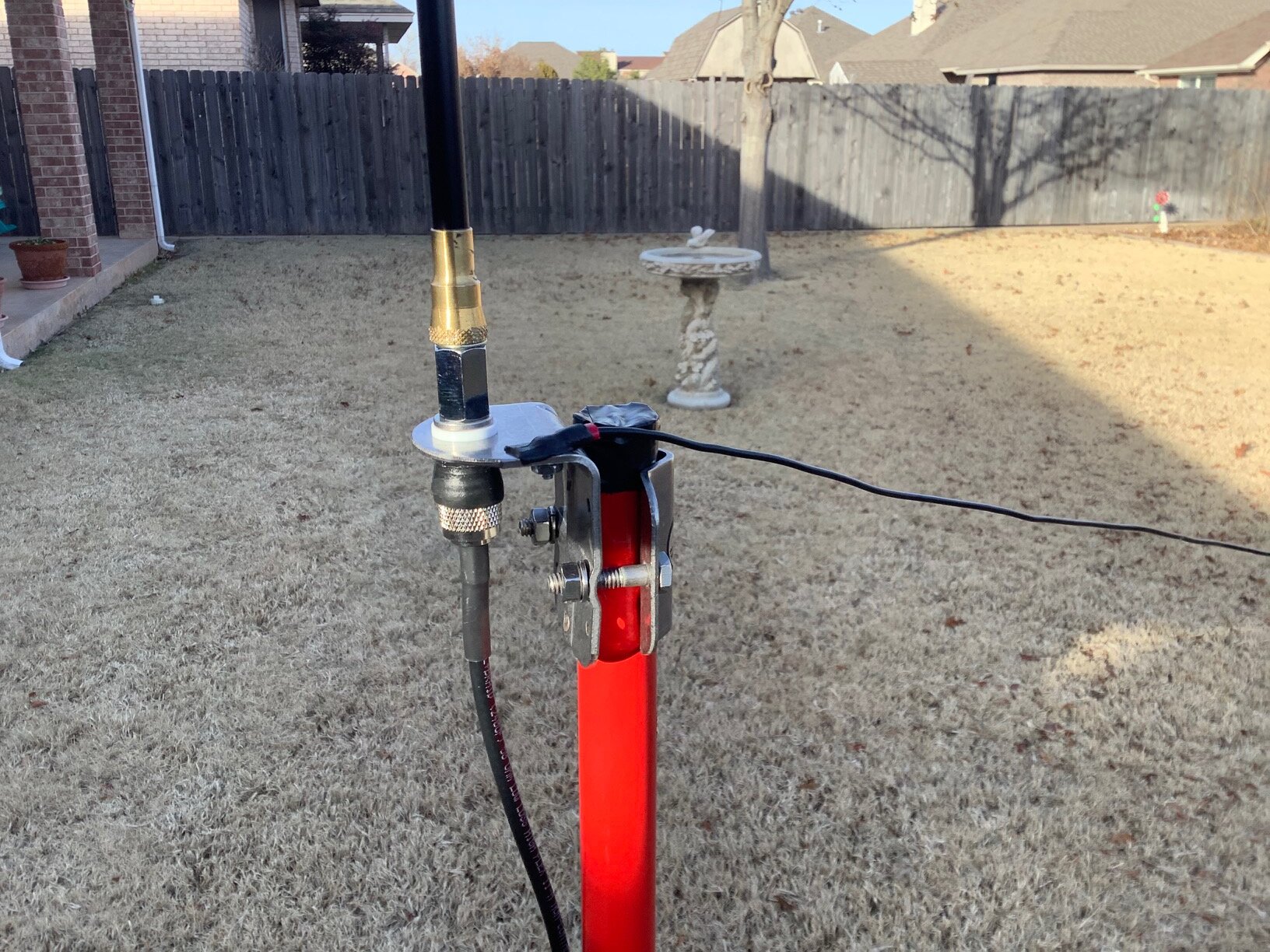

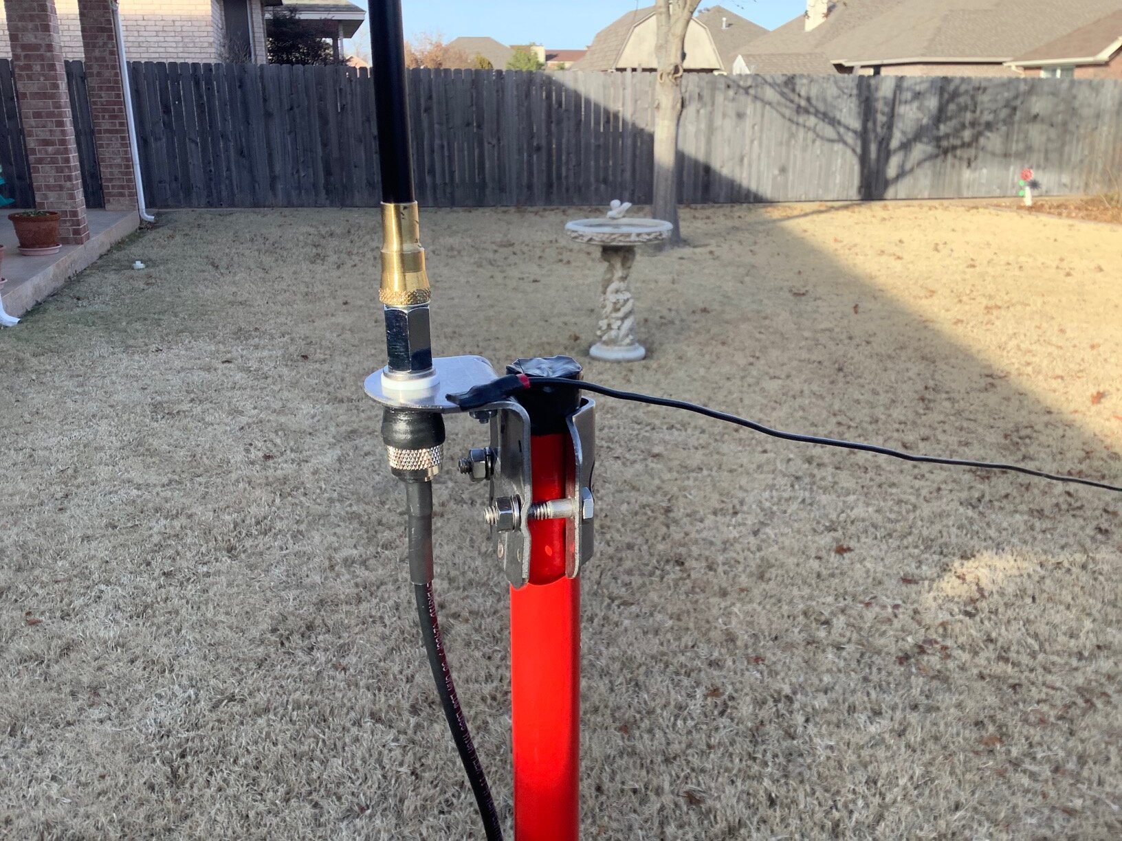

Well, the mini coil and Dixie cup (See Post #14) are no more. :whistle: The cup was a hassle when changing bands, and the SWR changed dramatically without it in wet weather (or sprinklers). So . . . away they went. Trimmed the antenna to 99", adjusted the single wire radial length for lowest SWR (1.03 @ 28.400 mhz) and dove into 10 meters. The band in not real busy, but have made contacts daily. First three were to Spain, Costa Rica and Canada.
Antenna is omni-directional. Not influenced by precipitation or temperature changes like an open coil, and is very quiet.
