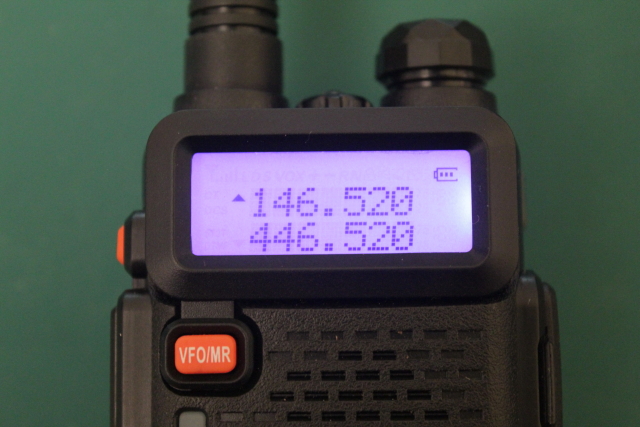

The new Baofeng UV-5r dual band 4 watt VHF/UHF handheld transceiver has arrived! When I saw that this radio was coming out, I knew that I wanted to get one for comparison to its little brother, the UV-3r. I ordered it from 409shop.com for $56 shipped and it arrived yesterday.
Here is a picture of the new UV-5r:
First, here are the key specs:
Frequency Range: 136-174.995 Mhz / 400-479.995 Mhz TX/RX

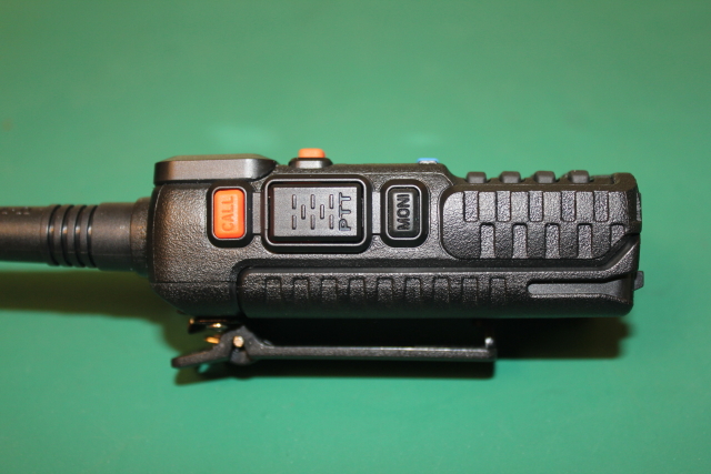

The left side has the typical PTT, "CALL", and "MONI" buttons:

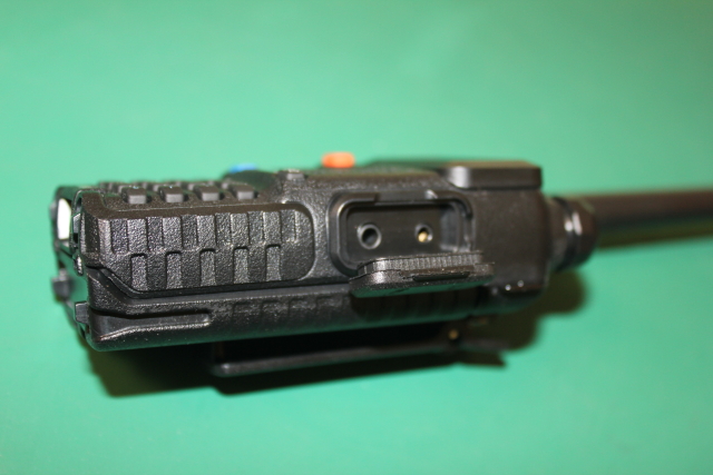

The right side has the speaker and mic plugs, shown open here:

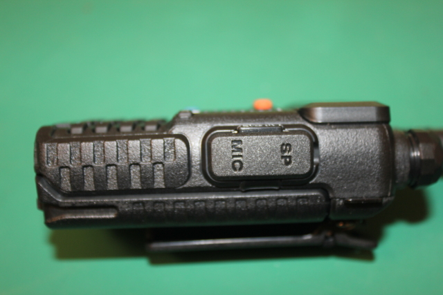

One noticeable difference with this radio is the cover for the speaker/mic is well designed to keep dust and moisture out. This is how it looks with the the cover closed:
This radio uses the same speaker/mic configuration found in the Wouxun and Kenwood radios, which also means that the programming cable supplied with the other radios will work, as well. I have tested and verified programming the UV-5r with a Wouxun cable.

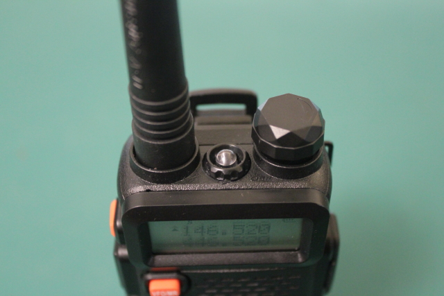

The top of the radio is where you find the flashlight and On/Off/Volume knob:

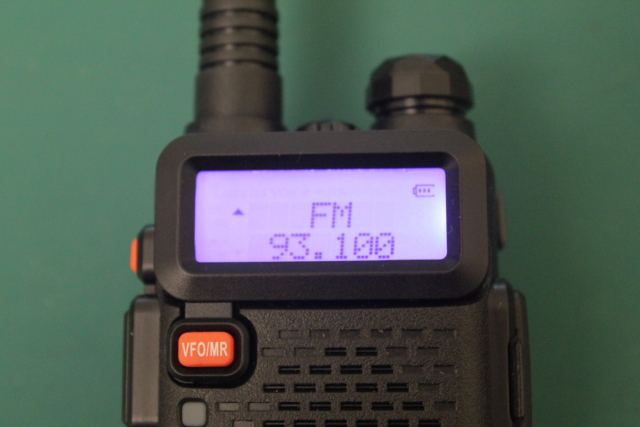

Here is the display with the FM broadcast radio on:
You can tell from this pic that I've enabled the standby purple back light. The light turns off after a few minutes of inactivity.
The flashlight is pretty bright:

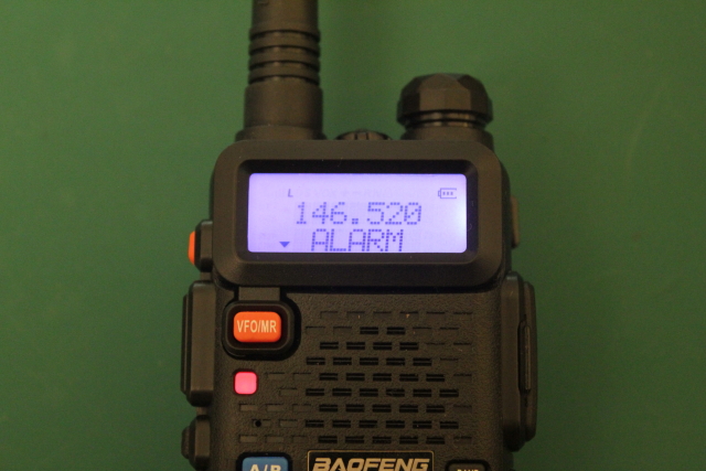

And of course, the radio wouldn't be complete without the included alarm, shown transmitting here:
