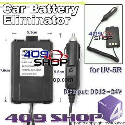

Been using this radio for close to two months - daily. Still works fine. Considering getting a spare battery and the 12v cigarette lighter plug power pack - now that I know this radio is still working OK.
Just remove the battery and snap this power supply on to the radio and plug it in the vehicle's cigarette lighter plug. You probably will get a bit more power output from the radio using this. Didn't even know they made this 12v supply for the UV-5R until now. It's around $17/shipped from the 409shop BTW. I'll report back when it gets here.
1pc x Car Battery Eliminator for BAOFENG UV-5R WACCOM UV-5R - 409Shopwww.409shop.com
