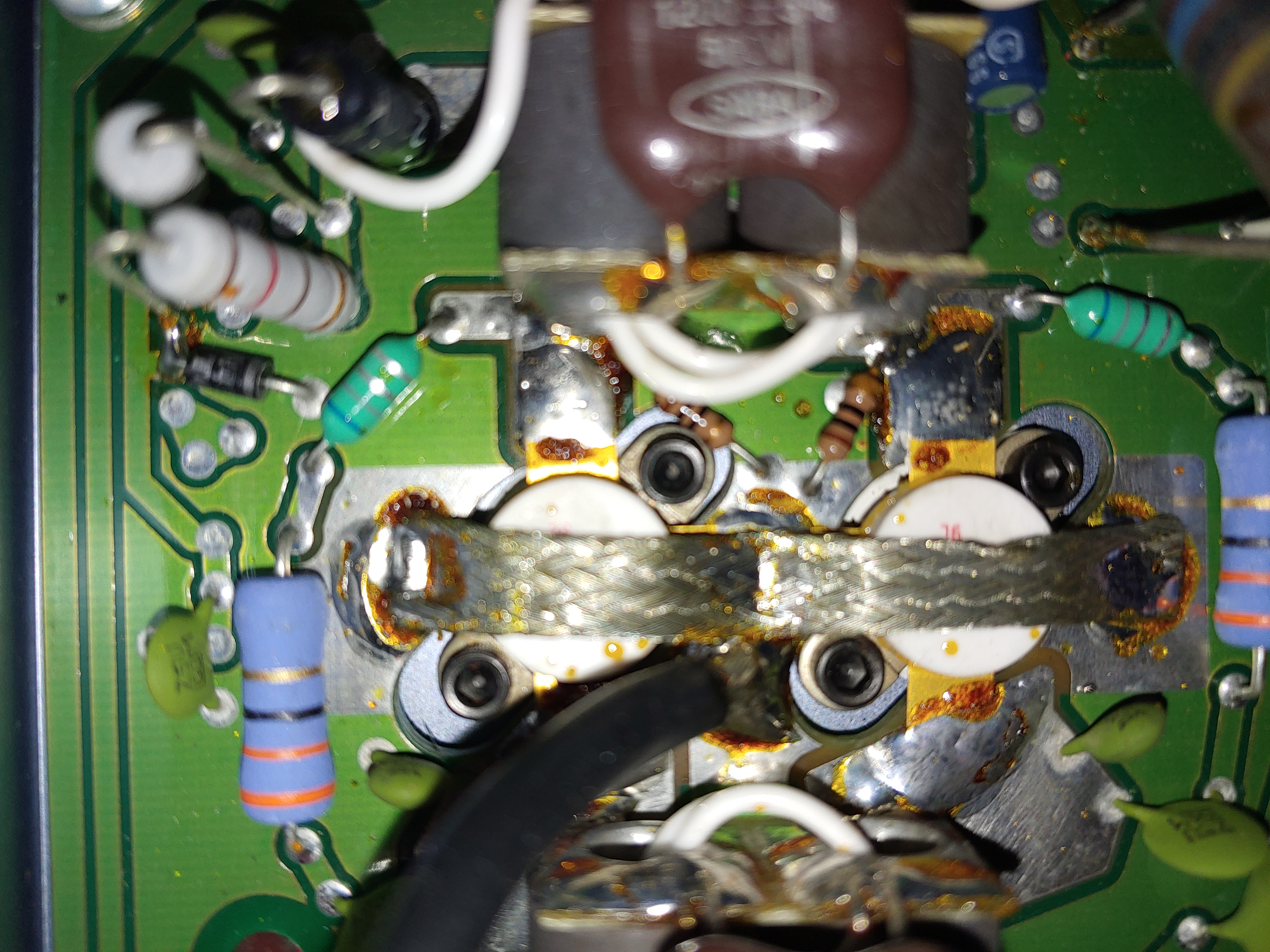

Do you remember the little mirror boards he was putting across the emitters of the pills to keep the input and output transformers from "talking.".
Just on this one point....
Actually, I would rather see a copper strip stood vertical in between the input and output transformers than solder a copper braid across the transistors.
You will see this on some of the early Grey amps.
I have seen a Boo amp that had shield covers over the input/output transformers.
I have a picture of it somewhere on the hard drive.

I agree with that. I could never get the braid to not look sloppy. I had a Cobra XL350 with the braid and it was the nicest looking one I've saw.
I don't believe it's necessary with the copper boards everyone uses. Years ago CCM said something about it being done on printed boards to make sure the emitters were at the same potential.
Boo learned like we all did. I've done plenty of things that didn't make sense.

Braid. Cobra 350 XL
