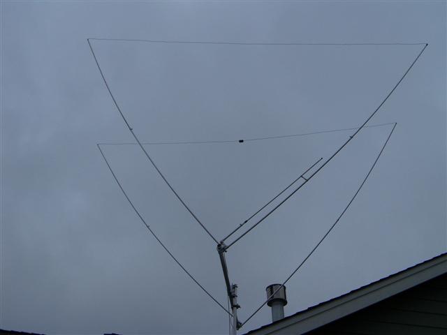

The key to doing the build at low cost is to farm your materials from alternate sources. I have used walkers purchased from thrift stores for the 4 corners as well as the framework for some of the tubing. Aluminum crutches from thrift stores provide parts of the elements. Old aluminum frame fold up cots give up sturdy tubing and well formed corners. PVC makes great rigid spacers and insulators. Stainless screws are easily gotten from DIY stores, or a local hardware shop.
Materials and beam.
