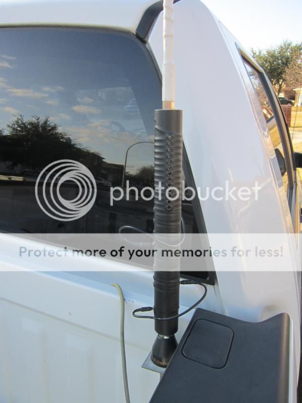

Hi Moleculo, and Merry Christmas! Only a day late. :) I've been real busy this past week getting ready for Christmas, so I haven't had any time to mess around with the coil. Thanks for the tip on the pre made one! I'm supposed to use a 1" form and go 10 wraps around it for 40 meters. Hopefully will do that tomorrow and see how it looks on the analyzer. Here's a pic of the coil installed on my truck:
73,
Brett
