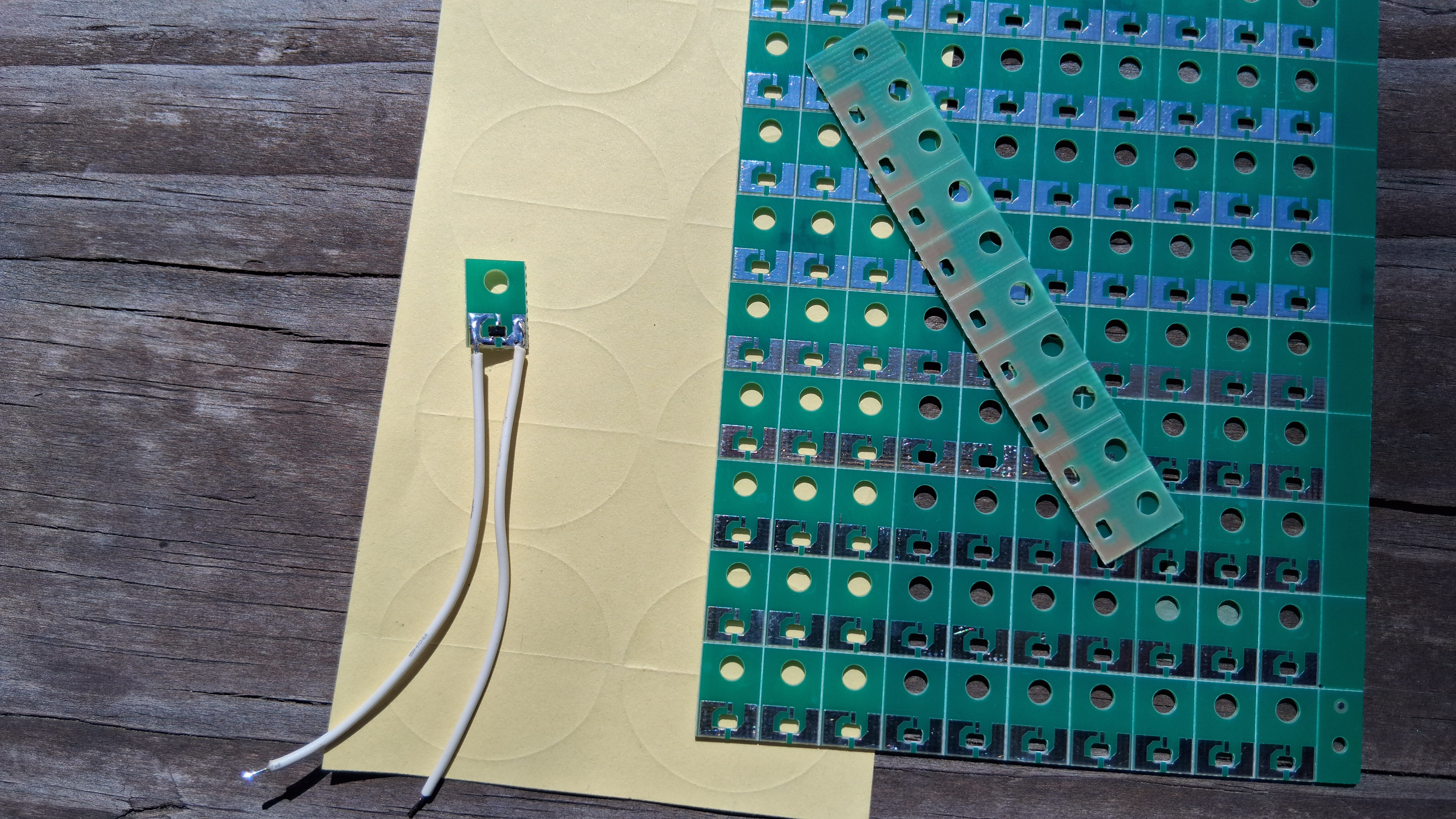

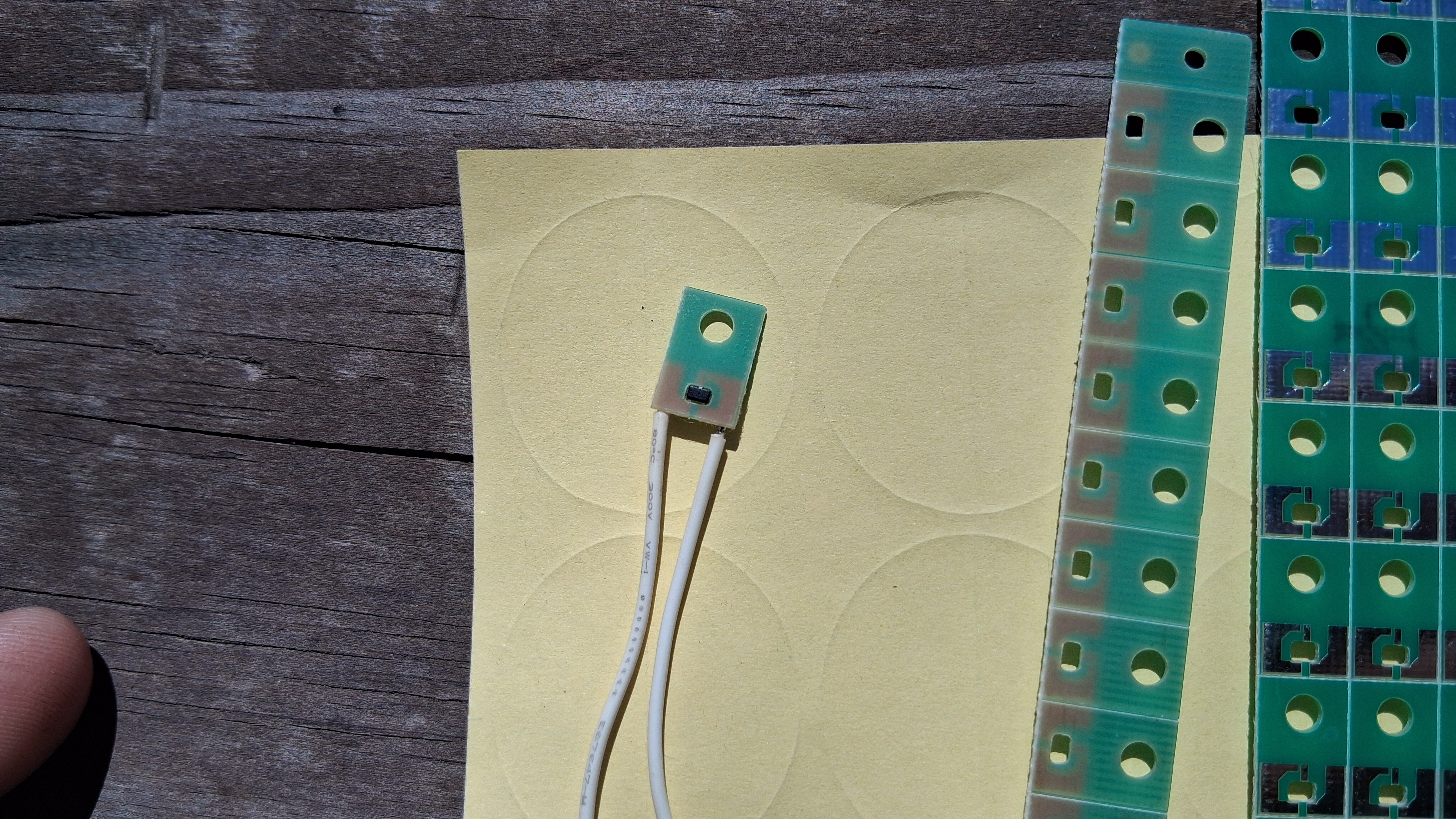

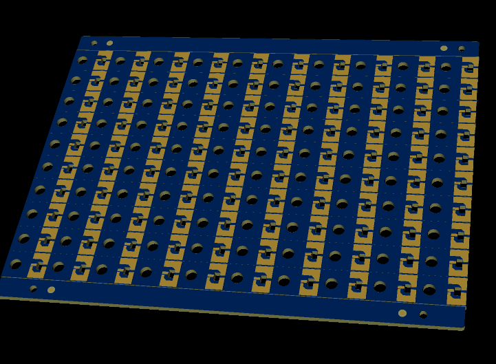

My last post about this got quickly deleted when china emailed me stating they would have to charge me more for my parts. Apparently 12x8mm is too small for them and making them individual pieces was a bad idea. I tried to redo the parts using panelization, and probably screwed it up, but we will see.
They emailed me this time as well stating the V cuts would be difficult and that they needed more money for this version too, but at least it was not as expensive as my last attempt. If I run into problems again, I will have to hire someone that knows what they are doing to make me a gerber file. Hopefully then snap apart cleanly.

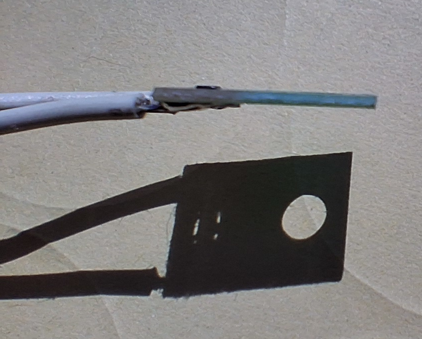

I ran this idea past chatgpt and it suggested the diode be slightly proud ( slightly past the surface of the board) to ensure the diode body presses against the heat sync and that I should use minimal solder to limit thermal mass so it tracks faster. As for how far the diode sticks out past the board, we decided on the thickness of a paper grocery bag.
I didn't even think of those two things so I am very happy I decided to sanity check the plan.
I don't know how thick the copper is that they are putting on the board, but I had the cheapest option selected. 1 ounce. Not sure if thats finished or just the base layer, but I suspect it will be around 35um thick.
I also went with 0.8mm thickness boards rather than 1.6mm so the diode legs do not go into the cutout. I figured that problem out while trying to put one of my surface mount 4148's in a thicker board I cut last weekend. The diode legs got lost in the hole and soldering them required bridging the gap. That shouldn't be an issue with the thinner boards.

Now I am regretting not getting the 4-diode version with 6 legs. I could have used them the same way, and they would have had more surface area for the heat sync.
If I ever burn through the 500 pieces I ordered, I will increase the hole size in the board and get the bigger diode arrays.
Rock on! Those look excellent! Gotta master the art of the v-cut. Looks easier than my sheet-metal shear.
Thanks!
In easyEDA, if you want to make many copies of one part on a big board, get one piece's layers finished, select everything, then go to tools>panellize and in there it will let you pick V-cut or stamp hole (or both) along with how many rows and columns (quantity).
