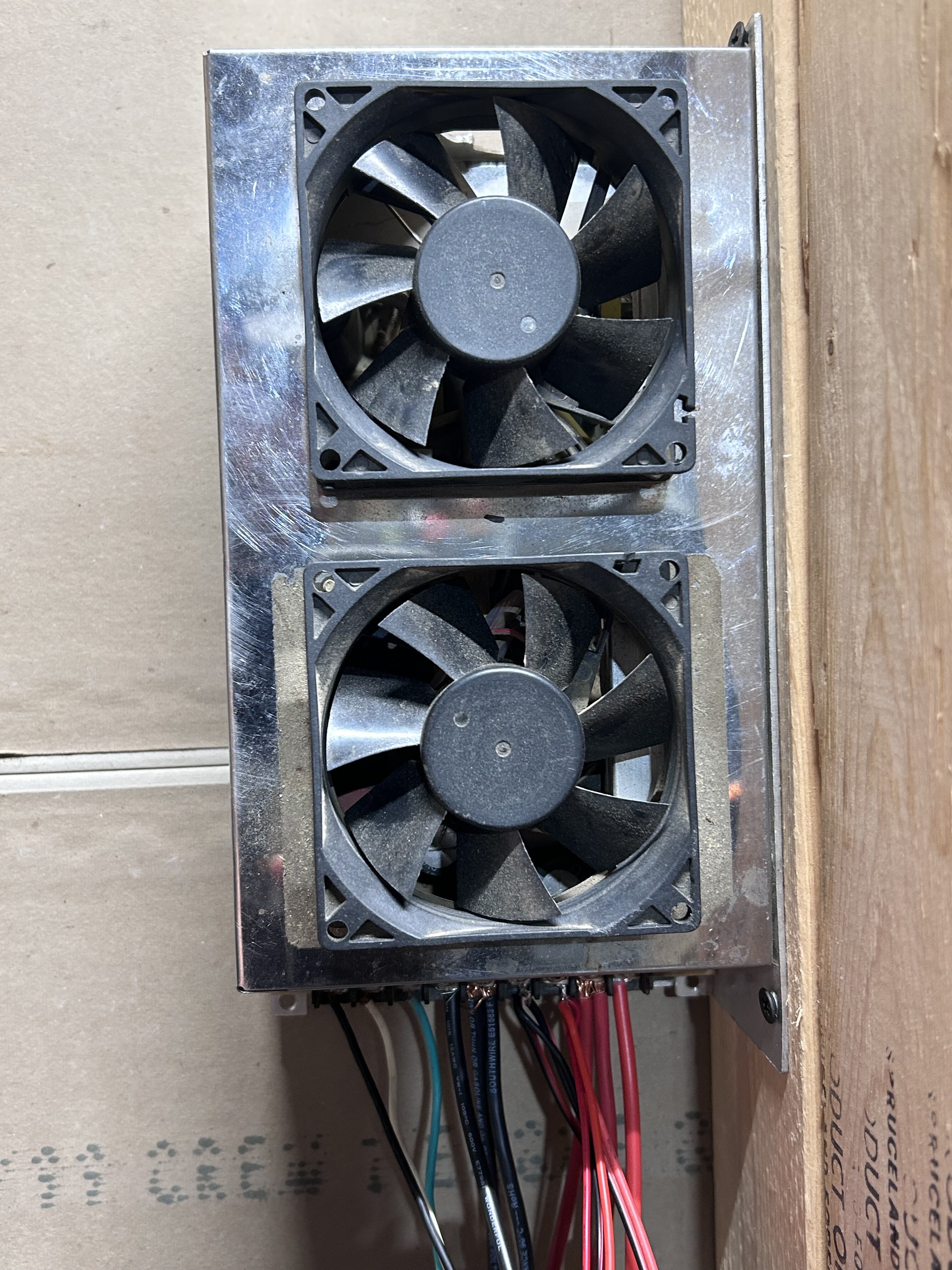

I use a megawatt but the fan was too loud. Added 2 24v fans from the junk pile and it is silent and never given any trouble. It is kinda ugly though.

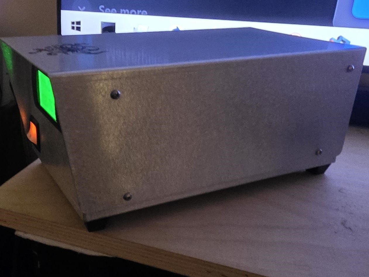

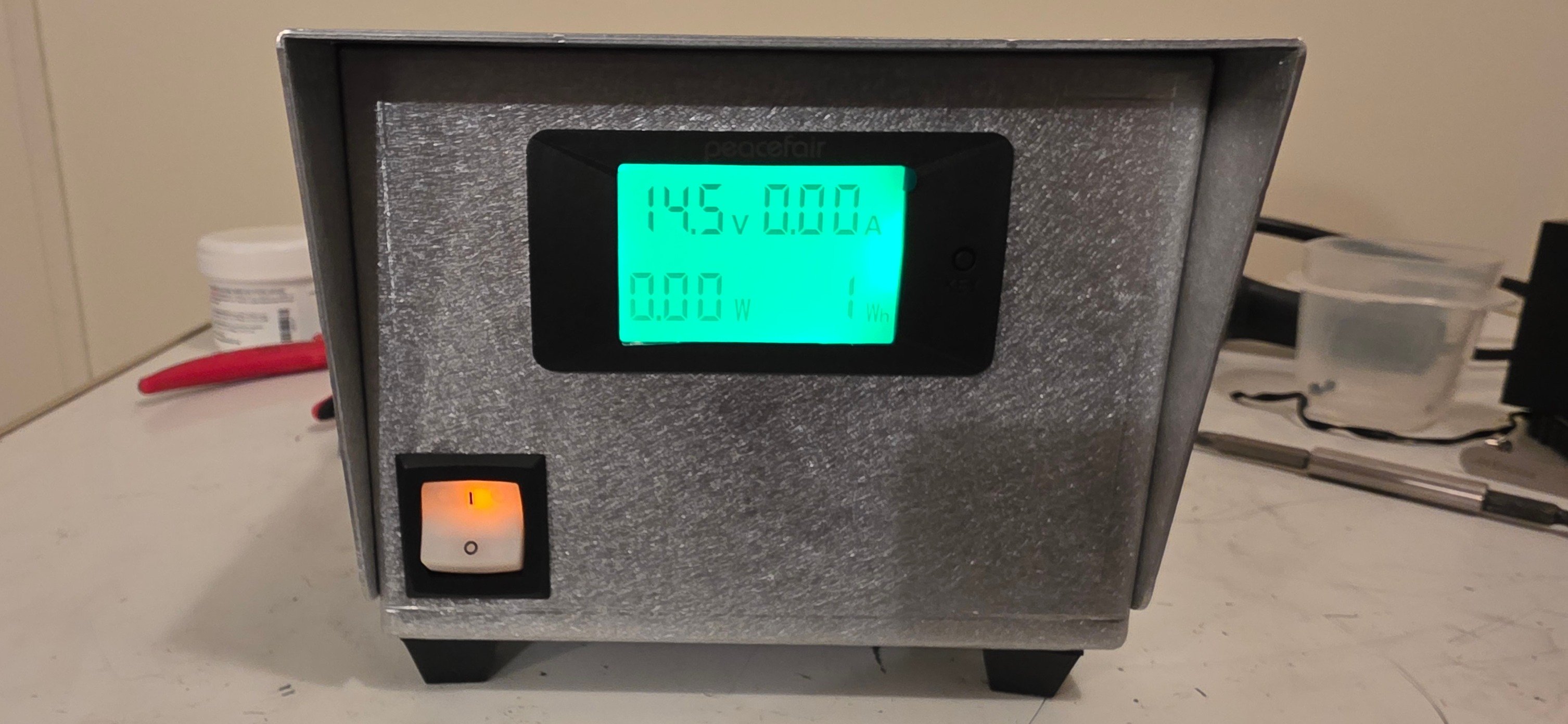

I built two of these HP150/200A server supplies about a year ago.
No issues whatsoever.
Load tested with a carbon pile tester. 14.5 VDC 150A @ 120V 200A @ 240V.
Fans are whisper quiet unless you put a heavy load on them...then they spin up a bit and sound like a jet...lol
