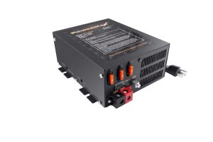

I have a couple of the Powermax 100A supplies, really clean and adjustable voltage. Can power your RV, charge your batteries and run your radios/ amps.

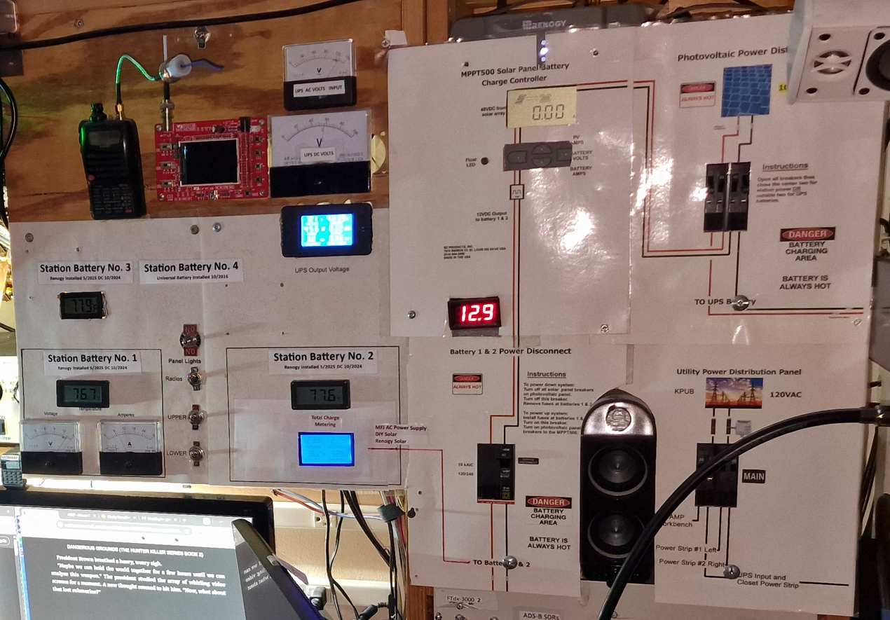

Has anyone incorporated an AMP and Voltage meter with one of the previously mentioned supplies?
Just curious.
I have a mimic panel with metering on my old UPS and 12DC systems. The digital meters are relatively new, MORNING GROUP PZEM-022 for the AC and Bayite PZEM-051 for the DC side. The temperature probes are glued onto the battery cases.
