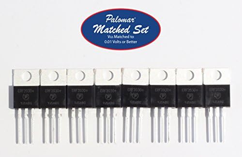

FPQ13N10's aren't exactly known for reliability. Time to upgrade. Couldn't hurt to have some beta matched spares.
Reactions: Rwb
